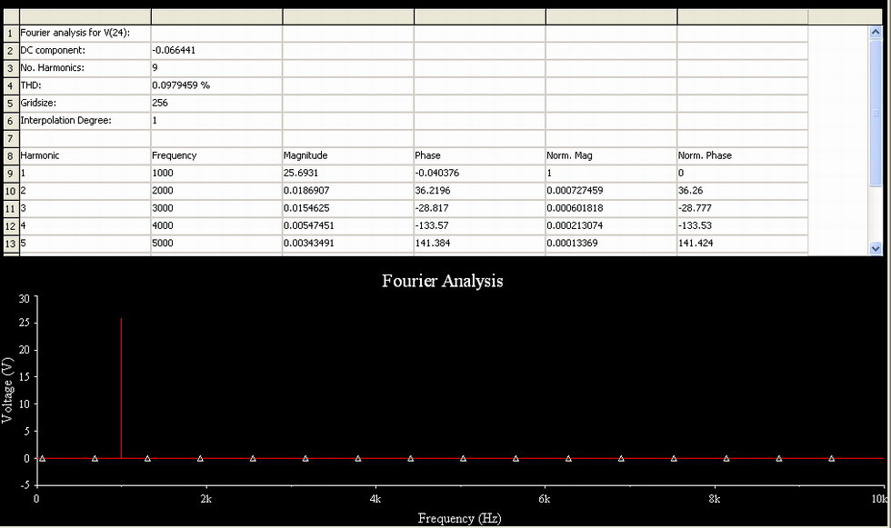

By the first time i felt curious to see the Dx Standard into fourier and
THD distortion analisis too.
Because the new one.... i want to know what is the difference in numbers to listen and understand what this means.... and if this means something to our ears...... in my experience, low numbers does not means audio quality...not always.

By DX - I have simulated the Ostripper frugalamp.... even thinking the non use of bootstrapp is not a good thing for sound
Don't give up on bootstraps, they can be VERY good. I simulated
your DX standard.. got same .1% ..BUT you change slow TIP 41/2
to better 2sc japanese devices you get .03/4%.
Put a current source instead of a zener for input and you have
a AKSA amp (which sounds very good). My kids have
the little bootstrap (below) which still runs after a year.
That frugal 2T you simmed is not like the doug self amp or
a bootstrap (no VAS current source or bootstrap source)
and has a different sound than than either. the 2 sides of
the input (LPT) are in perfect balance and waves are
same from input to output BEFORE feedback . so you need
just a small amount of NFB to "fix" it ,resulting in crazy
.000368% dist. even at 20khz.
BUT , in the end , when you have them built ...side by side,
the only difference you will hear is just a little clearer highs
and better sound stage (like symasym)and only with very good speakers.

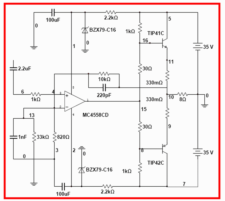

Boys, my chip input power amplifier is already buried deep into the grave
I found the price into local shops too much high for operational amplifier... the TL071/081 for instance..costing almost 4 US dollares..... this chip will substitute the diferential amplifier and the voltage amplifier only, and will use an extra zener diode...so... this increases the cost...no sense..not a good idea.
I can use others, but worse ones alike 4558...not a good idea.
Will not continue with that chip input idea.... will try to reduce distortion into the Standard...will manage to do that, and to try other ideas to the circuit and also to try to recalculate it to full class A, just to see the results into the simulator.... beeing good into the simulator then i will assemble to listen.
The idea is to provide my Orkut group of friends something cheap and better...this way may be better but will not be cheap.
regards,
Carlos

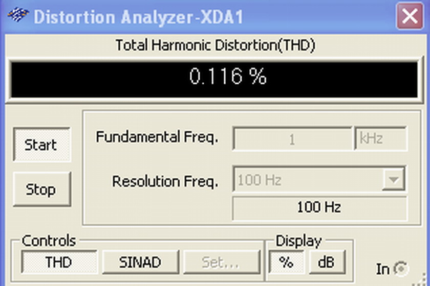

Well, they have asked me to use the old 4558
Well... it is not a very good chip...but cost is lower than a US Dollar here (80 cents).
This was not tested...simulated only..... 0.001% total harmonic distortion (THD) and 10 watts RMS.... the good idea is to use the 35 volts supply they have.
Just simple... a test only guys.
If you decide to build it...do it under your own risk.
Nothing is guaranteed...i have not assembled and i have doubts that small distortion can result in something special in sonics.
Of course you can install the best op amp you may find..those ones that can accept 22 volts supply.... also high speed transistors, better units...of course...it is up to you.

There is no point in the 35V supplies, as the opamp wont be able to make the outputs swing much higher than about 12V.
The usual way to solve this is to give the output stage gain, with a CFP pair.
It's a good simple circuit though, used often for headphones, usually with 1N4148 diodes instead of the 30 ohm resistors

The idea Jaycee, was to make it very simple with low parts count, as an exercise to Orkut friends that finally have learned how to design...just an exercise...a homework for them.
The idea is not to achieve the biggest possible power.... the chip output voltage is fine and can be even smaller than that.... also to show them that we do not need all that power.
I will not tweak the schematic.... it has a purpose...i have just published to satisfy fellows curiosity...it is not there to further developments.
Distortion is 0.001% into maximum unclipped power.... this was the main target...to be super simple and super cheap and hyper fast to assemble too.
I give up to make it a Dx Amplifier, some better idea..because i have discovered (really the first time i have measured into the simulator) the Dx Amplifier is already excelent into measurements too...the distortion is bellow human perception...i just cannot perceive bellow 0.2%...so... everything smaller than that, seems to me overkill and non sense to my own ears...i do not need that...as i cannot perceive the advantage....not really needed to waste my time with that search for smaller numbers, or higher numbers for power and efficiency.
Also, was made to show my Orkut friends, that distortion numbers does not means, always , good performance in sonic reproduction.
The study related WHAT kind of distortion may be the next step... the one bother us more or less...and i will produce schematic as example to Orkut folks to build...so... they will not need to believe me, they will have only to believe into their own ears... to accept their own perception and producing comparisons to produce conclusions.
I will not develop this schematic...also will not use it as a new Dx amplifier.... will serve those simple purposes only.

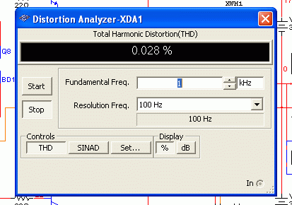

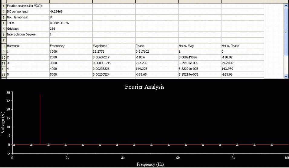

If you want the Multisim 10 files about the Dx Amplifier simulation... the optimized
version were the total harmonic distortion is 0.025% into full power (unclipped = 50 watts RMS in 8 ohms), frequency is 1 Kilohertz.
Normal version is around 0.1% into this same measurement setup.
Some capacitors, resistances and small adjustments were made.
I do not think this may represent some audible difference, as we cannot perceive bellow 0.2% (i cannot)....so.... this is only academic and may be interesting to the ones believe in such kind of testings and numbers.
Just write to me and i will send you the Multisim 10 files.... so you just drag and drop into you multisim and click into the instruments to see what happens.
New optimized amplifier, now has 3 db losses of power into 10 hertz....and goes to 200 kilohertz without distort the sinusoidal wave entering.
The most interesting is .... when you install emitter resistances into the power transistors, the distortion increases a lot...this is interesting, as i have perceive better audio quality without those resistances and now the simulator confirms those resistances are annoying, and also the output inductor is a problem too.
