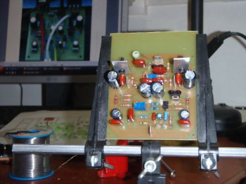

One more have constructed the Dx Amplifier.
Those folks are from a group of friends joined into Orkut... all brazilian good friends are there building Dx Amplifier, and supplies and studying amplifier design, and producing comparison testing.
My Orkut had 300 people... i have made a cleaning related folks not well prepared or the ones not addicted to transistors.... this was made to reduce the group and allow me to teach them to create amplifiers and how to produce A to B testing.
Now a days, the group has 30 folks...of course the removed ones are not very happy.
Inside my Orkut the thing works alike school class..there are homework and once each time is the teacher..so...people must be leveled in know how..to be able to teach things too.
Here, into the pic, one more Dx Amplifier.
regards,
Carlos

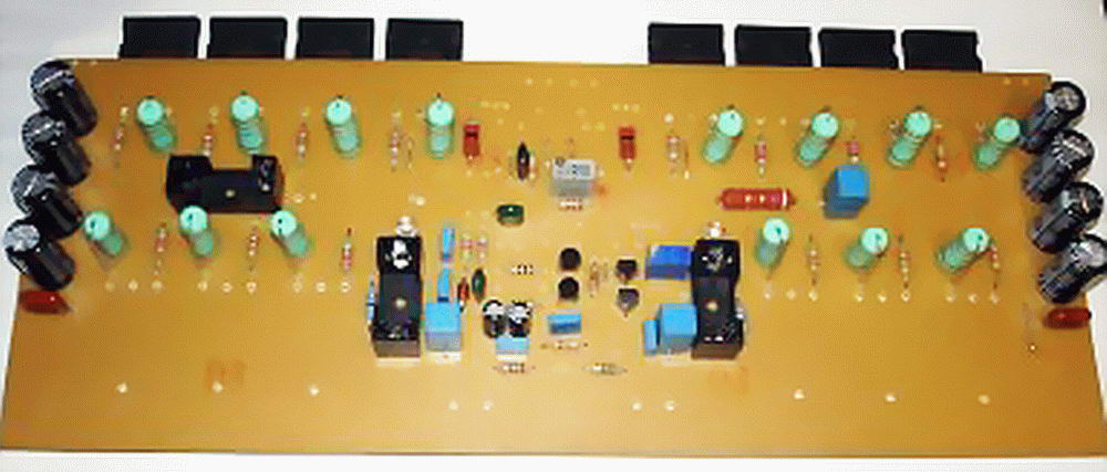

Here is the artistic vision from his board
Marcisio lives in Belem... a town in the middle of the Amazon Rainforest.
Holland people gave him this name... Souza... some of them came from Portugal and others with a sligtly different family name came from Holland.
regards,
Carlos
