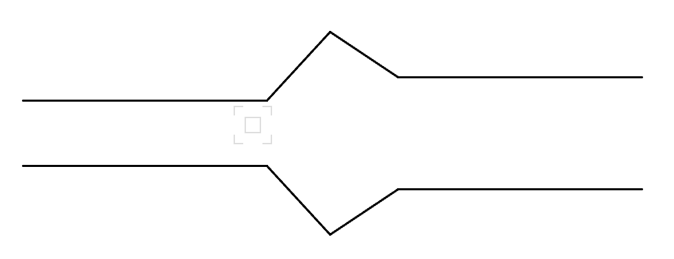

The exterior will just be a result of the interior in this case. The aesthetic can be solved later. The reason for sharp corners as you say, if I understand correctly, is so the high and mid frequencys from the back of the speaker don't bounce straight out the mouth of the horn?
A little of thta maybe, but primarily the “square” bends create an expansion in the line which is a low pass filter.

Each bend looks like this when you unfold it:
dave
