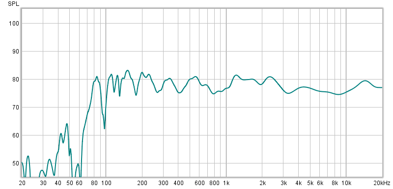

With very little damping, this is a fiew result around the livingroom from REW with variable smoothing, the peak around 600k is noticable but it does sound decent. The driver have only seen about 15 min of music before the test as well.
Will probably serve well as a satellite in a 2.1 system.

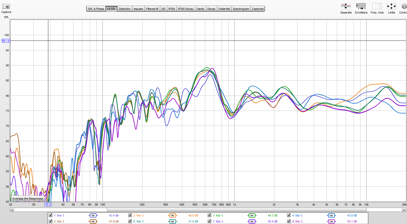

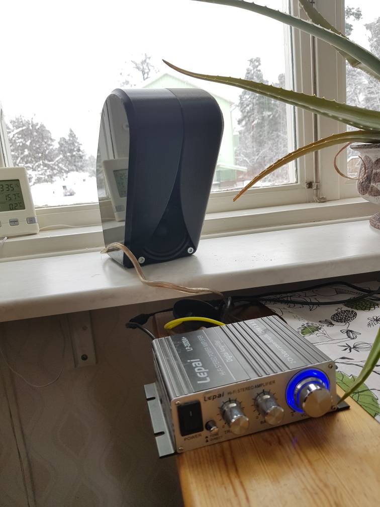

Here is one with some minor EQ, and a photo of the setup
Yeah I will look in to where that might come from. I must say that after the eq adjustment they sound surprisingly large! And 85hz sure is unexpected for the size.Looks like you are getting 85Hz - very nice. That 600Hz peak is strange and might be a TL resonance as it corresponds to a 11in long 1/2-wave distance from one surface to another. Damping/stuffing might help.
The total volume of the outer dimension of the speaker is 2,8 liters... Cant really understand how it goes to 85hz! after some listening time the sound starts to grow on me and it sounds pretty impressive, with the eq enabled...
I have -15db on 650Hz. I have been measuring in the model and it seems to be the resonance frequency of the housing itself rather than a TL resonance, and some tapping on the "back panel" seems to confirm that. Hopefully some damping should solve that, if not, i can actually play with the behavior since the panels are 20% filled at the moment, meaning that i can make them 80%more dense just by changing the printer preferences.
