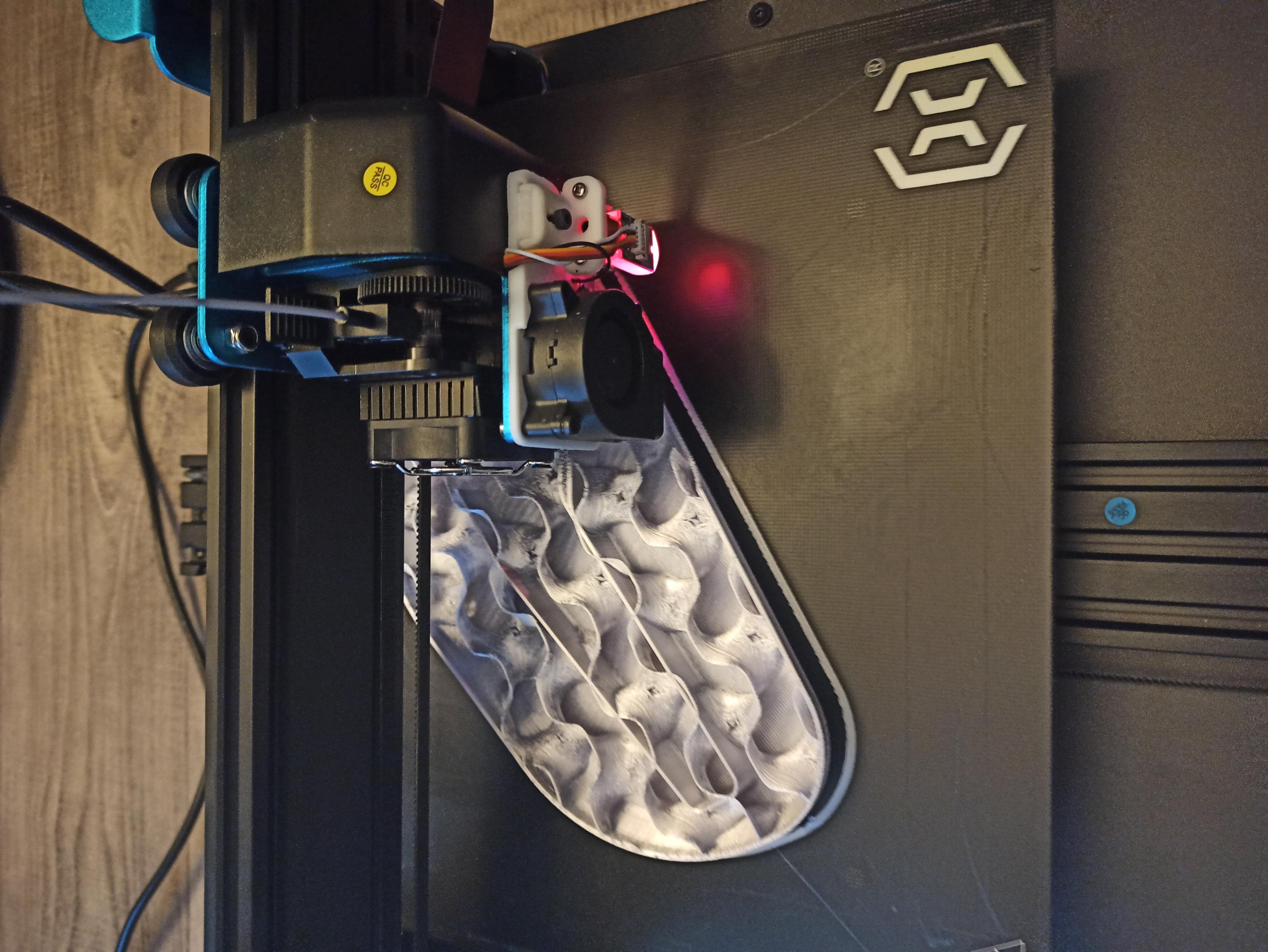

I was looking at cura's setting the other days, especially the infill, i was searching for something open enough so i could fill the inside of the walls with sand to damp the resonances.
The gyroid made sense in that regard, so i print a couple of test pieces including a cube with very skinny walls. It is not so clean but wow the strength of that thing is unbelievable.
One thing leading to another I'm now thinking to fill the inside of the box with with a gyroid like structure just to see if it will affect the speakers response.

When you 3D print a solid you can choose level of infill porosity. Something like 8% infill density might have similar effect as this wavy matrix stuff (which is very cool). You can basically print custom shaped internal damping instead of using stuffing. Plus, the box will be very rigid and not resonate.

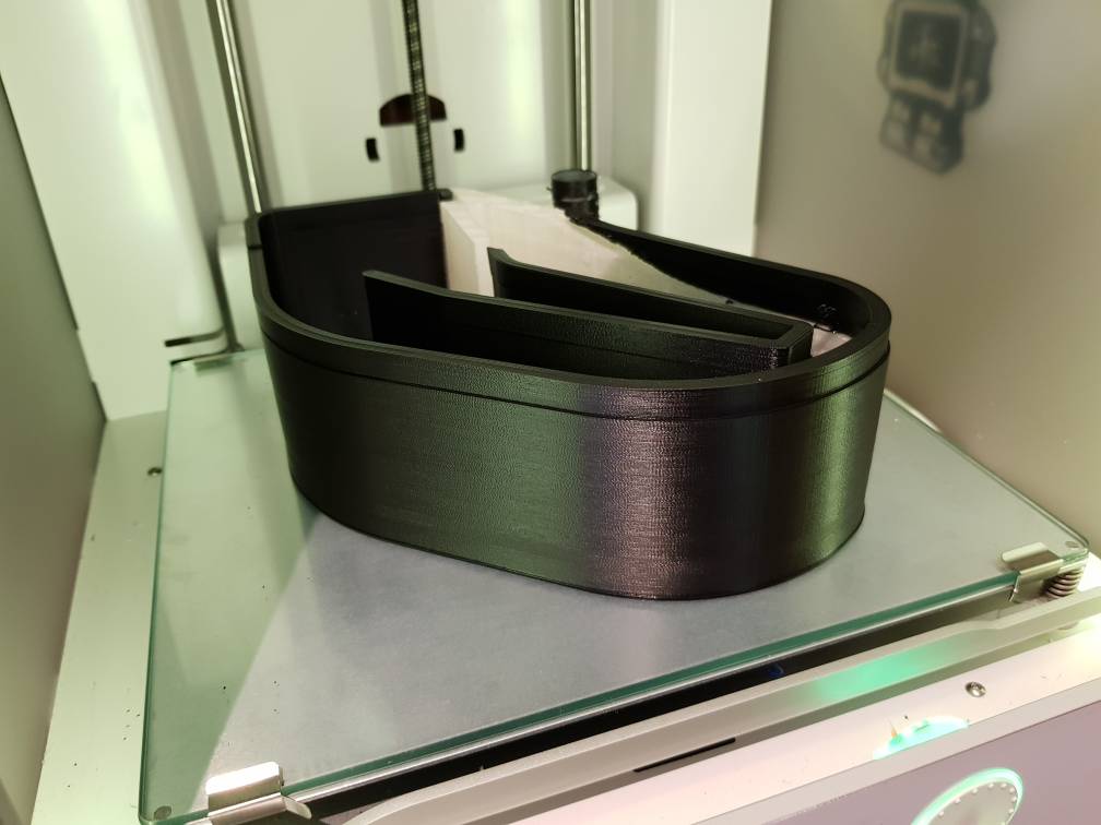

I modified the "sandwich" version to make the driver mountable from the back. The support filamet in the narrow opening is hard to remove without leaving tool marks so i will try to print with PVA as support, which is solvable in water and allows you to make "impossible" geometries. It is a little over kill for this, but since i have it, why not use it?

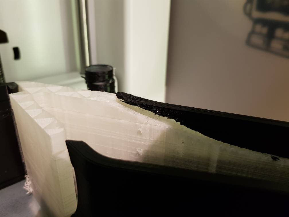

The PLA did not stick enough to the PVA, causing wrapping and eventually the head got stuck and misaligned itself...
