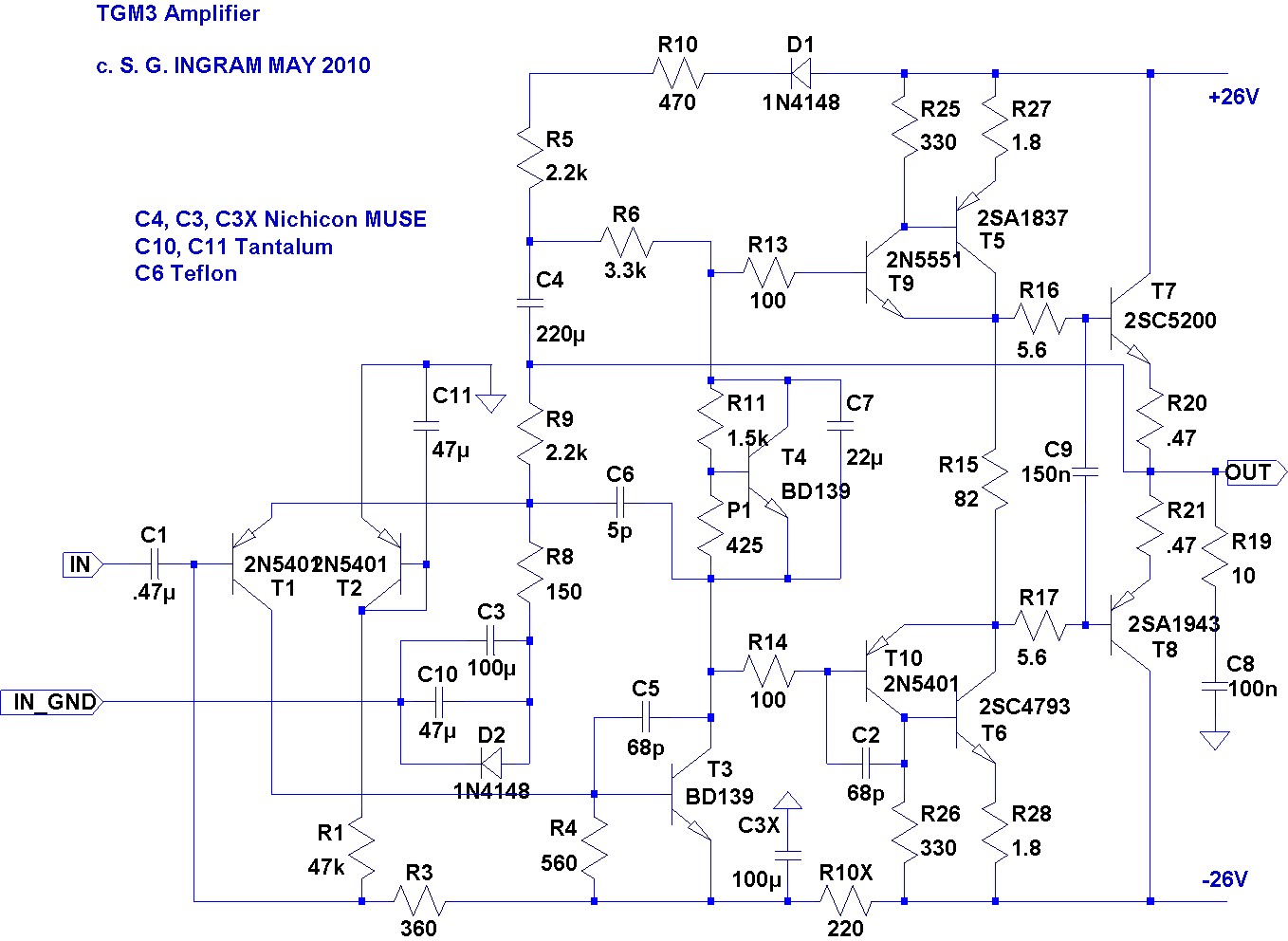

Do you have Cdom set up like in the schematic at the beginning of this thread? I would try moving Cdom to the VAS collector, that looks iffy to me (I think the benefit would be small anyways). Also, I think you should do away with two-pole compensation until you get it stable, then move up to more complex stability compensation.
Oscillation in the hundreds of KHz is strange What are you using as outputs? Those don't look like japanese devices... They may have horrendous Cob.

I have only implemented the simple Cdom at this point. The output devices are Fairchild, in fact all the parts are from the same batch or lifted off the pcb of the TGM1. 125kHz seems low for this to be related to the CFP, it'll take a lot capacitance to fix it at this frequency - I'm going to check the pcb for the possibility that there's still some gotcha I've missed.

My intuition was correct, this is too low a frequency to be the output stage oscillating. The issue was rather disappointing, it was classical feedback from output to input due to the temporary positioning of wiring external to the amplifier. My input and output were too close and I can move the wires to turn on and then turn off the oscillations. So, onward and upward 😀
Joined 2009
Found some >10MHz oscillations at the CFP driver, heating up the drivers and warming the Zobel. Fixed with a 68p on pre-driver (didn't try a smaller cap but likely can be reduced)

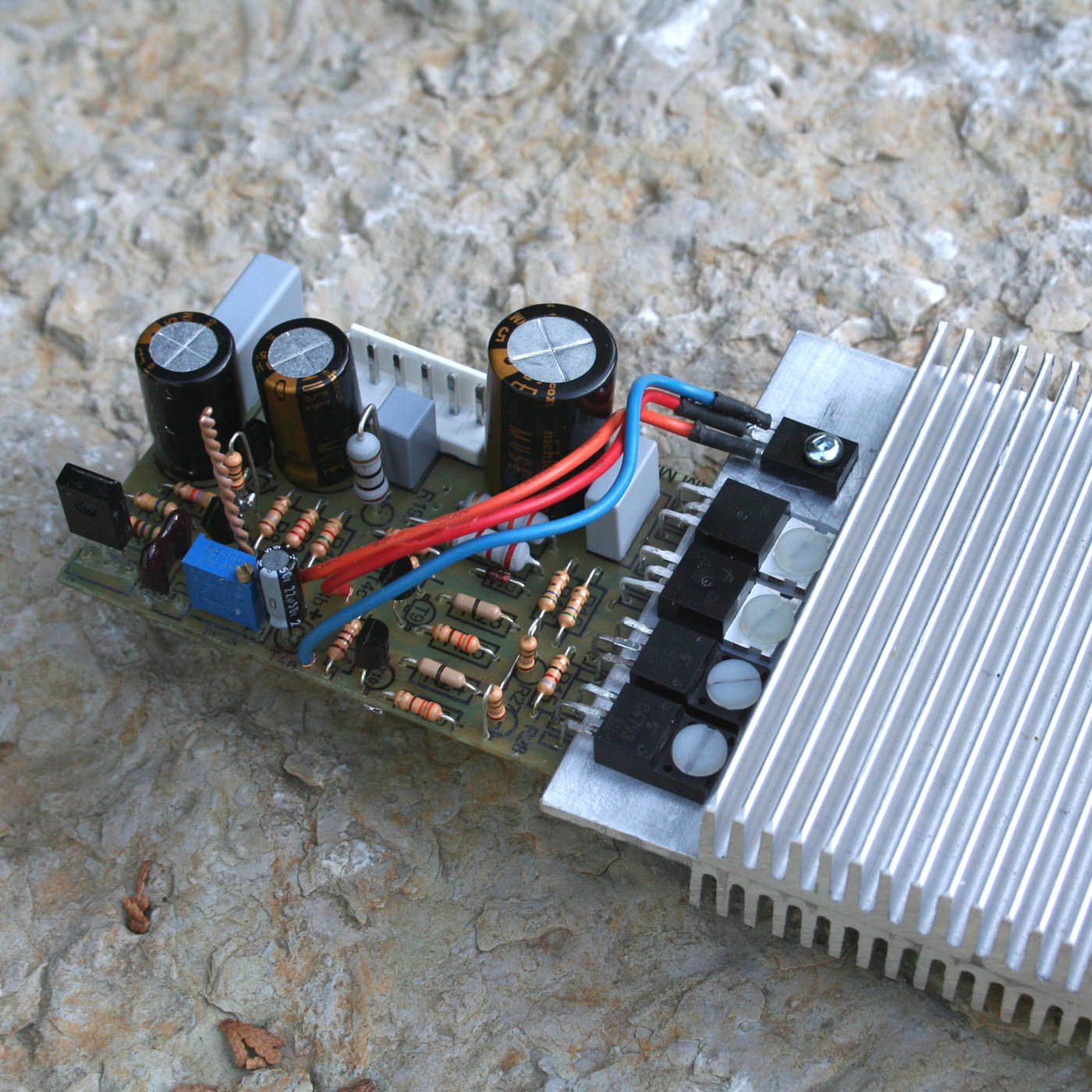

A photo of completed module.... note the home made teflon capacitor for the phase lead compensation (twisted brown wires) 😀

Here's the updated schematic showing the as-built version.
(there maybe some hidden benefits in terms of sonics from the use of Tantalum as a bypass for the feedback shunt capacitor cunningly hidden underneath the pcb - highly recommended if the sound I've heard is anything to go by)

The bias generator for the input transistor looks really confusing to me. You might want to redraw it.
