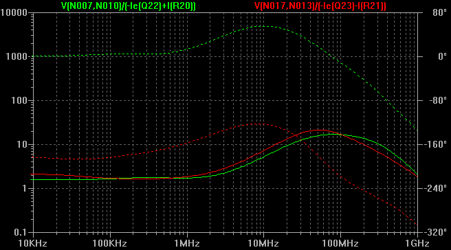

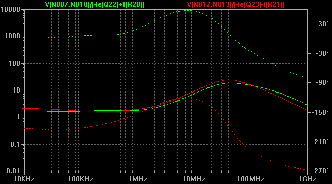

I've been messing around with this CFP driver configuration in the simulator. I suddenly remembered that a while back in the simulator, I discovered that a collector resistor on the slave device improved stability in most applications. I wanted to look at the stability of the CFP's in their current position, so I plotted their output impedance, looking for phase strangeness in the high MHz range (plots show both CFP, complimentary driving output EF). Then I added 100 ohm slave collector resistors. I think it is a healthy improvement. If you're worrying about stability of the CFP, you might want to try this.
The first attached plot is the output impedance of the CFP's without the 100 ohm resistor. The second plot is with. I like the change, although I don't understand the mathematics behind stability much. All I know is that gain should drop off completely after several hundred MHz, instead of rising, and phase should drop too. Usually this is a sign of stability.

Okay, here is the real data, and the change isn't as impressive as I once thought. So you can disregard most of what I said in the last post.
The main significance is that this is a very benign way to slow down the CFP. Other ways I've tried always had side effects.

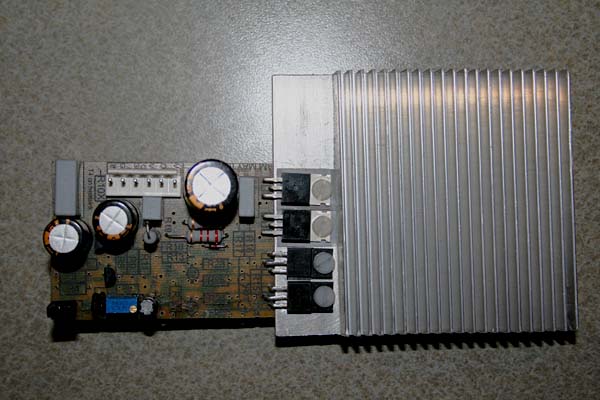

I've powered up the board. Doesn't work. dc offset -2V, no current flow through the output devices. I think the input had a short which I've now cleared. Now too much current flows through the output devices. The struggle begins.....
Operating conitions seem to have been restored with dc currents all checked out, but the amp is blowing fuses. It's drawing a lot more current than the voltage drops across resistors says that it is. That current doesn't seem to be showing up in the dc analysis.
but - the zobel resistor is very hot, oscillations I presume Mr Watson, time to break out the CRO
Have you tried the lightbulb thing? Maybe I'm just cheap, but I hate wasting fuses.

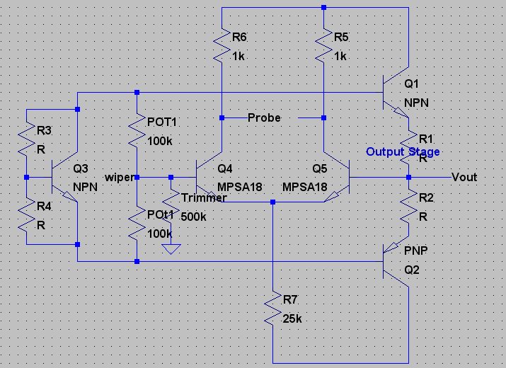

I came up with this circuit the other day, wondering how, in real life, one might adjust output EF bias with some feedback. This way, you can watch on the scope the output distortion and adjust the bias perfectly.
This is my idea. Adjust the 200k POT (two 100k resistors) until DC the LTP is balanced, and then adjust the 500k POT until you can see the OP distortion clearly. Now you can adjust bias until the trace disappears. (divider values are large to keep from loading the VAS)
I thought you may be interested and have the ability to test it out (I don't see why it wouldn't work). Apart from the common bias point around 100mA, you might want to try find the Null point, in the simulator it is usually above 200mA (however I think I remember that emitter resistors ruined this possibility). This point gives much lower distortion.
I know you already have a lot of things you will try, It's your call.

I was expecting to see oscillations above 1MHz but instead they measure at 125kHz.
Increasing Cdom to 47uF killed the oscillations so at least that gives a data point!
Increasing Cdom to 136pF was ineffective, even with 100R emitter degeneration added to the input device/error amplifier. Phase lead of 22pF also ineffective. More drastic values are not likely to be good for sonics. I will take another look tomorrow and consider some capacitance between B-C on the pre-driver (although 22pF was ineffective when tried). It's reputed to kill the sonics if a large value is needed here.
Edit: Kean, just saw your post. It looks interesting, but I don't have an LTP on this design to try that. I took out the fuses - the fulse holders are paralleled with 10R power resistors, a kind of poor mans light bulb. But even with this, the zobel gets hot fast so I turn on, measure, turn off. The CRO shows the oscillations very clearly so it's pretty convenient. It's quite exciting, I never had much trouble with the other TGMs so this is my first time to have a play with something less cooperative.
The circuit only needs two transistors, hopefully of very high Hfe. The other transistors were just to illustrate how it would connect to the output stage. I thought you might sculpture solder it above the board. No precision is needed here.
