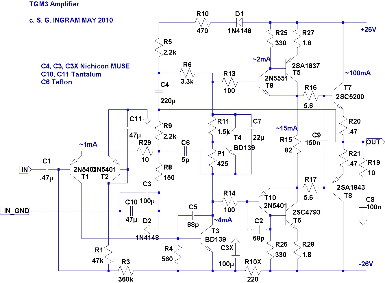

I drew the bias generator for the input purposely like that because for some strange reason I like the way of thinking that the second transistor is there to balance the input transistor for dc conditions - rather like in an LTP. Of course, it's only there to provide a level of temperature compensation for drift in the input device and could in principle be replaced with a single diode for 'good enough' matching. It's part of the fun of DIY that you get to make such personal design decisions.
Tantalum has a mixed record and the quality of these capacitors has changed over the years as has Aluminium electrolytics. Good quality tantalum capacitors can offer some real benefits such as better high frequency performance and much longer life reliability than electrolytics. Some people have reported that Tantalum capacitors sound good (perhaps they introduce a bit of H2) but that's hearsay as far as I am concerned. If you treat them badly, Tantalum capacitors will go up in smoke rather easily whereas aluminium electrolytics are far more forgiving.
I used one simply because it was on hand, and as Andrew points out, I have the feedback shunt capacitor under-sized, so I wanted to add a bit more capacitance there, it really should be bigger. Tantalum caps are relatively small for their capacity and easy to tack one on the backside of a pcb. I was hoping it's use would be controversial...
The main reason C3/10 was not larger is because I was leveraging from the TGM2 pcb layout and already had a capacitor sized for the board. I would suggest a Nichicon MUSE 2,200uF cap here to replace both C10 and C3. In the final application for TGM it is a home theatre surround, where I do not need bass response below 80Hz - 100Hz so it's no limitation there.
If/when I build a dedicated stereo version of TGM3 these things will be addressed along with some other changes (e.g. R10 is unnecessary but was a left-over from TGM2 pcb, I would also explore reducing R20 and R21 to 0R33 or even 0R22 - but first check that the sonics are favourable, pre-driver base stoppers can be halved to 56R, power rails should be at least +/- 36V, at least try out a CFP Singleton input). Were there to be interest from others on the Forum in this design I would be willing to begin such a project sooner, but otherwise it will more likely be in the Fall.
Until I had built this design I had never really accepted the sonic benefits from a triple in protecting the VAS from the output stage, and from driving the output stage from a strong and linear CFP.

Bigun, what confuses me about your input is R3. This effectively makes input impedance 330 ohms; bass would be limited severely I think. If it were not for this I don't think I would have asked.

Oh dear ! - my schematic says 360 when it should say 360k - it was actually implemented by putting in parallel a 1M with a 560k because I didn't have a 360k resistor on hand.

Agreed - It would make life easier than using a fixed resistor that you have to finalize after you've built the thing (I didn't happen to have any pots of this value to hand)

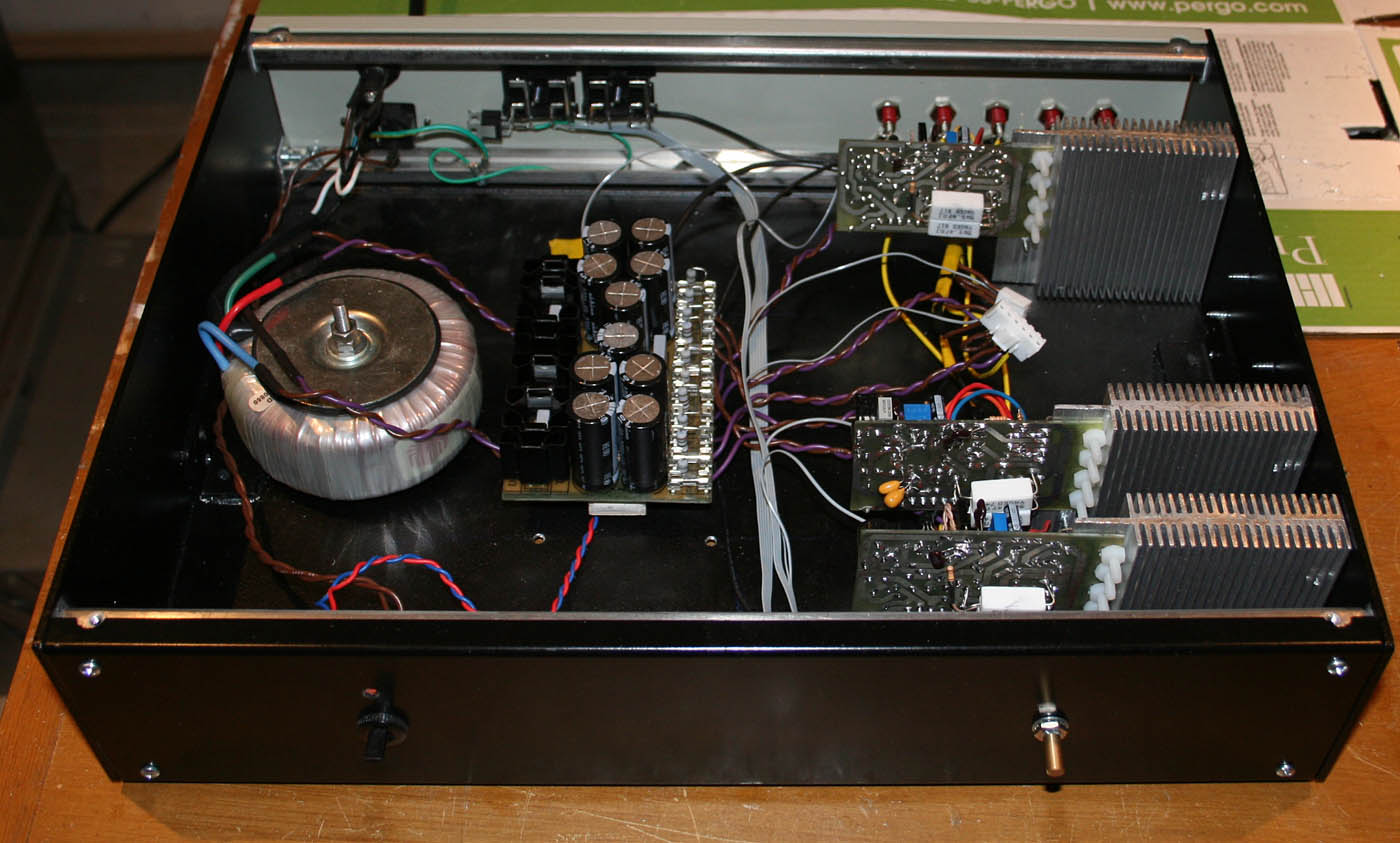

A quick photo of the inside of TGM box...

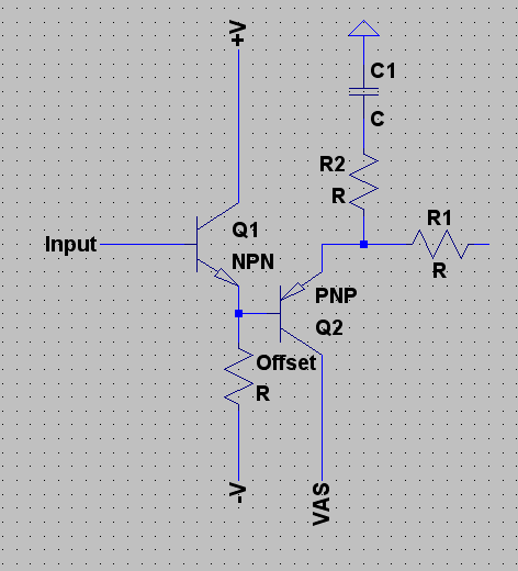

I think I know what the limitation is on TGM3 dc offset drift with temperature - the current flow through the two transistors (input device and bias device) are too disparate. A higher current through the device in the bias circuit would help but that would lower the input impedance which I'm reluctant to do.

Could you try something like this for the offset? Tempco would be compensated anyways. It might not be wise to adjust offset using the resistor shown because changing it will give the transistor different load impedance... So it would probably be best to adjust DC with a bias network. Current through Q1 should be close to that through Q2...

DC offset is not so much of a problem as you suspect. Speakers will tolerate up to 200mV of offset for long periods without damage or adverse effect on the sound.
You need a bias system which raises the bias voltage towards ground with temp as the circuit warms.
The bias transistor could form this voltage directly, with something like a LED (or diode/LED string) from ground to a 4k7 resistor to neg rail. A 33K resistor from the bottom of theLED/diode string could then bias the input base directly. As the forward voltage drop across the LED/diode string decreases with warmup it would raise the bias point slightly, compensating for the dropping Vbe of the VAS. The bias generator should track the temp of the VAS, but keep it nice and cool anyways....

Well I kinda have this in place. I use a diode-wired-transistor in place of an LED though. It's connected to ground on one side and then to the negative rail via resistors on the other. But I've had to use fairly high valued resistors to ensure that the bias is correct - i.e. the base of the input device needs to be held very close to ground (close to Vbe away from ground) so in using a diode-wired-transistor hanging off ground I end up needing a large resistor to keep the bias voltage away sufficiently far from the negative rail. This reduces the current flow through the compensating diode wired transistor to a trickle which makes me wonder if this results in less effective temperature compensation. I don't have a heatsink on the VAS device - this would be easy to fix by popping on one of the small metal sleeve types. I'll try this.

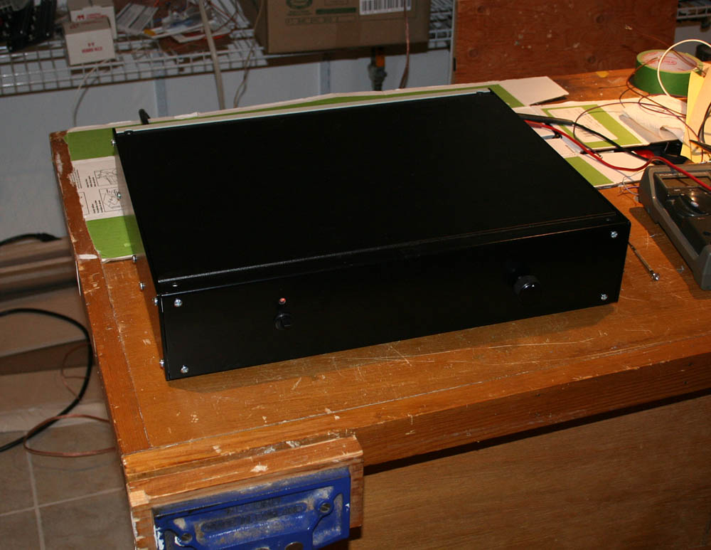

Well, several hours of burn-in and no issues. So listening can start. I've plonked the unit on top of my Dynalab FM tuner for now.
With the higher quality source and my own design of speaker, it really sings. Smoooth.
The missus says it sounds great - who am I to argue 😀

Have you tried a resistor between T2's collector and negative rail to try and get the quiescent current through the input and bias transistors equal? Just bypass the bias resistors with something enough to give about 1mA through the bias device.
