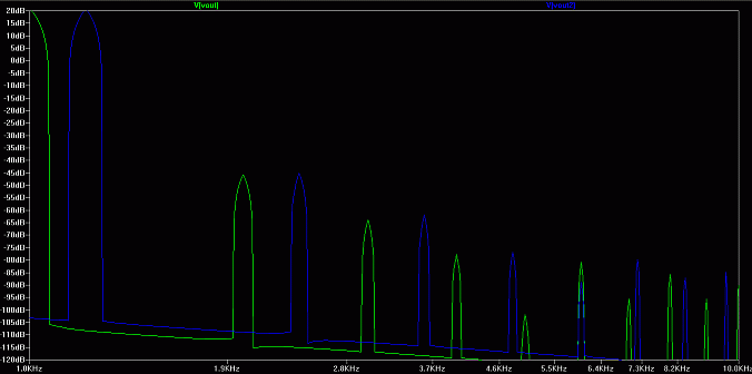

Using two bootstrap caps, one for each side of R15 in Bigun's schematic, decreases 5th harmonics by 11db at 1KHz.
Here is the file I simulated with. Change the extension to .asc.

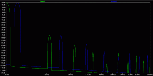

I was curious and just tested the CFP input. Distortion is decreased by .01%, but the harmonic profile is rather unaffected. If I wanted to reduce distortion without affecting the amp's sound, I would use this.

I've run your simulation file and also see a reduction in the 5th that looks worthwhile, also in the 7th. I duplicated the circuit and ran one at 1kHz and the other at 1.2kHz to separate out the FFT peaks more easily (but it gets confusing after a few peaks).

One thing occurs to me. By adding OLG you can't get rid of ANY harmonic. You can only decrease it's magnitude. It might look like it's disappearing if you're pushing harmonics into the noise floor. So really, increasing OLG should be the LAST thing you do when designing an amplifier. Just my questionable thought for the hour.

Interestingly, my simulations don't show the same benefit on reduction of 5th harmonic when repositioning the bootstrap capacitor take off point when compared to Keantokens simulation. I've run them both on the same computer. We both use Spice, but we have slightly different set ups in terms of spice parameters and we are using different device models; I am also running of 26V rails instead of 36V so also using a lower output swing.

I can get a similar reduction in the 5th harmonic by increasing the current flow through the drivers (as suggested by Andrew T) by reducing R15 to 56R, which gives around 20mA; I also increased the current through the predrivers to around 3mA each.

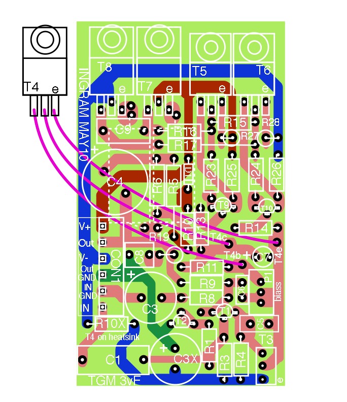

Lastly,the pcb layout had a mistake, the base-collectors of the drivers were transposed so I have had to update the design:
