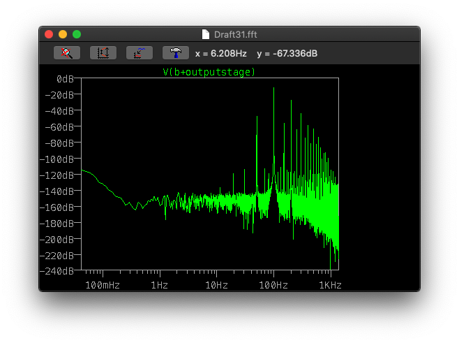

I noted a minor issue in LTspice - the output was duplicated as a node name which would have meant that the outputs are shorted to each other.

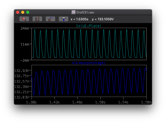

I have one channel running my cathode biasing to give a big grid negative bias on start, the other doesn't, I prefer the bias to the non-bias which probably is just about behaving due to chance:
This is with zero signal, in a station with a signal the lower trace would be conducting at a higher rate.

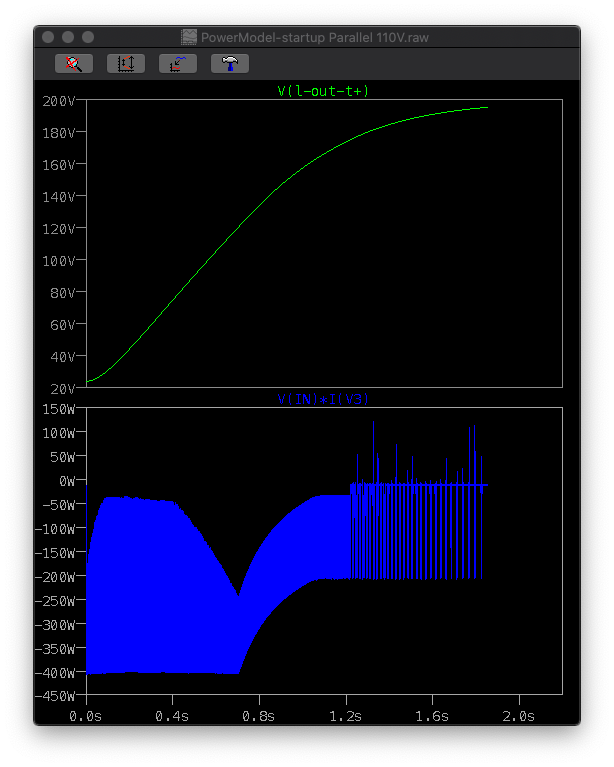

So I've not had much time this week due to work etc but I have figured next step for the power situation.
The capacitor inrush is about 350J, in DC money that's 350W for a second. In AC-rectified DC that's more spikes hence we see about 550W for the first cycle and dropping off as the cap charges. In total about 15 second for this resistor to be taking the brunt of the power before it's switched out.
When you look at the size of 50W resistors, ten of them.. that's a large amount, so looking around I found another option - a 500W 2.2Kohm resistor (1500V arc rated) measuring 30cm x 8cm x 1 metal and with heatsink mounting holes. This would do nicely from a form factor plus it could be used easily to discharge if needed. So in that 15 seconds the power can be dissipated over a large area but in normal running that can be switched out.
This seems like a decent option - the price is about the same as the resistors needed so an expense but probably the better long term option. I have visions of SMPS in the future but the cost to make a buck-boost isolated LLC resonant high voltage with current tends to mount up quite quickly.

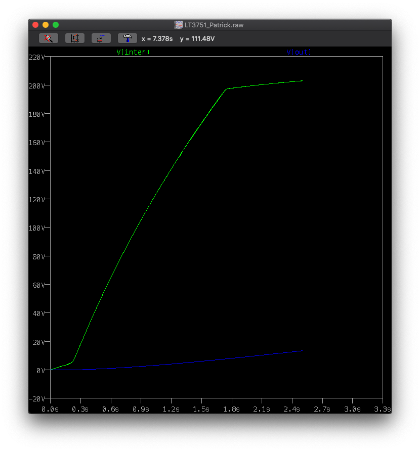

So I've been experimenting with SMPS. Noise I hear you say!
The idea is 240Vac -> 24Vdc -> 200-240Vdc
The LT3751 chip is a capacitor charger flyback chip, it also has the ability to regulate using a switching setup. I has a charge mode, a regulation mode and a no-load mode and varies it's behaviour for each mode. The mode can be selected directly or by the use of the feedback voltage, so I can use charge mode to go from 0V to 199V then switch into regulation mode which is quieter for the 200V and then if it rises a little more then it will switch to no-load. The chip also allows you to set a current limit.
Unlike other flyback chips it's designed to cope with capacitive load, controlling inrush and then provide regulation power as needed afterwards. There's no limit on the capacitor either - so it works with 6,000uF (6mF) 450V no problem and is happy outputting up to 500Vdc at over 150mA with the right transformer.. The great thing is you can also set the FB to operate to a preset voltage.. like 200V or 300V instead of 500V.
The transformer I'm modelling with this is made by Coilcraft, a 1:10 turn and is designed to cope with 12-24V 50A, outputting 500V.
As it only takes the power needed, the consumption is very low. For example I have it setup in the modelling to draw a maximum of 24A 24V. A 648W SMPS off the shelf can give 27A. That SMPS could have PFC and so the power draw is far far less with less current harmonics than the toroidal setup.
The green line below is the 6mF capacitor charge voltage. the bend at the top is the switch to regulated. Sub 10second charge and not having a massive inrush is a selling point. The blue line is the soft start from the LT3080-based Maida-Christian regulator after it (model still running) and that soft start takes about 30 seconds.

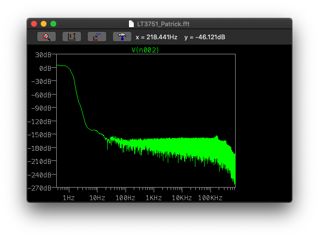

An noise? Well this was from the previous incomplete run:
Still need to have the system running for 90s simulated so I can get a proper sim reading but that's promising!

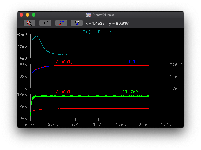

So this is promising technique.
The amp ready point is now 5 seconds - although the heaters would be need to be switched on 6 seconds in advance. The timing in the plot is 2.9 seconds + the plot time.
Top is the bias clamp (along with the grid 0V clamp) means the tubes are held at -24V grid. This also has the benefit of pre-charging the large output caps a little. They typically have about 6V on one side but without the bias clamp and grid clamp, the large cap sees a large 100V+ spike from the B+ if the headphones are disconnected. Now that is a matter of 24V initially then down to the operational voltage. The output to the headset is switched by relay and has a 1K termination and mute switch 32ohm load to ensure that having the headphones disconnected doesn't result in a large DC charge.
The middle is the power supply rail for both channels and the bottom is the tube supply rail after a bi-directional R=C=R filter. The current for a tube is 16mA rather than the 24mA, so I need to adjust the filter slightly.
It's looking like the power required by the signal paths will be about 200W or 250W with some margin. Then add the heater power (also from the 24V power supply but stepped down to 12.6V) however it may be just as cheap going 240V->12.6V don't know yet but something I'll investigate.

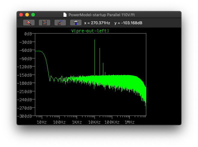

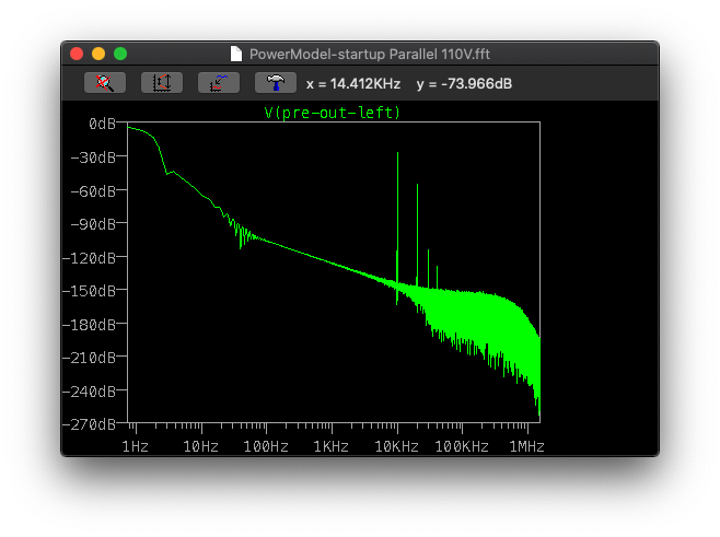

Slightly longer along the same model.. the amp is stabilising (about 4.5s in):
So this is looking very good (there's a 10Khz on one channel and a 30Hz on the other to check for cross talk). The input signal is 447mV so the amp needs a little adjustment but I'm more interested in the power supply at the moment.

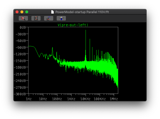

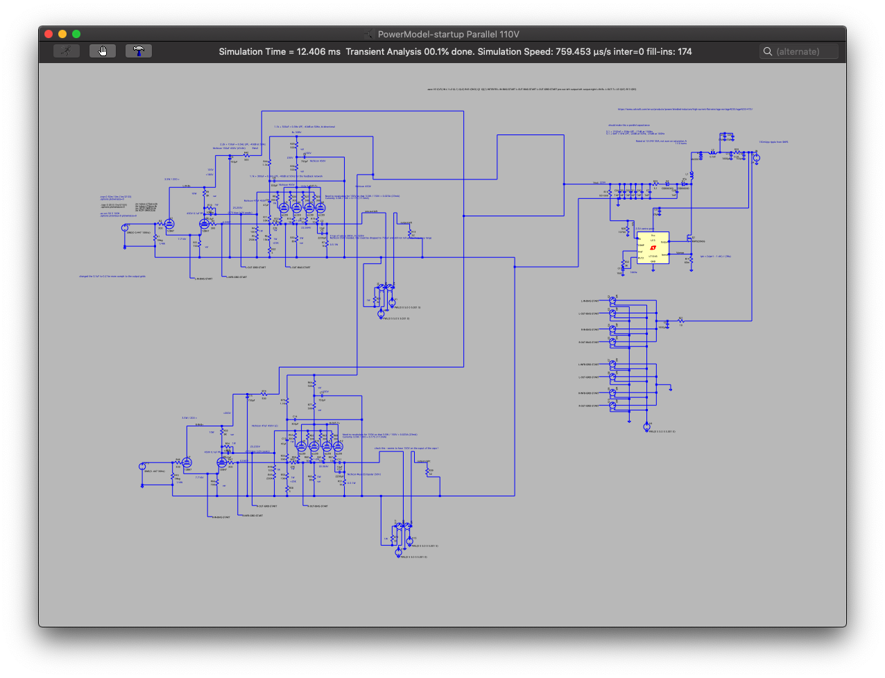

So after 500hours of cpu time, the model is getting a little unwieldy from LTSpice's bad memory management. Although the raw file is only 42GB, that's 6.2 seconds of simulated amp time with the switched mode power supply.
So time to start exploring hardware for the SMPS. The eval kit is over priced and underspecced and the other SMPS don't offer the same large cap support needed really.

I've been investigating this more.. before I press buy.
The LT3751 has two modes - charge and regulation, with no-load being ignored.
So looking at the model I'm using a 5.5mOhm resistor to set the current limit, which in turn pretty much dominates the power output. So I'be been seeing if this would fit into the 300W as mentioned above.
The chip has a number of modes and sub-modes. The main being charge and regulate. However the approach also varies between the modes;
* charge, peak current for charging until either the current drops or the FB gets to the desired level
* regulate, has it's own peak current and the loading approach is split depending on the FB level:
Charge 100% Imax duty cycle 100% current used
Regulate 10-95%
* Heavy 50-95% Imax duty cycle
* Moderate 10-50% Imax duty cycle
* Light = 10% Imax
No-load = Imax where voltages rise above the FB>1.34V IIRC.
Regulating heavy load, the peak current current can vary up to 95%, but the period between pulses varies. the lighter modes are simply a way of saying it varies both the amplitude of the peaks (<95%) and the the number of peaks per 26KHz clock (ie in 38uS)..
In heavy load, the power output is:
Pout = 1/2 * Ipk / (1/Vtrans + N/Vout)
Interesting if we set our Ipk to the max 25A for 24V, with our 1:10 trans, for 200V we get:
Pout = 1/2 * 25 / (1/24 + 10/200) = 136 Watts - this is our maximum that the transformer can cope with.
As P=VI, 136/200 = 680mA at 200V being the absolute maximum ignoring reality.
In charge mode, if you want to ensure a charge in a given time period then
Ipk = (2*N*Vtrans+Vout)*Cout*Vout / efficiency*Vtrans*(Tcharge-td)
But this differs for regulation, where Ipk is
Ipk = 2*Poutavg/efficiency * (1/Vtrans+N/Vout)
Now assuming efficiency at 70%, that's 0.7. So the formula would read:
25 = 2*Pout / 0.70 * (1/24+10/200)
25*.5*.7 / (1/24+1/20) = Pout = 95.45 W.. so at 200V that would be 477mA.
So let me get this right.. 25A * 24V = 600W. And out of that 600W you get 95W regulated.. or 15% efficient.
Well.. that would depend on the period of the pulse and how many times/sec that is.
They give these two formulae..
Lpri = 3uS*Vout / Ipk*N
Lpri < 38uS / Ipk*(1/Vtrans +N/Vout)
Lpri = 3x10^-6 * 200 / 25*10 = 2.4uH
38x10^6 / 25*(1/24+10/200) = 0.1393uH
So there's a possible problem because this is not true 2.4uH < 0.1393uH !
So basically this means we can't deliver enough power per charge spike. We would need to increase the Vtrans, instead of 24V this would need to be higher. However the transformer has a max of 24V. The chip can do Vtrans of 40V but then that messes with the power supply which would need to be 48V with something limiting the voltage to 40V.
This was going soooo well but I suppose you can't count your chickens until they're hatched..
This would explain the reason why they only get 200-300mA out of it in regulation mode. So in order to be useful I'd need two - one for each channel.
Hmm time to lick my wounds and have a rethink.

So far the B+ lines are at 200V, and the system has started to backoff 'blanking' cycles from the PWM. At 5secs the amp switches off the negative startup bias for the tubes. So we should see that B+ voltage dip back to about 150-180V.
Top is the B+ line at the output tubes.. bottom is the power being pulled from the 24V power supply. You see the behaviour of blanking PWM to right as the power draw is backed off. That 400W is the peaking off the PWM, so in reality is less than that.

Current run is looking very good, noise levels are low, it's hitting 150V at the output tube and is taking peaks of 130W (probably less averaged) without dropping to idle. So this is looking good for a 300W supply.
This model is the full amp (heaters are running off a separate supply) but with 447mV input signal. I want to run a 3.16V +20dBV sustained output just to see the behaviour (if we see any sagging etc). I don't foresee a problem with current and power but just checking is worth the time. At that level all the tubes are running at max signal (ie output signal extends to close to 60mA per triode) for full power.
It's worth spending a little time characterising the design to ensure it's going to behave in the right way at different power levels (0V input, normal 447mV and max 3.16V).
Given the there is a bank of caps on the HV side, it's worth looking at inrush at the start as the 24V from the supply will find a very low impedance path through the HV diodes and then through the 5.1ohm resistor. Not that the design can't handle that - I have very little doubt about that but the 24V PSU may trigger it's protection given the immediate current draw.
I also have to think about the same for limiting the current to the heaters. Otherwise the heater SMPS will simply see a short circuit until the heater warms up.
An FFT from 7-8.1s of the simulation after startup..
So that's showing the 10KHz input on the left and a some cross talk from the 30Hz input on the right channel.
This is the model it's running:

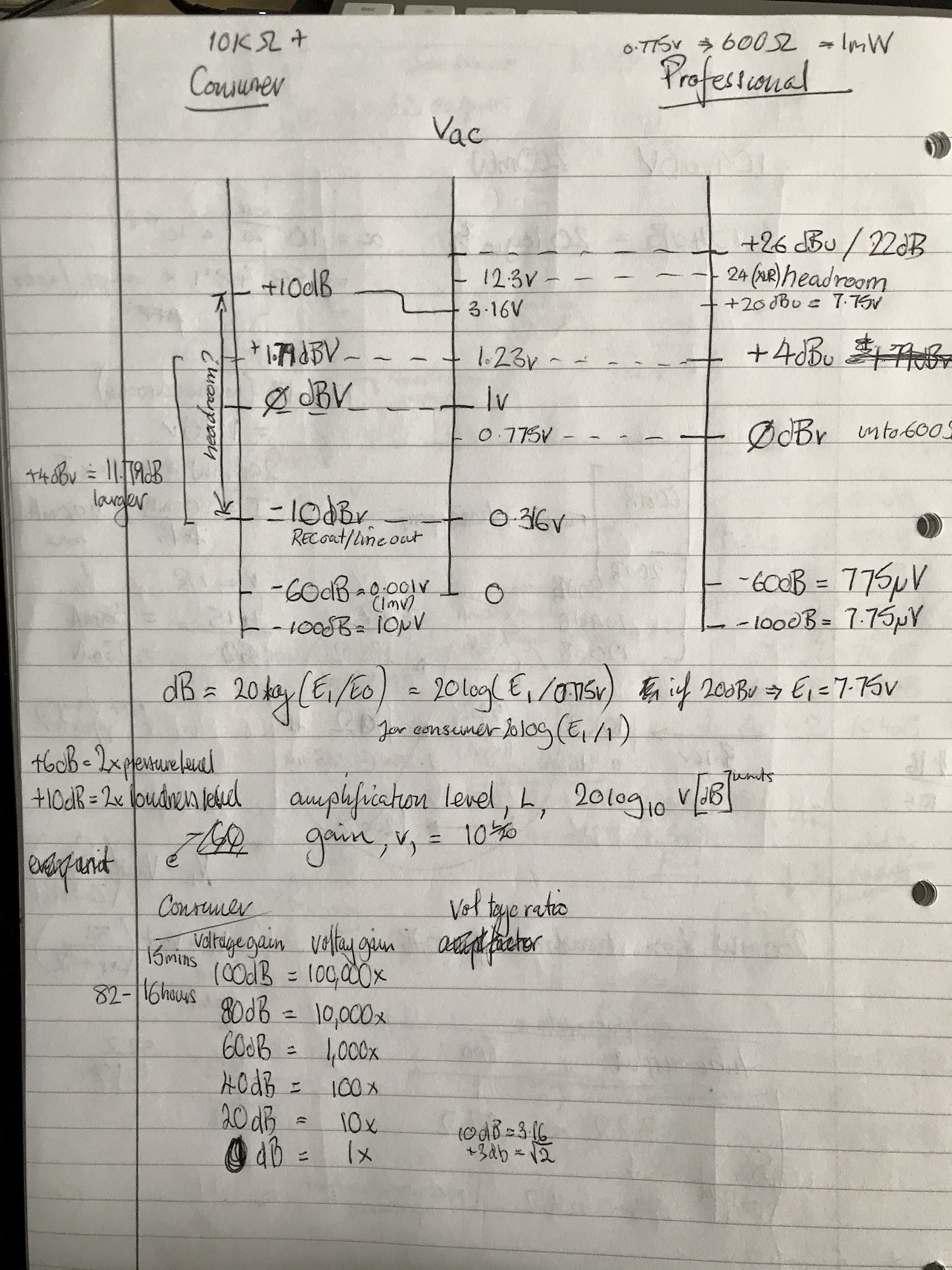

+10dBV. (20dB above -10dBv, a common hi-fi reference from days of tape.)
