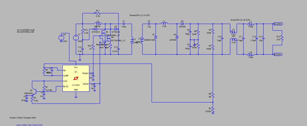

So I've been researching PFC with a focus on noise, harmonics, and subharmonics.
<150W DCM generates noise due to the drop to zero (I found this before when looking at them)
150-250W CrCM (TM/BCM)
250W then CCM becomes the order of the day for higher power and lower noise. My boost controller I was looking at before was CCM for this reason.
So most PFCs are basically a boost converter. The key here is that if we don't want harmonics then we must ensure our output voltage is above the input rectified AC voltage.
I've looked at interleaved boost controllers too before, and in fact you have the option of parallel or interleaved PFC for more power.
With an eye on the heater requirement meaning about 30W-50W that means at 10% we should be in the 300-500W PFC bracket.
Next up is the switching - the UCC28180 is a CCM programmable frequency PFC controller that can switch up to 250kHz. There's also the UCC28070 that's a CCM two phase interleaved PFC controller too.
The CCM topology has one major difficulty and that's the reverse recovery loss from the diode. That can supposedly account for 20-40% loss so a SiC ultra-fast recovery diode is required.
The pspice model for the UCC is flawed as it doesn't fully model the current handling so you don't see the proper waveform back to the AC. Also it's been going since 2009 so I may continue to have a look at more modern options.
The majority of the Onsemi NCP range CCM ICs are only 100kHz switching, although the NCP1654 does do 200kHz.
The L6562 and L6599 are transition mode (CrCM) so those aren't first choice.
So for now it looks like a 300W CCM PFC (probably non-interleaved) is the way to go.

This is a great centre point for topologies: https://www.ti.com/seclit/ug/slyu036/slyu036.pdf
I found a couple of interesting points on the EMI noise aspect - I'm specifically researching noise and EMI:
https://vtechworks.lib.vt.edu/bitstream/handle/10919/73166/Wang_Z_D_2016.pdf?sequence=2
This has some very interesting stats in terms of caparisons and component losses. It also shows that Gan-MOSFETs etc are possibly the way to go for efficiency due to their extremely fast switching as the losses are in the terminal capacitance of the mosfet etc and the use of ultrafast diodes with little or no reverse recovery losses.
Given we want to push 100-200kHz to shift the noise above the audio spectrum it's also worth noting the impact of non-fixed frequency that can put noise into the t/4 area so keeping to 200kHz means even if the chip does use frequency changing to manage the load better, it's only going to make noise at 50kHz, but it does make our filtering harder.
The CCM PFC is essentially a boost converter but focused on current shaping so this follows my boost converter work quite nicely. As a booster we must have a Vout>Vin and we should have 10%+ load as a general rule or we'll have sub-harmonics as extra noise, plus sub-harmonics creates a lot of coil squeal/whine which is not something we want from our PSU is it..
Another paper I found detailed the use of a second winding on the inductor to provide EMI noise cancellation. Almost like a common choke as the inductor. That can be found here: Noise Cancellation for Miniaturization of Switched Mode Power Supply | OMRON TECHNICS | Technology | OMRON Global
Worth exploring in ltspice..

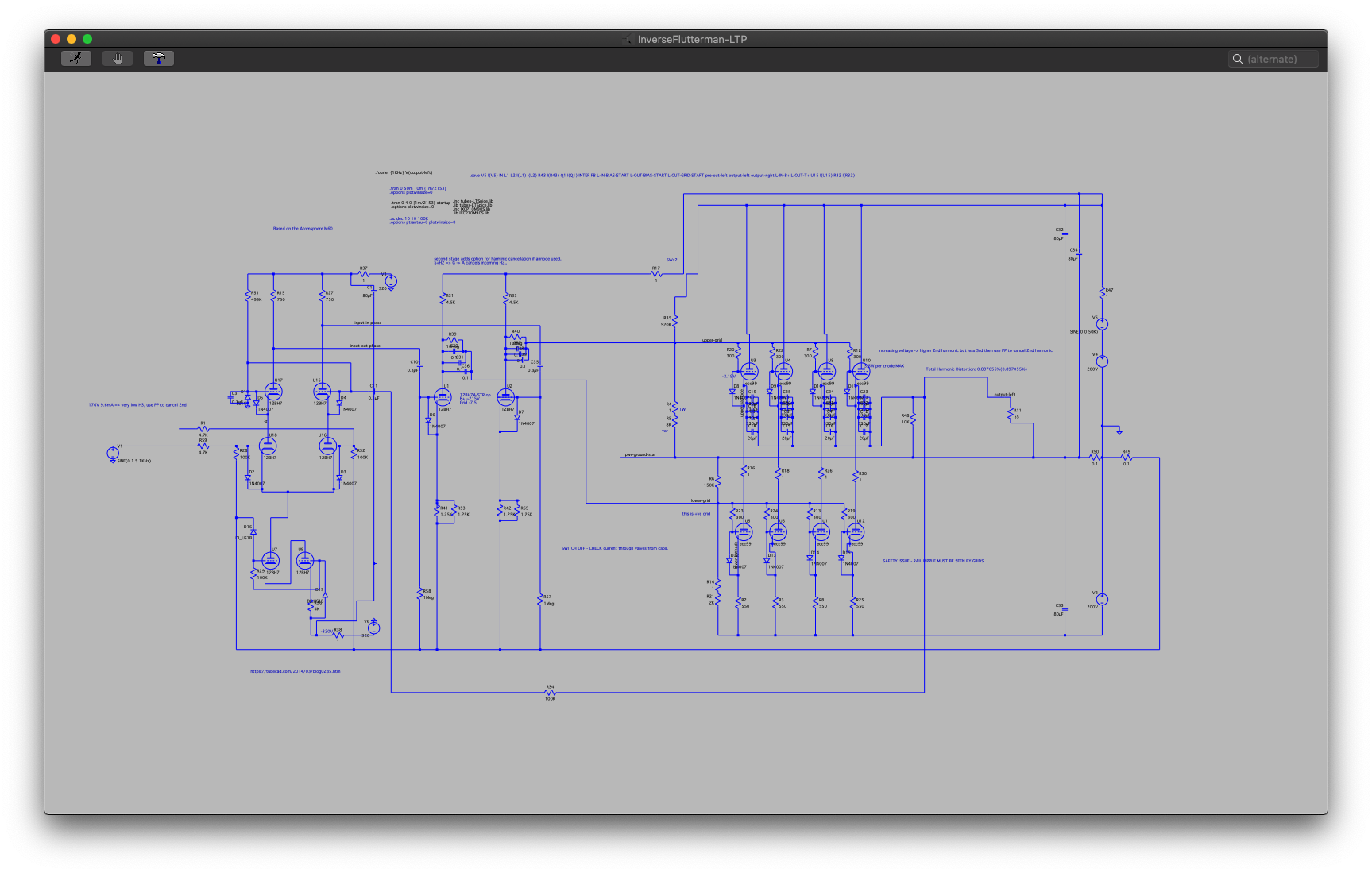

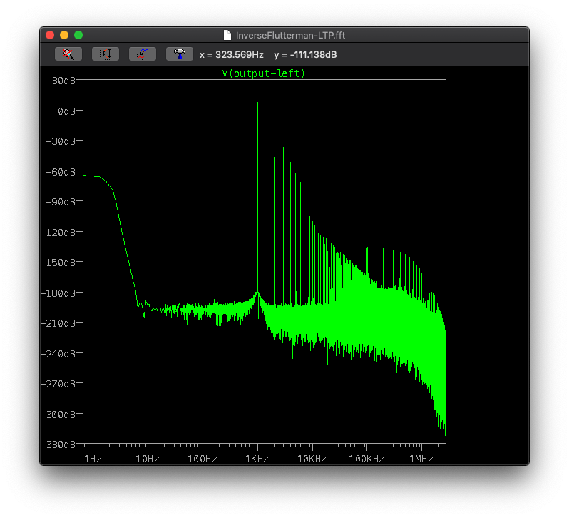

So.. version 1. I still have the V2 tube-direct digital amp/hpa in design but circling back for v1.. I've taken some of the learnings from the design work for the direct digital amp, specifically the bode plot and focusing on the bandwidth and phase - this is why it has caps in parallel for example.
The design originally started with the Broskie (tubecad) single ended OTL headphone amp class A, this is a decent design but modelling showed a few little gotchas for inputs with over 1V, plus I'm not very keen on the 12AU7 thus the change for the more linear 12BH7A. However I wasn't too happy and low and behold the atmosphere M60 seemed like an interesting design.. so modelling showed it's very clear benefits (at the cost of more tubes) and thus the hybrid Atmosphere M60-Broskie OTL HPA (now in PP format) appeared:
Each channel has four 12BH7As on the front end and four ecc99s on the backend. (note: minor correction the 0.1F should be 0.1uF and with a 5-10uF also in parallel)

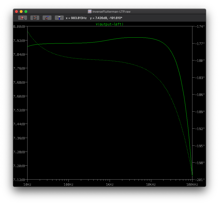

Bode plot at the output shows the amp's bandwidth.. VHF anyone?

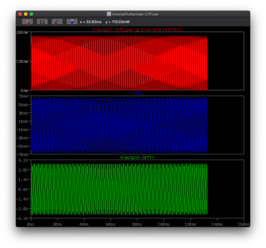

And the output power into 55 ohms but it's equally happy driving 32 ohms from the sims:
There is a piece of work to tune for 3rd harmonics reduction which all come from the untuned ecc99 backend and selectively adding in LPF grid stoppers to prevent the amp from going into HF/VHF meltdown. The output here is with 1.5V 1kHz input:
So some twiddling required but I suspect that will reduce.

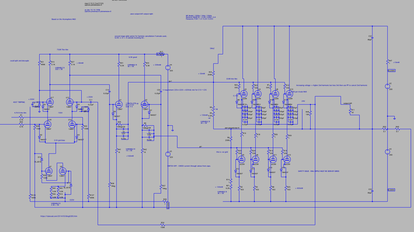

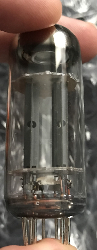

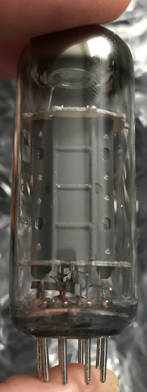

I should also make the point that looking back on the M60 front end I can also see why the benefits appear.
* differential from the start - why not, this presents a good opportunity for PSRR but at the same time normal cascode PSRR is pretty poor. It also allows both single-ended and balanced input which is a nice to have.
* the cascade reduces the miller effect on the first input tube increasing bandwidth. The gotcha is the high output impedance, elevated heater requirements and bigger B+/B- rails on the front end. The single pair of drivers is required for this reason - in the normal design the output is taken from the low impedance cathode side, typically because the tubes used (6sn7) support a good transconductance and maintain a higher gain over all. The 12BH7As aren't like that so we switch to use the higher impedance but higher gain anode side output. However they do have enough oomph to drive the ec99s without throwing their toys out of the pram - this means they can drive the reasonably high capacitance.
ecc99s well they're uncouth driver beasts. You could switch those drivers to be ecc99s if you wanted more current to drive.

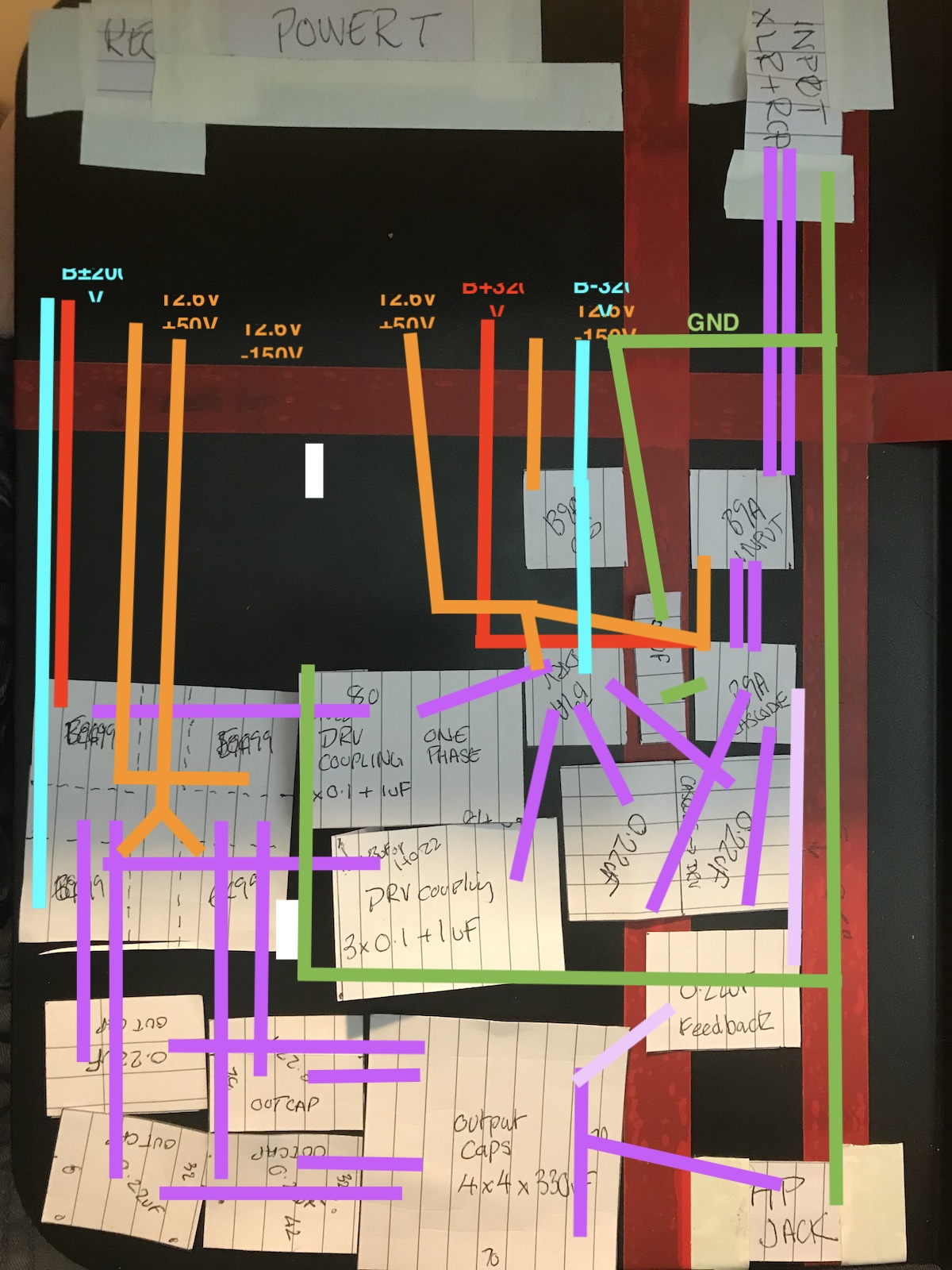

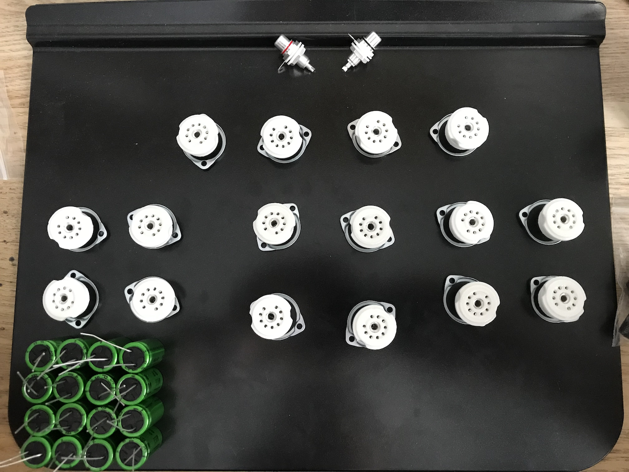

So V1 is progressing as I can. I've been looking through the different options (mallory, sprague, Panasonic, Wima, Mcap, auricap, etc).
I will be using the following given I have a number in parallel the prices can/do mount up quickly hence going for an option that is likely to be more reliable:

Just been playing with the final model tuning - I found a bug in the LTSpice model (a copied label between the channels added recently).
So far I've had this modelled at 0dB as a unity buffer and now modelled with 3.16V input giving about 2W with 16Vpp at ±240mA max output (8dB gain) - enough to fry headphones (the tubes output maxed out) with some NFB.
The amp's purpose isn't to be a gain monster but it shows that the front end can be tuned. I could switch out the 12BH7A for something with more than 17 mu but this will do.
So I'm happy with the capability and how easy it can be tuned.
Switching to paper cut outs I’m targeting a 17” wide, 14” long and 5” deep.
The pan is smaller, but large enough to model the front end. The jack is in the centre of the target case.
I’m attempting to ensure that the power corner is kept clear and attempting to get the large PP film caps in between the tubes.
Current layout state of play
I've rotated the pan 90deg as this gives me 14" depth, I can then mark out the three red lines of - the centre line of the amp (at 8.5" wide) and then the 9" inc from the back where a hammond mesh box could sit across the amp. Behind that line is where an upper box sits that holds the vertically mounted transformer and smoothing caps.
The last red tape line is the 'quiet corridor' where large current flow and higher voltage lines are kept away from.
The red lines are the B+ lines, the cool-blue are the B- lines. The orange shows the heater lines - one at about 50V and one at about -150V to provide power - I may need another voltage level.
The violet shows the signal path flow for the both phases.
Lastly the green shows the ground line. The headphone output is for single ended (ie shared ground). If balanced output was to be used, more design work would be required - so for me this is not required.
The concept here follows:
1. the power supply is kept in the corners.
2. The input RCA, input shielded cabling, input valve and cascode sit in the quiet area.
3. The drive (DRV) valve sits just outside - this allows the power rails to be easily supplied through to the cascode.
4. The amplified output passes through the decoupling caps towards the ECC99s which sit close to the side of the case - this allows high current in wires close to the side of the case.
5. The amplified output then flows via the output caps back to the front centre.
6. The feedback is driven directly off the output caps output and then loops back via a shielded cable to the cascode.
My only concern here is that I have a large loop - as the signal return is through the centre of the amp.
In reality there's a 5" chassis depth, so I can reduce the 2D real estate by making it more 3D however that has other issues such as blocking of cooling. However I suspect that the final deployment will see the set of ecc99s move towards the centre a little.
The other point is that I have made a 'compromise' that I've switched from 3x0.1uF + 1uF for the driver coupling to simply a 1uF+0.22uF. This doesn't model much different in terms of a bode plot, it will be using the hyper fast FKP1 that has both metal foil and deposited metal plastic film in series to increase the performance (lowers ESR). Plus it reduces the size physically and with the added bonus that 0.22uF is basically the most common capacitor in the amp thus we start seeing volume cost savings being above 10 caps.
I still have to work out where I can put the variable bias pots, volume pot, muting relays.. so we're not finished yet. For example if I have the lower ecc99s closer to the back, then the dead space can be used for the bias pots.
It should also be noted that I have one input RCA or XLR balanced but a single ended output headphone jack. If I wanted to have a balanced headphone output there would need to be some additional design work (not to mention additional hardware).
Tracing the main DC HT electron flow (white arrows) that flow from B- (blue) to B+ (red) rather than via the 0V ground as a return:
The B+/B- I'll twist together, I'm not sure I need to twist in the 0V ground used for the cascode grids.
The cascode is connected to the 0V-GND for the grids so virtually no current flows.
In terms of signal current. The cascode signal piggybacks the DC current flow until the cascode-driver decoupling cap. The cascode is kinked to keep the input DC current (from the CCS) at 90deg, the input to cascode at 180 away from the input and then the driver at 90 to keep it's output away from the output cap/headphone jack.
The main output stage drive signal currents are contained within the output tube stage and flow to the output caps.
For the build I think the output caps and bypass caps will be stacked in 3D so in reality the output signal will terminated in the corner, then shielded cable takes it to the headphone jack and feedback point. This stacking should be fine - it allows me to put space between each cap too for cooling.
The single ended headphone out means there's one common AC-signal return on the 0V-GND for the headphones.
The heater wires in the diagram are complex. Initially a AC twisted pair running 12.6V for low current noise but there are several independently referenced against the B-/B+. Not shown in the diagram but I intend to ensure they're kept shielded against the chassis as much as possible. I will probably run these as regulated DC in the future where twisting is still a benefit.
At the moment I'm considering the effect of few things. The tube geometry in terms of heat radiation given there will be a bank of 8 tubes at the back. There's a multi-way trade off here:
a) heater wires minimised as much as possible
b) minimising the signal grid connection and decoupling
c) internal radiation so that the closest tubes are only showing the smallest amount of heat radiating components - this is especially important for the input and cascode tubes. The second channel is not that far away. I could put a matt black copper screen between the two channel cascodes stacks. Heat radiation is dependant also on distance, the radiation falls at radius^2 so the more distance the less heat.

There's enough wiggle room so that adjustments on the cathode resistors for bias mA tweaking so that they don't exceed the limits - with B+ or without B+ applied, however they're referenced to the B+/B- anyway.
* Rationalisation of caps to use FKP1 0.22uF, 1uF and MUSE ES 330uF. I can adjust these to multiple 0.1uF at a later date but there's very little impact and with over 10 there's a volume discount. A MINIMUM of 630V is required given the differences between some of the decoupling.
I have found a 100mA panel meter - perhaps not the most accurate but I'm tempted to add one for biasing. An alternative is to use a three LED system to indicate when it's within a 1-2 mA of the value. More accurate options are £100+ - there's a few Hoyt meters that I like the look of too.
Only issue here is that it's unclear of the isolation voltage limit on the panel meter - it may measure a small relative difference drop across a 1ohm resistor, however that small drop is sat at -280V for the cascode.. Internally that may arc to the grounded chassis..
Lastly - for £34 I found a neat IEC+filter+switch+fuse all in one which is tempting.. Neat, tidy and being schiefer it's an OTS.
I'm currently running around looking for quotes for the transformers, the amp needs:
160-0-160 600mA - fully rectified gives 226V so enough for a regulator drop and some current wiggle room
240-0-240 100mA - fully rectified gives about 340V so enough for a regulator drop and current wiggle room
Two 12.6V supplies - these need to be referenced to +50V (3.4A min) and -150V (2.4A min) accordingly, so isolation needs to take account of AC to -150V reference. For these I will use separate heater transformers. Also the heater wiring needs to insulate between -150V and anything else around it (0V chassis or +320V B+ should it come into contact).
Wiring for this amp is not a 300V insulation jobbie.. 600V minimum between conductors and earth, preferably 1000V.
So some changes/corrections:
* The driver section was attempting 520V across.. at some point I'd switched this over when playing with PSRR. It's now 320-0 not 320-320.
* Switched the driver output to cathode (actually this is the same as the m60) as I don't need the amplification - I'll leave that to the cascode. This makes it a low impedance output into the high impedance PP grids. This also improves distortion.
* Heaters are now rationalised as: +50V and -150V to cover the entire amp - this stays within the design limits for the 12BH7A heaters ( H>K+100Vac/200Vdc and K-200Vac/dc<H) but also the ecc99s (±200V limit).
Complication here also for the heater supplies on start up and shutdown. It's possible to have the reference voltage on one side of any smoothing caps and 0V on the other. Therefore we can't use 50V caps but we need larger voltage caps..
For the panel meter it may be that I need to make a isolated opamp with an optical isolation.. more complication..
