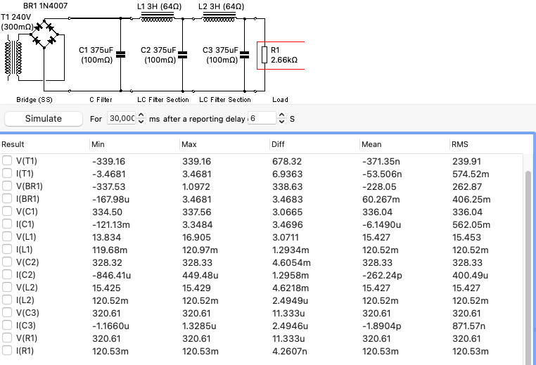

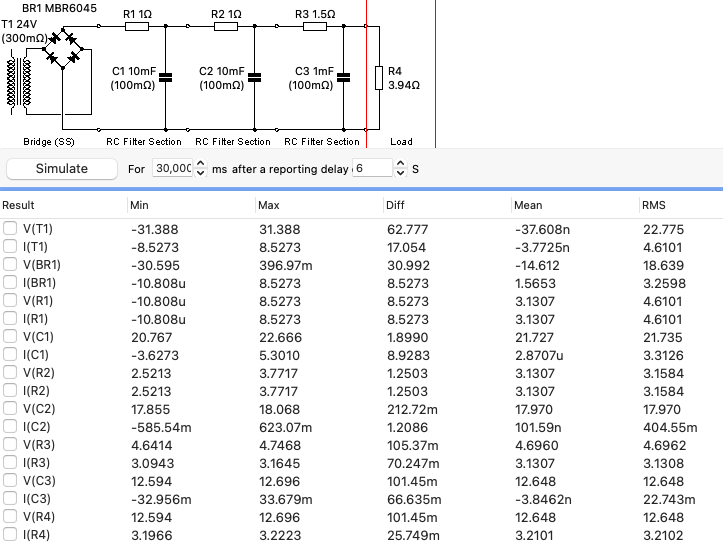

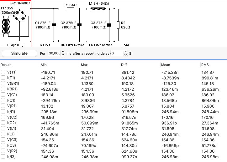

I've proposed that the power is provided by three transformers:
T1: provides the 2x320V front end rails as 2x240Vrms secondaries - choke+cap filtering
T2: provides the 4x155V circlotron rails as 4x135Vrms secondaries - RC filtering
T3: provides the 3x12.6V heater supplies as 3x24Vrms secondaries - RC filtering
This makes the assumption that the circlotron cathodes are kept within 200V of the single heater supply (I'm not doing individual heater supplies for each tube bank).

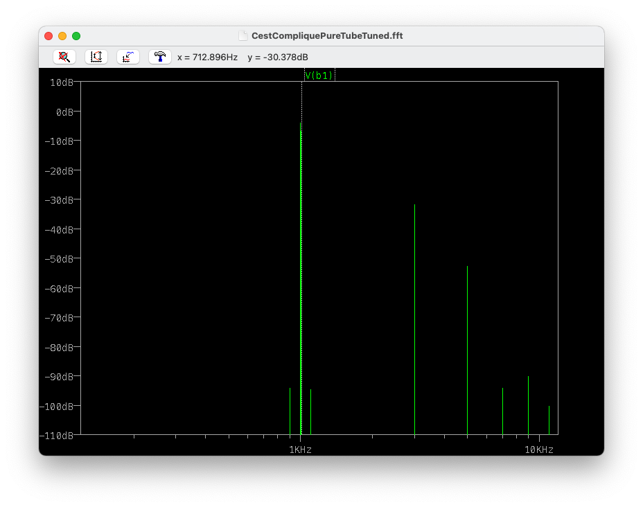

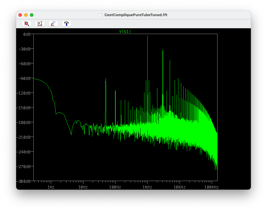

Finally had the time to sit down with a pen, paper, with the calculator whilst watching TV with the Mrs to work through the tuning on paper from load to inputs, calculating all the maths by hand rather than tweaking in LTSpice.
The result from plugging in the values this morning seems very promising:
EDIT: just spotted a 330ohm set of grid stoppers I missed...
You know when you do pen and paper, never go back to an existing LTSpice :/

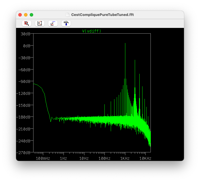

It appeared that my 320V lines were running at 270V thanks to some playing with transformer experiments.
I'm still getting a hefty odd harmonic output from the cascode (the image above is amp output).
I figure that this may be down to the tube CCS that is about the only thing I've not really paid much attention to in properly tuning. Specifically how well it copes with fluctuations (ie waveforms) vs what it looks like at a static level.
I think I have the grids too high and the voltages across them are too low - demonstrated by the third harmonic production (I think).
It's also occurred to me that I want more than 32mA from a 2.86Vpk input so I can turn down the volume - so perhaps tuning for 1.5Vpp input to 32mA. However for now that will do.

The amp output (at the headphone) is still not perfect with input at 2.86V.
I have the front cascode down to (at 3.16V input):
Code:
N-Period=1
Fourier components of V(vdiff)
DC component:-4.17573e-10
Harmonic	Frequency	 Fourier 	Normalized	 Phase  	Normalized
 Number 	  [Hz]   	Component	 Component	[degree]	Phase [deg]
    1   	 1.000e+3	 2.880e+1	 1.000e+0	  179.98°	    0.00°
    2   	 2.000e+3	 1.174e-8	 4.075e-10	   76.88°	 -103.10°
    3   	 3.000e+3	 8.513e-2	 2.956e-3	    1.56°	 -178.42°
    4   	 4.000e+3	 3.051e-8	 1.059e-9	  149.94°	  -30.04°
    5   	 5.000e+3	 2.558e-3	 8.883e-5	 -176.00°	 -355.98°
    6   	 6.000e+3	 7.782e-9	 2.702e-10	  -19.61°	 -199.60°
    7   	 7.000e+3	 1.358e-4	 4.716e-6	   -3.73°	 -183.71°
    8   	 8.000e+3	 2.034e-8	 7.063e-10	  -63.43°	 -243.42°
    9   	 9.000e+3	 1.369e-5	 4.753e-7	  175.99°	   -3.99°
Total Harmonic Distortion: 0.295689%(0.295689%)

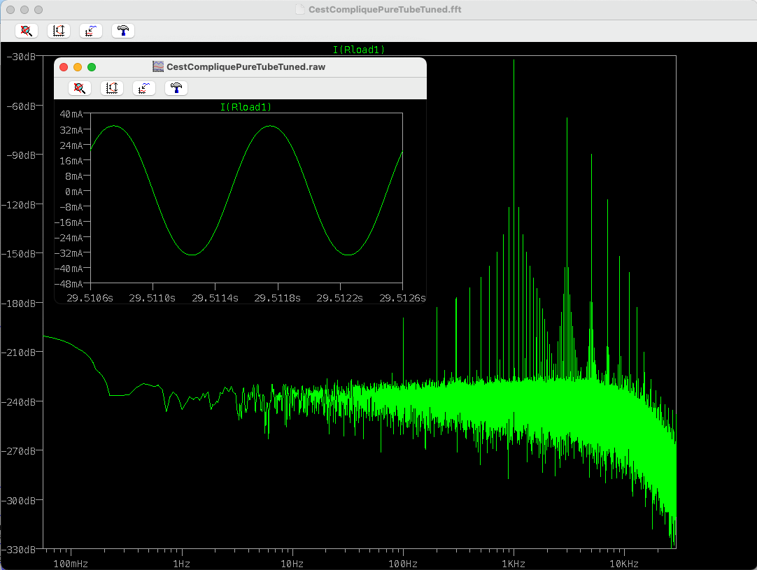

I need to look at the driver input (which is the problem) and retune that again.
Previously I'd treated the cascode as two triodes and avoiding treating it as a pentode. Merlin's pages on pentodes (rather than cascodes) has some additional points around setup and configuring - the result is that I've been running the upper triode grid at 160V rather than use the load lines and map out the pentode with g2 being about 80-100V max. The piece I'd missed - is the bias resistor that could do with a little tuning for the G2 bias too, in addition to the diodes. When the voltage is low - this causes problems upper bias (and also the upper bias of the lower CCS pair of triodes acting as a pentode).
The main issue is that running at a good Iq operating point causes issues for the CSS triodes when trying to use a low 3rd harmonic operating point. This low H3 means that a higher even harmonic can be cancelled out leaving a lower overall THD.
The pain.. is that it typically means high output (Ra being high hence 80+Vpk). which the drivers don't like thus it needs scaling down for the driver input. Not a biggie but just means a voltage divider to scale the voltage down.
The current driver stage tuning gives the following differential output:
