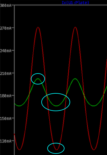

Just been inspecting each of the wave forms for different areas of the circuit. Observations:
* U7 and U8, are showing a very very minor clipping - top and bottom at the tip of the wave, so this looks like a source for the odd harmonics. They need attention anyway as the bias is running at mA levels that would blow a tube (over 2x).
This is the obvious first port of call to tune again - every time I tune the front this needs tuning..
* the line near C6 in the servo is showing a faster slew rate on the from of the wave than the back of the wave. This is suggesting (a) phase and (b) the capacitor is holding too much charge/saturated so is slowing the slew rate. The output of the DC servo feeds the grid of the output on one side - thus this noise/problem is likely to make a larger impact (uncommon amplified) and not be cancelled out.
Not the immediate priority but one that is definitely on the list - possible solution is to inject the AC noise but not the DC bias to the other channel. Thus both would have noise and would cancel.
* I was wong - the sim had a non-connected grid and therefore one grid was showing nA and other was drawing 19mA through a 6SN7 - and the magic smoke would escape again. I'll reset this for the next run.

I've removed the cross cancellation from the first stage, removed the servo and bias system from the 6AS7.
This is running with ±300 on the front end, push pull 0-120V on the backend. This seems to help the issue with the capacitor variation. I did look at a folded cascode to keep to 0-300V but the other option was drop -300 to +300V.
I know that the front end isn't being linear at the moment and it's pulling 15mA not 10mA, so needs a little work but the output seems nice.
Even order - the wave form is non-symmetrical, ie looking like an egg. This is down to the use of the tube. A bit of tuning of the front end.
Odd order - the wave form is symetrically being distorted such as clipping top and bottom.
High order - caused by cross over such as a DC offset in the push pull.
NickKUK
