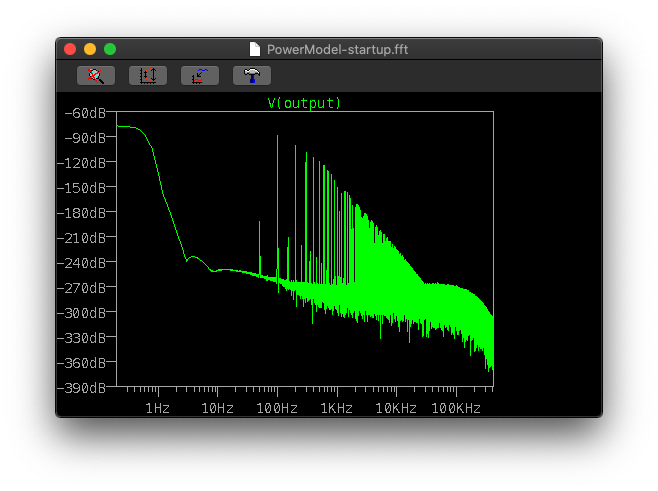

I've been hard at work simulating but with all four ecc99s at full 60mA the system sucks 560mA (maximum peak-to-peak) for all valves.
I've been trying RC filters, however the 300ohm voltage drop drives up the transformer power requirements for a 200B+ rail. I've managed current etc to the maximum draw of some of the candidate power transformers I have identified (including startup), but all cause issues so far. So I'm now looking back at the LT3080 LDO Maida/Christian option to see if it can be modelled with less drop out.
Three RC filters in series (300ohm with 470uF) gives a lovely output with low ripple but the voltage drop and power loss is horrendous.
I’ll need to confirm this but the LTSpice transformer getting hammered AC 5A at 220V peak.
Average p=iv where i = Ipeak/sqr(2) and v = Vpeak/sqr(2)
P = 3.53 * 155 = 550W average.
Although the 540mA is probably red plating and melting tubes, 550W is a bit nuts.
Instant power is 5 * 220 = 1100W which seems I’ve not got the model right.

The secondary/transformer reserve capacitor soft start is working, but just need to tune it increase a little slower so the current draw is reduced a little more.
So a 61GB run of the power model:
Top is the input into the VR, and the blue is the secondary winding current. The red is the input into the VR.
The large reservoir cap inrush current is smoothed down from 14+Amps to 6A, I can possible smooth this further, I'd prefer to get this to 1A or less.
If you use the below careful of the grounding. It works by first following the positive up and the mosfet follows it up so the drain of the mosfet raises to B+ first. The mosfet gain is positive, same as the source and so the mosfet starts conducting and the output drifts down to zero. If you ground this and leave the output floating, the ground in the amp will jump to 240V before foating down to zero.
As it stands it copes with the 450V 4 or 6mF large capacitor - I just need to get around to smoothing the time it takes for the mosfet to start conducting. For this brief period it it can probably cope with the current but the transformer may not.. that's next on the hit list. Getting that inrush spike to under 1Arms.

Now I can inrush limit just using a simple tuneable design:
This simulates a flat reservoir and a hot set of tubes (thus current draw could occur immediately as the B+ rises).
The result:
Centre - blue and green are the load voltage and current.
Bottom - current draw for the secondary - this is AC (red) and current limiter output (teal).
Top - power dissipation is AC so not as bad as it looks:
This is probably around 30W dissipation but still quite a large amount.

Went back to the maths on the inrush.
With ten parallel 2Kohm 50W chassis mount resistors (equivalent of 200 ohm), I can get a max load of 50W on them during the startup with an initial Imax of 1.6A on the first cycle and then dropping off as the cap charges.
I calculated a 5RC time of about 11 seconds with the AC supply, so let's see in the simulation.
This simplifies and, to be honest, I think this with a single switch rather than having to attempt to time 4 or 5 switches just to get a higher current to shave of a couple of seconds is not worth the hassle. If the system can start in 10-15 seconds that fast enough.
