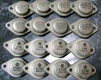

Hitachi`s lateral MOSFET die design is thirty five years old
For the sake of historical accuracy.
Originals at the top, the HS8401 and HS8402 were manufactured in A, B, and C versions.
The first Lateral Mosfet power amplifiers are from the late 1970s : Lo-D/Dynaharmony.
Hitachi issued a piece of paper in 1984, but the technology was older.
