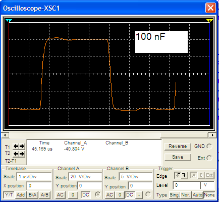

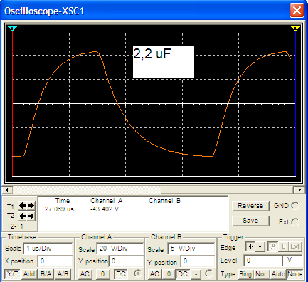

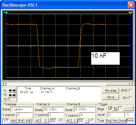

I simmed it with 10 nF, 100 nF and 2,2 uF parallell to the load. Pics attached.

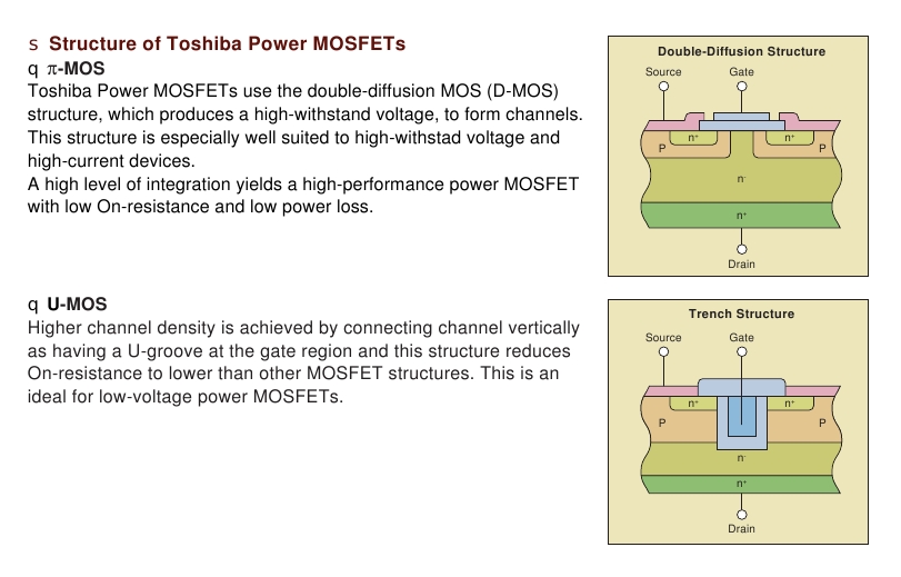

this is from the toshiba data book. "pi"-MOS is lateral, u-Mos is vertical
According to the pictures, both pi- and u- are vertical MOSFETs. Here's the lateral MOSFET and a brief comparison:
http://www.fairchildsemi.com/an/AN/AN-558.pdf
The diagrams are conceptual only, but you would of course note the lateral P type substrate (actually connected electrically to the N source) and the vertical N type substrate, electrically the drain. Which also explains the different pinouts of lateral and vertical devices. The center pin is always connected to the substrate and is the source for laterals and the drain for verticals.
