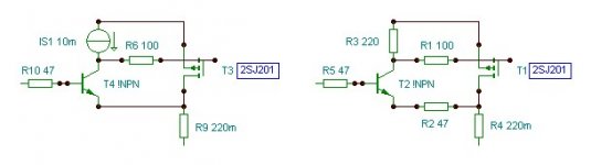

Rikard,
we can anticipate pretty high distortions in this amp, primarily in the output stage due to a too low quiescent current level and lack of mechanism for linearizing the numerous constantly varying parameters, further worsened by the load, but it´s not convenient to work with this kind of PA-style approach, power dissipation complicates an appropriate type selection and biasing of the plain transistor stages.

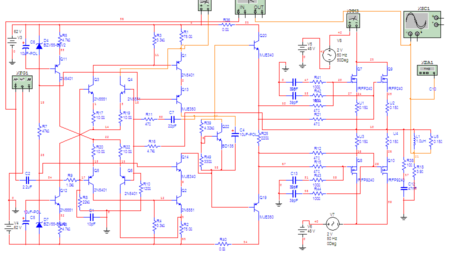

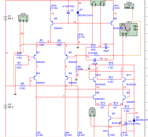

Thanks for the confirmation Bob, I know several high quality amps that use these so that wasn´t a hard decision to make. How to improving the distorsion figures is what puzzles me. The speed I think is ok now, so that leaves me two choices really, have another go with error correction or try something completely different, like CFP style output. I did som sims, but this output ended up with 5-8 times higher THD. Could be down to me not having worked with this kind of outputs enough. I have built a better prototype now however, so the EC network might work better than the last attempt. I simply could not get it stable. But as it sims so beautifully I would love to get it working. Distorsion certainly drops in the sims when I use EC.
Rikard,
I agree with you that the output is the main source for distorsion, and I have nothing against running it at a fairly high bias, but it would still be nice getting the distorsion down in a smarter way. It isn´t bad now either, but anything could be improved of course. Initial CFP sims turned out to be a sure way to much higher distorsion, so I dropped that idea. If somebody knows a really good CFP output topology I´m willing to try it for real. I can measure distorsion fairly accurate so once a prototype is built we will know right away which version is better.
Hi Rikard,
I do not recommend you use a CFP output stage. They can have serious stability problems and they sometimes cross over too abruptly - this applies to BJT output stages as well. This is an area where Doug Self and I do not agree.
I don't remember your schematic, but in general, if you are building an amplifier less than 150W 8 ohms and will not be abusing it, use two pairs of the Toshiba MOSFETs and bias each pair at about 150 mA (300 mA total class AB bias). If the rest of your amp design (IPS, VAS, drivers) is good, and your NFB gain crossover is, say, between 500 kHz and 1 MHz, and you have it stable in every way, you should be able to do better than about 0.03% THD-20 into 8 ohms (without EC) with fairly conventional feedback compensation.
Bob
Rikard,
I do warmly recommend the CFP output, FETs do not suffer from minority carrier saturation like BJTs in class AB. Stability may be a problem. You could contemplate these possibilities. All resistor values are subject to change, some of them need to be determined empirically.
Hi Rikard,
Bob

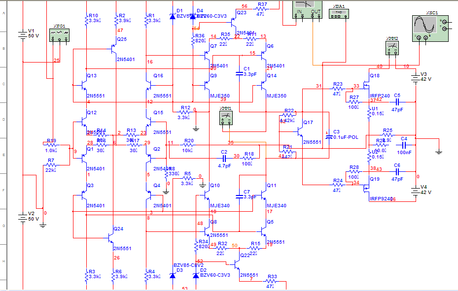

Thanks Bob, sounds pretty much like the amp is at the moment. The schematic is a classic dual diff input, very simple VAS and driver finished with two pairs of Toshiba´s (stabilized using your brilliant gate Zobel´s! 🙂 ) which I by the way had some trouble matching for similar bias. I guess that would affect distorsion too as the non linear area is supposedly wider, right?
The sims are done using the IRF devices though, I don´t have the Toshiba´s in my database. Too bad!
Are there any other major tweaks that can reduce distorsion? Like cascoding something more than the VAS. I tried simming the input and VAS only and actually read higher THD than with the output involved. 😕

I do not recommend a CFP output configuration; there are no universal recipe to keep it stable. The amateur DIYer usually ends up patching caps here and there, the end result being usually worse than what you get with (e.g.) a Locanthi triple configuration.
syn08,
I like when you are watchful. Of course, "minority carrier saturation" is a meaningless expression, saying excess minority carrier concentration, causing saturation cut-off problems, hopefully, would have been closer to the truth.
It is possible to achieve sufficient stability with carefully chosen devices. I agree, patching caps here and there is a serious setback, whereby some (or most) of the advantages of this great configuration are lost. So using BJT slaves in class AB is not adequate.

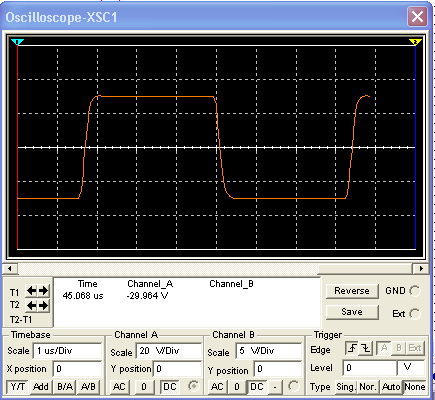

Just playing around with some sims again. This input/VAS topology looks like a better one compared to the "old" one in this thread. The thought is to combine this with the J201/K1530 output stage later once I get it stable. Problem now is I can´t find the cause for oscillations, the common cap in the NFB loop won´t help.
Feel free to come up with a good solution! 😀
common feedback cap isn't a good solution for oscillation anyway. try compensation caps on Q8, Q9. also double check and make sure the circuit isn't inverting. it looks like it is

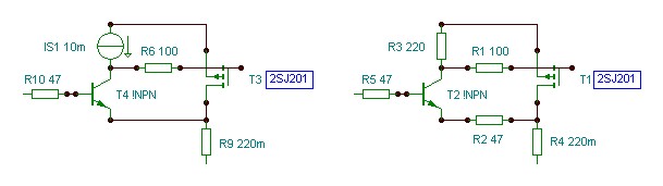

Low Threshold effects at higher power Class AB
Hello Syn08 and Bob,
Regarding my earlier post a few posts back about using the lower threshold types of 2SK1530 etc (O grade) was I wondered if they would have "less discontinuity" in Class B at the crossover region.
In Class AB at 150mA Iq this probably isn't a issue at low power but as it moves to high powers in Class B I wonder if the lower threshold would help ?
Laterals are a bad example (whilst having low threshold) as they have lower gm than Verticals to start with - so this isn't a fair comparison THD wise.
PS. Are you saying that the sub threshold conduction takes care of this regardless of the higher threshold ?
Apologises if I don't understand. Just trying to learn.
This is a very good description. I guess what you mean by "transconductance mismatch in the crossover region" is actually the subthreshold (exponential) mismatch. This mechanism (actually the subthreshold conduction slope gap to the theoretical 60mV/decade) is of course independent to the threshold voltage value as well.

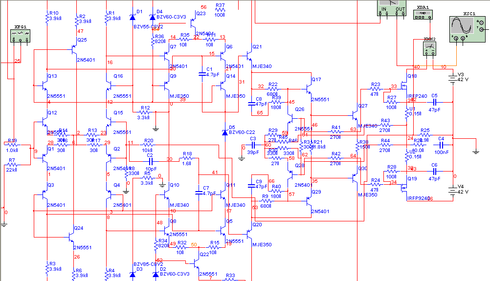

Don't you need some kind of buffering stage between VAS and OPS with regards to the capacitance of the MOSFETs? Or maybe a cascoded OPS?Here´s another version with everything cascoded for maximum speed. I added a full differential VAS for lower distorsion. Suggestions appreciated! 🙂
There is the entire error correction network between the VAS and OPS so I don´t understand what you mean?
I did try the VAS directly to a standard OPS with very good results too, so if the bias of the VAS transistors is cranced up to let´s say 25 mAs or so it works very well.
