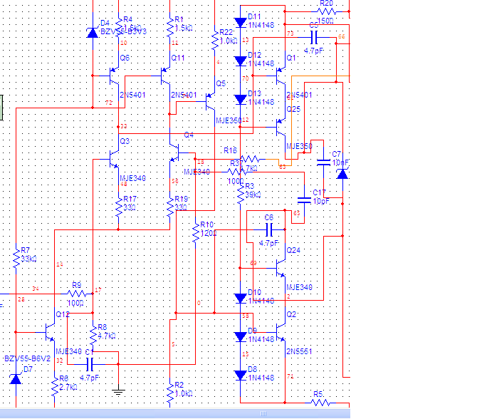

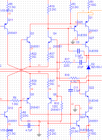

Here´s a slightly simplified VAS with a single transistor balancing the cascoded VAS output. (Q24 and Q25 are new) This way, it is still a fully differential config, but simpler. Still, the distorsion figures look really good imho, but as usual I cannot get it completely stable into capacitive loads.

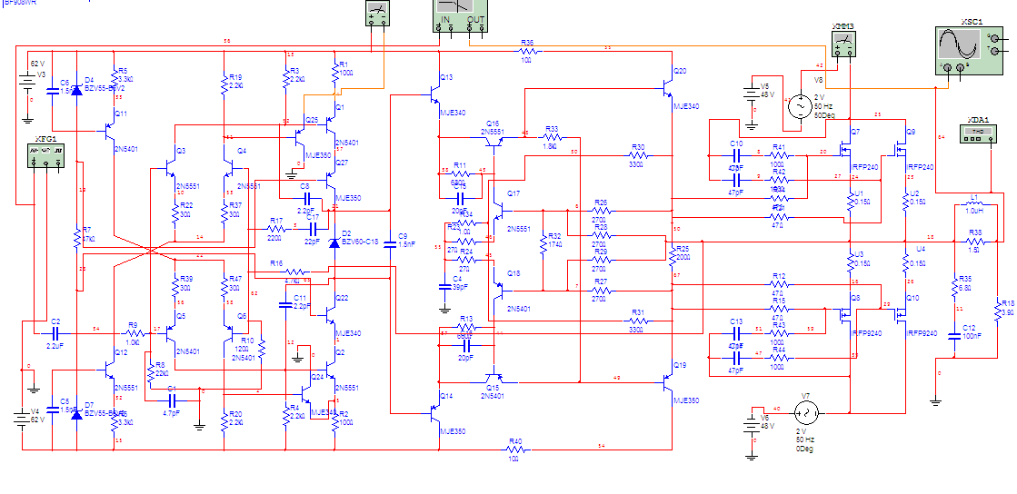

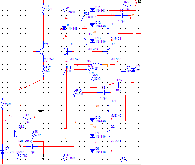

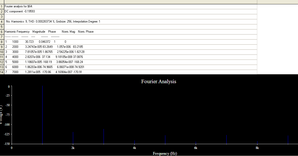

Latest updated schematics. The addition of Q24 and Q25 alone clearly reduced distorsion. What I don´t like is the tendency that odd overtones seem to consistenly remain higher than the even ones. At least in sims, but this might not be the case in real life. The fourier analysis was simmed with an 800 mV 1 kHz input.

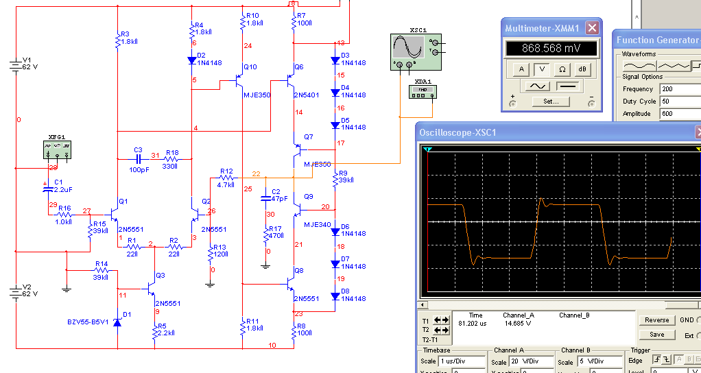

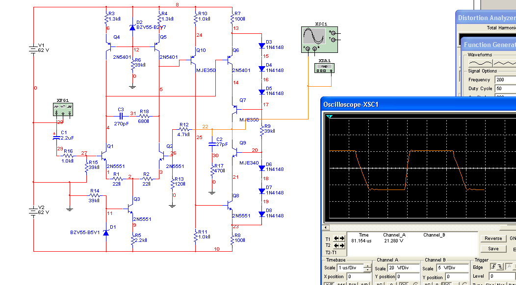

So, my "investigations" go on, and having been inspired by the Mongrel thread, and particularly the Luxman schematic mentioned there (Hawkford style cascodes), I have started simming an updated design of the amp. Basically, the same Cordell OPS is used, but a slightly modified front end is used now. I tried replacing the two resistors loading the diff amp at the input with current sources, and this lowered the distorsion quite a bit, but a drawback is that if I look at a 200 kHz square wave the upward flanks are much slower than the downward ones. Anybody who can come up with a solution for that?
Pic 2 is the current source loaded version, and Pic 1 use resistors and seems to perform brilliantly.
Comments appreciated!

Here are two better pictures I hope, just the front end. Version one has CCS loaded diff amp outputs but suffers from uneven slew rates for positive and negative flanks. Cannot figure out why. The resistor loaded version is much more even but cannot reach as low distorsion figures.

i noticed you have no compensation caps. you could "tweak" the slew rates with compensation caps. i've also seen current mirrors used, not only to linearize the diff amp, but to insure both VAS devices are driven by the same currents, which also seems to match the slew rates.
i see the first one has slew rates of 67V/uS(- slope) and 100V/uS (+ slope). these slew rates will probably be faster than you could hope of driving the amp within the audio band. the negative slope aldo looks like it has a bit of "hangover" from a device coming out of saturation. the device that's saturating is probably also the reason for the slower slewing.
