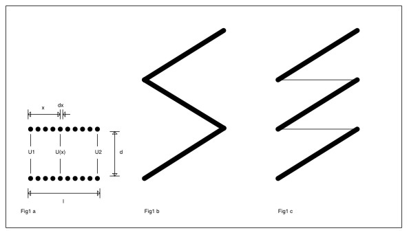

Tip#11 Z Winding
As we seen before, capacitance between two adjacent layers, each one supposed as an equipotential surface, is given by
Cl ≈ (ε A) / (4πd)
Where
ε = Dielectric constant of insulator [cgs] dimensionless
A = Average winding area [cm²]
d = Insulator thickness [cm]
[C] = cm, 1cm ≈ 1.113 pF (cgs units are better!)
attachment.php
Suppose now two adjacent layers as seen on Fig1 a, the voltage difference at a point x can be written as
U(x) = U1 + (U2-U1) (x/l)
The capacitance of a small element of wide dx and long lm is
dC ≈ [(ε lm) / (4πd)] dx
The energy stored into this capacitance element is
dℇ = (1/2) U²(x) dC = (1/2) [(ε lm) / (4πd)] [U1 + (U2-U1) (x/l)]² dx
Then
ℇ = ∫dℇ = (1/2) [(ε lm) / (4πd)] (l/3) [(U1)²+U1U2+(U2)²]
Or
ℇ = (1/6) [(ε A) / (4πd)] [(U1)²+U1U2+(U2)²] = (1/6) [(U1)²+U1U2+(U2)²] Cl
Referred to a voltage U, we can write
ℇ = (1/2) Ce U²
Then, the capacitance between two adjacent layers is
Ce = [(U1)²+U1U2+(U2)²] Cl / (3 U²) (*)
For the special case where the voltage between layers is uniform, U1=U2
Ce = (U2)² Cl / U² (**)
For the usual U winding as seen on Fig1 b, the capacitance between two adjacent layers, when U1=0, U2=2U/N, from (*)
Ce = 4 Cl / (3 N²)
Where N is the number of layers in a winding, then the capacitance of the whole winding is
Ctotal = 4 (N -1) Cl / (3 N²)
Or
Ctotal = (4/3N) [1 - (1/N)] Cl
Nothing new, but for the special case of Z windings, as seen in Fig1 c, U2=U/N, then, capacitance between two adjacent layers, from (**)
Ce = Cl / N²
Then
Ctotal = (N -1) Cl / N²
Or
Ctotal = N [1 - (1/N)] Cl
Then Z winding has 75% of the U winding capacitance, not to uncork champagne...🙄
Conclusion: Too much work almost "al pedo" (for nothing). 😀

Each time a wire crosses over each layer in the winding, a small bump formed, after N layers it became horrible, even more, it changes the direction of the fields, making them less homogeneous, unless you connect each layer outside the winding, anyway, a little bit thicker insulation between layers is more effective in order to reduce winding capacitance, e.g. 0.05 mm reduces interlayer capacitance by a factor 2, I mean passing from 0.05 mm of wire enamel, to a total of 0.1 mm. 😉

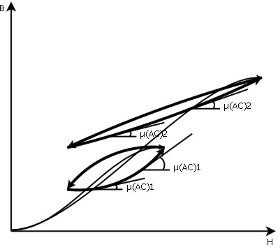

The old DOS Tango PCB, the grandfather of Altium Designer, is great to design PCBs, not to make other drawings, so the idea was to apply linear superposition principle to make simpler drawings, after all, physics doesn't change.
Emails from my friend Martin, and a long discussion with my friend Osvaldo, convinced me that my drawings are confusing. 🙄
His point was clear and overwhelming: most people are accustomed to see drawings representing reality in "real time", i.e. AFTER the vectorial sum that requires linear superposition principle, then my drawings seems bizarre and confusing.
So, I downloaded a program to make reasonably good drawings.
On post#234 has been roughly showed with numbers a guess made on post#231, and as I said before, an image worth a thousand words, mine worth only a hundred...sometimes less. 😀
attachment.php
The constancy of μ(AC) over a loop is a necessary condition to linearity, indeed, other approaches, as constancy of Lp, or magnetizing current behavior are equivalents.
Note1: DC magnetic hysteresis curve Bdc=f(Hdc) for each example, are drawn in order to not superimpose both loops.
Note 2: I strongly refuse to make another drawing. 😀
Bingo!
