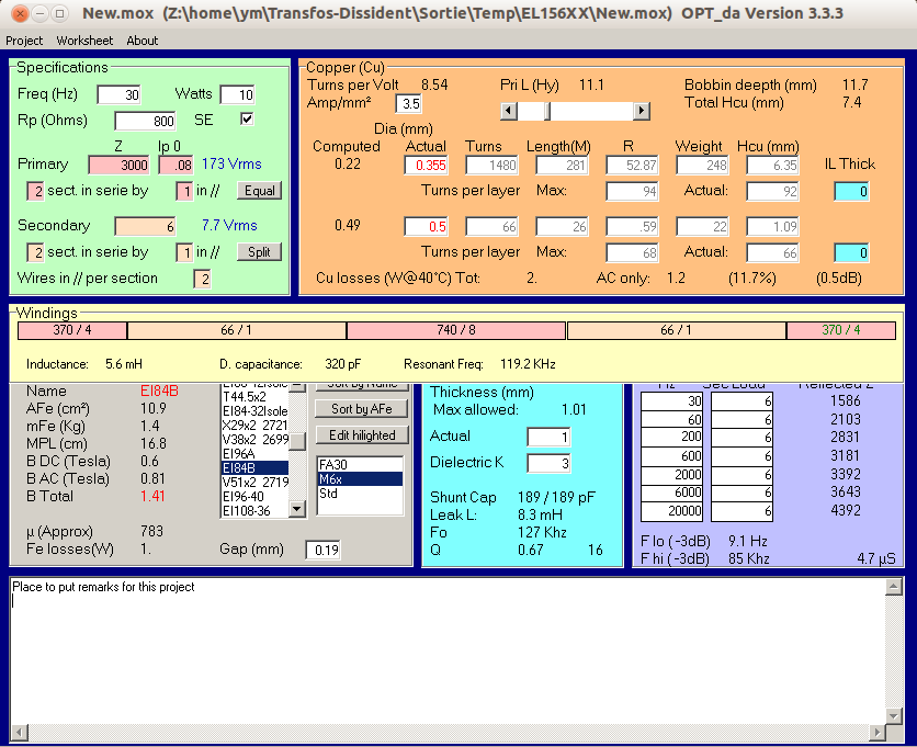

Showing just "BTot = 1.41T" picked from a part of my worksheet is meaningless as long as the power, the frequency and the DC primary are unknow.
BTW, the software does not impose any value even if it allows YOU to use what you want.
YOU are responsible for your choices.
"I'm not selling any alibies" 😎
If the nails are bent, don't blame the hammer.

On post#52 you put this
attachment.php
I don't need any alibis, that I can't understand is the numbers were put by you, not by me, and them was not my choice, but yours...🙂

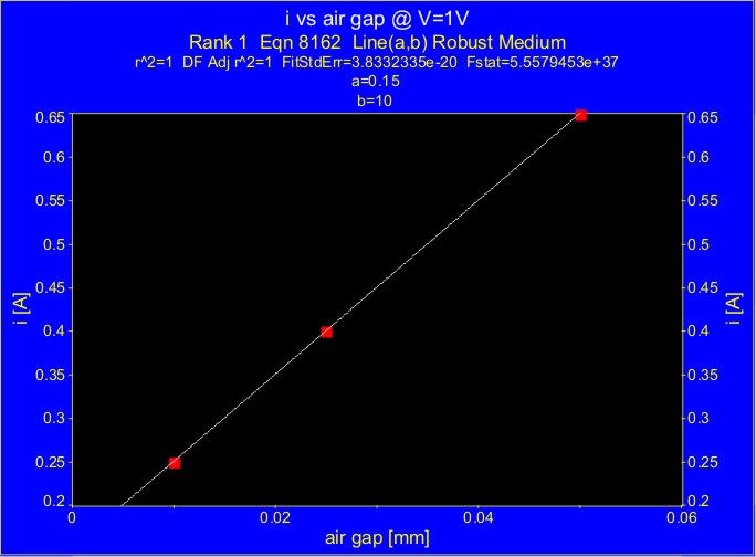

How meaningful is a plot of Iprimary vs Vprimary in assessing the capabilities of the core?
Bac(max) = (Uac x 10⁸) / (√2 π fo S Np)
Hac(max) = (4 √2 π Np iac) / (9 l)
Bac=f(Uac) Hac=f(iac)
Can this be used to determine the maximum usable Vprimary, when the primary winding is already in place?
Sorry, I don't understand your question, please clarify.

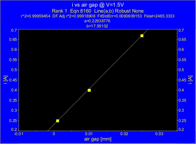

Then the rest of the world who run local field FEA analysis and represent flux density (in Tesla) throughout the core must be wrong....
Like this: http://pe.org.pl/articles/2011/9b/19.pdf
I strongly agree with that paper and their authors, even more, Fig.5 on page 3 (83) illustrate much better than me all what I have been saying.
Note that for an air gap = 0.001 mm, the field B is anything but homogeneous, Fig.5.(a)
For an air gap = 0.01 mm, the field B is still inhomogeneous, Fig.5.(b)
For an air gap = 0.025 mm, the field B only has very little inhomogeneities. Fig.5.(c)
Finally, for an air gap = 0.05 mm, the field B is quite homogeneous. Fig.5.(c)
That is what I have been saying from post#182 until now.
Core losses behavior, see Fig.6, is as predicted on post#323, and post#343
Conclusion
With an adequate air gap, μ(AC) is quite constant, magnetic fields are quite homogeneous, except H in the air gap as I said before sic "As for the fringing flux, the only region where is less negligible, is on the edges of the air gap"
As a consequence, linearity can be achieved.
Q.E.D.

Having read more carefully the paper, it is clear that transformer was used as a PP OPT, i.e. without a static DC field, the authors simply applied an AC voltage on the winding.
However, on Fig.4., we can clearly see the behavior of magnetic permeability, as the air gap is increased, μ decreases, up to the point it is quite constant and linearity is reached, i.e. V=f(i) is almost a straight line, be in mind that this condition implies B=f(H) is also almost a straight line.
The most important, is DC magnetic field was not applied, so predicted beneficial effect was not seen, and then losses are higher, and field B is not homogeneous at higher levels below saturation and smaller air gap.
Another thing to analyze is the core loss, however, Fig.8. is almost meaningless, because of measurements errors, see Table 1, and a scale factor that make corresponding values almost superposed.
The way to see this, is making a graph i vs air gap, for different applied voltages.
Although we have only a few points, the analysis can be done.
attachment.php
attachment.php
The result is that, at no load, primary current increases with an increase of the air gap, because magnetic permeability decreases and also does primary inductance.
In other words, core losses increase with an increase of the air gap.
There is one thing that is negligible at moderate induction (i.e. up to just above 1T approx.) that becomes more and more relevant at higher induction. Can you guess what?
You should know that doesn't matter the answer. 😉
I have a completely different take on this. Figure 5 simply shows that for DC, the addition of an airgap reduces the overall flux in the core. If one were to progrssively increase the DC current for samples with a larger gap to keep the B constant, the flux distribution through the core would be the same. As the gap increases, fringing flux will reduce the flux around the gap.
Below is a a FEA of an EI core with 0.003" gap and a 0.053" gap. The turns on the coils were adjusted to get the top halves of the cores to a similar range of flux densities to illustrate this.
agreed.
I do not agree. By this line of thought if you remove the core completely, you will get 100% loss, yet end up with a linear air cored inductor. Core losses are fixed within the material and based on excitation level and frequency and air gaps do not change losses. The only thing the air gap does is modify the conditions that the core is working under.
No, you did say
The figure with the bigger air gap is Fig.5(d), if you put the coordinate system into the core, i.e. on the green zone, then you have defined eight corners, all of them "inner corners" on this case you have four "cold spots" on blue over four defined "inner corners"
If you put the coordinate system into the window, white/gray zone, you have defined four "inner corners", i.e. the window corners, and four "outer corners" i.e. the core's corners, on this case you have four "cold spots" at the "outer corners" and an homogeneous field at the "inner corners"
Then you are wrong, regardless of the coordinate system used.
You can change coordinate system, change the colors or even re-paint it but that doesn't change reality! Saturation does happen in localized areas when most of the core is still fine. I only posted this article because you were arguing that it is wrong to say that B is not uniform in the core.
You can assume it uniform with good approximation only until saturation starts to happen which means MODERATE INDUCTION. Saturation will take place in local areas before the core is at the "nominal" saturation regardless of the gap! Of course the gap makes some difference on the evolution but it doesn't change the concept. Take the picture with correct gap for that DC current and signal and increase the signal and you will see that it happens again!
No, it is not about that, the authors did a good job, the problem is not their model, but the way you attempt accommodate the paper's work to a given situation, i.e. a SE OPT.
