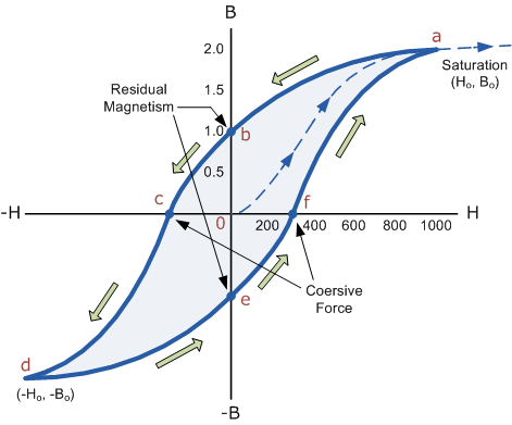

As we seen before, a DC magnetic field has an open magnetic hysteresis curve B=f(H) (#)
As we seen before, an AC magnetic field has a closed magnetic hysteresis curve B=f(H), AKA hysteresis loop.
(#) Supposing that DC current increases from zero to certain positive value and after this value is reached it is maintained constant.
attachment.php
attachment.php

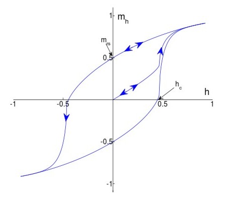

The slope of a line tangent to any point on a magnetization curve represents the permeability. The slope of a line tangent to a hysteresis loop does not represent permeability.
No, this is also nonsense, let me explain
As we seen before
B = μ H (*)
Then the slope of a line tangent to a point on a magnetic hysteresis curve B=f(H) represents the magnetic permeability.
Magnetization, M, is defined as
B = H + 4π M (**)
Combining (*) and (**) we can write
M = [(μ - 1) / 4π] H
Or
M = χ H
χ is called magnetic susceptibility
Then the slope of a line tangent to a point on a magnetization curve M=f(H) represents the magnetic susceptibility.

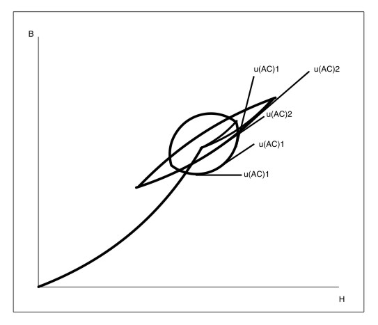

Permeability can be graphically represented in two different ways.
Taking the dB/dH of a minor loop
Taking the dB/dH of a line tangent to a point on the magnetizing curve.
Taking the slope of a line tangent to a point on a hysteresis loop does not represent permeability, it is the deltaB/deltaH of the entire loop that does.
No, this is poorly expressed, let me explain
The derivative, is a local property of the curve, then you must say
Taking dB/dH at a point of the magnetic hysteresis curve B=f(H)
This is similar to your last sentence, but even more poorly expressed, let me explain
The derivative of a curve at a given point coincides with the slope of the straight line tangent to the curve at this point.
dave
Δμ = ΔB/ΔH
Is defined as "incremental permeability"

My initial objection was to this graphical treatment from post #182
attachment.php
Bdc=f(Hdc) curve is from point O to A, Bac=f(Hac) curve is magnetic hysteresis loop, its path follows A-B-C-D-A points.
this pretty clearly states that there is a magnetization curve and a minor hysteresis loop. They are not drawn correctly but the point is understood.
Then this is presented in post 235
As now elementary math has abandoned us, due to magnetic anisotropy, we only can do a graphical description.
At each point on the B=f(H) curve, must be
B = μ H
Then μ(AC) is the "slope" of the curve at each point.
attachment.php
note how the u(ac) is being determined by the slope of a BH loop which is at complete odds with the classic theory of graphically calculating u(ac)

Now lets consider adding DC into the mix and we get a displaced minor loop. Again the u is dB/dH of the entire loop and not determined by the slope of a line tangent to a point on the loop.
Beautiful drawing, but I can't see magnetic permeability anywhere. 😕
It says "Incremental permeability" 🙄
BTW, my drawing looks like an UFO 😀
It is said that a picture is worth a thousand words, mine are worth only a hundred! 😀
attachment.php
