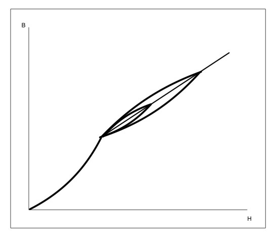

Agree, so I did say "constant" rather than constant because magnetic anisotropy ever implies a hysteresis loop, although very thin it is a loop after all
attachment.php
With a careful design, you can make hysteresis loss very small, so the area of the curve B=f(H) will be also very small, as μ(AC) is the slope of the curve, it can be almost constant, that's the goal for linearity...it is very simple and now I reduced it to simple geometry, maybe you can understand it this way.

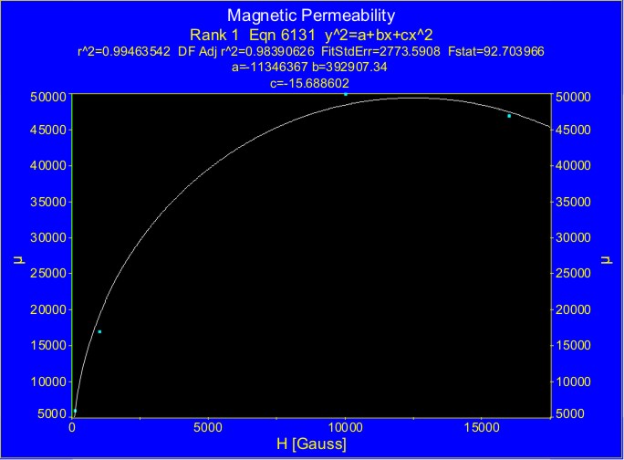

Lamination has a μ, and in its datasheet there is μ=f(H), here μ reaches an absolute maximum.
In a PP OPT, air gap is negligible, so, if you work in the region of that absolute maximum, your transformer also does, and also can reaches that absolute maximum.

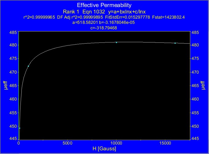

In a SE OPT things are a lot different, you have an air gap, and μ now is
μeff ≈ l μ / (l + lG μ)
Now you have a completely different μ=f(H) curve, because, as I said before, μ is reduced between one to two orders of magnitude, about two in this case.
attachment.php
Now is a little bit difficult to see a maximum, isn't it?
Due to we need a margin for Bdc, the rest of the curve is pretty constant, then doesn't matter which hysteresis loop you look at, always μ(AC) reaches a maximum at its corresponding Bac(max)
SE transformers works this way!!!

Then as soon as Bac is 50-100 Gauss mu AC increases a lot and then it changes very little for quite a bit.
This is also wrong, because after a little initial increase, μ(AC) is quite constant out to saturation.
Because of this, for SE OPT, the gap will keep the working inductance to about 1.3 times the inductance of rest voltage.
Now you can stop with the nonsense of the maximum μ(AC), as I said before SE OPT works this way, no need for fanciful explanations.
Hi SY
Here the disappeared images of post #203, in order, I lost the whole Sunday making them with data processing included, if you can do something.
Thanks in advance.

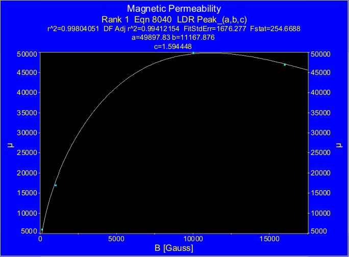

Here the same graphs, but with correct field B instead of H, sorry, is the tradition to put H over x axis, and definitely for magnetic permeability, that function adjusts much better the few points.
By the way, the data here
https://www.edcorusa.com/t/Mtr-Core-Steel
Seems to be the only company that use cgs units. 😉
Good for Edcor! 🙂
