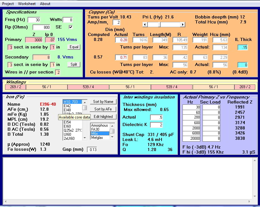

I want to add that my program DOES NOT GARANTEE any thing, it just applies equations (wich may be a bit different than popilin's one) and shows you some results.. . .My question is why can't we just use the existing equations/methodologies or just with Yves' program to design and wind the OPTs, i.e., why re-invent the wheel? Or am I missing out on something otherwise?
YOU must analyze this results and apply adjustments (core size, induction, gap size, copper wire section, interleaving, inter layer and inter winding thickness and material, etc...) until YOU meet YOUR specifications.
Must I add that this almost always finishes with some "compromises" ?
Yves.

I use it for both types.
Design a transformer with such a tool is interesant, but keep in mind that all audio transformers are only and simply, transformers. A bunch of formulae governs the the transformer design.
The real critical point is the physical implementation. An excellent design (Made by software or paper and pencil) becomes a disaster if bad wiring techniques used and or bad wire and isolation characteristics and or bad core selection.
The last point is where I have no doubt, Juan is pointing in this thread. Be patient.

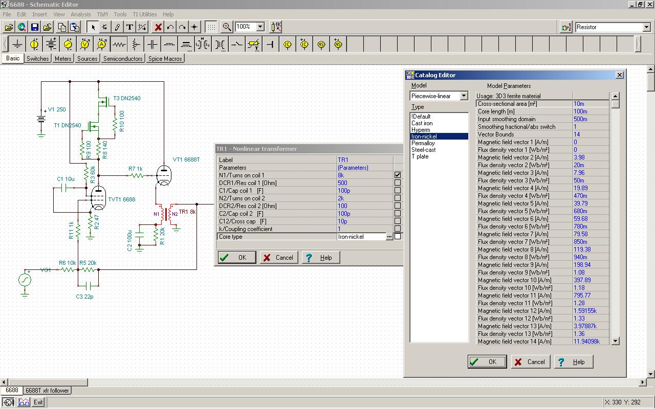

Are there any really great SPICE models for audio transformers? I use Tina, and it does have a long list of parameters I can specify, but I don't have a clue about almost all of them. Does it appear that enough parameters are included in the Tina spice model of a transformer?
OK, I stand corrected. The program does both gapped and ungapped transformers. I've loaded the program again and I'll give it a try again.

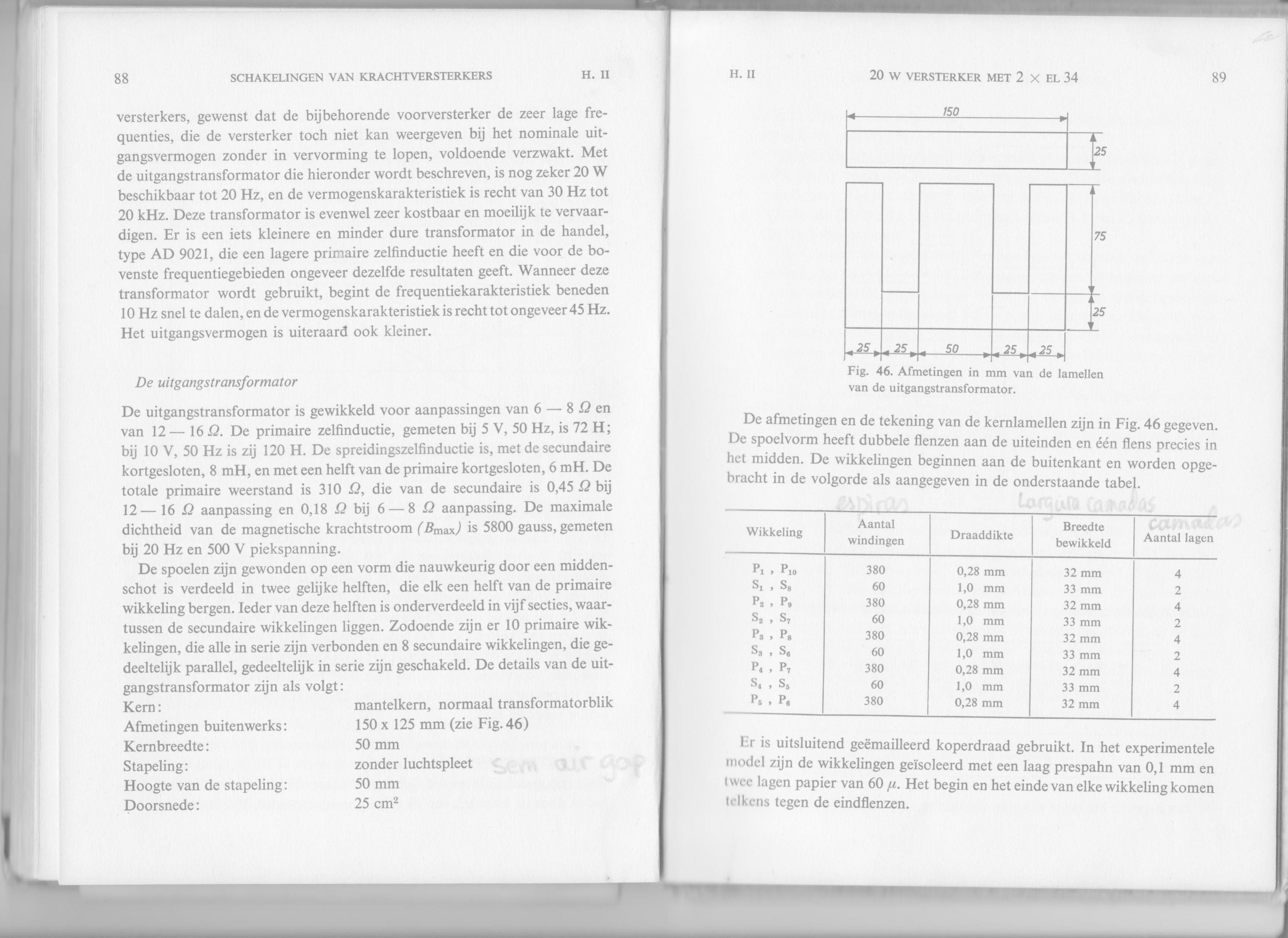

Here is a project for a very good quality output trnsformer for 2 EL34 Ultralinear
Too big core for a PP OPT, try with EI 114 lamination. 😉

Take plitron data sheets and other manufacturers, with lots of care. Measurements may be true, but in some particular cases, and as almost all advertisements, misleading. The van der Veen books is full of errors. I purchase the book, and as I know books mustn´t be burned, I wanted to incinerate it.
