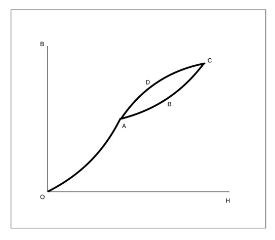

Agree, μ(AC) has not necessarily a maximum at Bac(max), but... you forget two details
1- We have an air gap that affects both Hdc and Hac (increases them), so both μ(DC) and μ(AC) are greatly reduced, between one to two orders of magnitude, so magnetic hysteresis curve results less sloping, due to Bac does not change by the air gap, and the area inside the loop is almost constant, the new magnetic hysteresis curve is also thinner.
2- We have a superposition of two fields, DC and AC, we can apply linear superposition principle, then we have something like this
Bdc=f(Hdc) curve is from point O to A, Bac=f(Hac) curve is magnetic hysteresis loop, its path follows A-B-C-D-A points.
It results pretty clear that μ(AC) reaches a maximum at Bac(max).

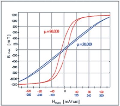

However even mu DC in reality is not precisely constant as function of DC current. It will decrease a little bit with increasing current until where it drops suddenly.
We can consider μ(DC) constant only if steady state is reached, if steady state is not reached, μ(DC) will increase with Hdc (DC current) up its maximum, after that it will drops suddenly, (saturation) if Hdc (DC current) is reversed, due to anisotropy of magnetic domains, B=f(H) curve is reversed but following another path, this phenom is called magnetic hysteresis.
In the example here with 2080 turns, with 0.3 mm gap, it will be about 340 with 80 mA and will go up to 350 decreasing the current to 70 mA. This is just for the records.... Measuring mu(DC) with a very small (10 mT) AC field is the only "easy" way I know. Such small perturbation won't change things. It's classical physics regime....

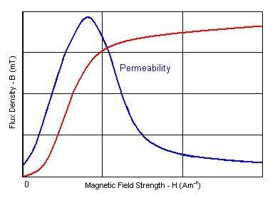

As can be seen from drawing, Bac is dependent upon the applied Hac, the "knee" of the curve coincides with the point where μ(AC) starts to fall, in most cases for EI M6 between 10 KGauss to 12 KGauss, far from saturation region, as I said before, and you can check this with most manufacturers' datasheet.
Variations on μ(AC) are highly undesirable, and that behavior of Lp is indeed due to variations on μ(AC), however in a properly designed SE OPT with a very good core, μ(AC) can be about "constant" and magnetic hysteresis curve can tends to a "straight line" then your described behavior of Lp can be fruit of a very bad design.

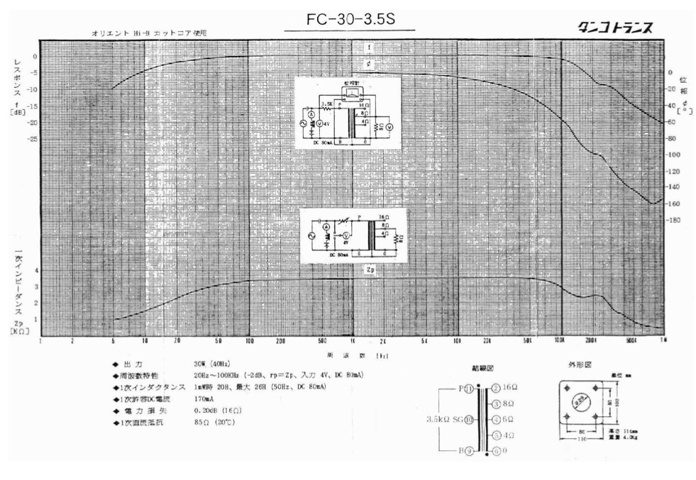

Here is a measurement:
http://plitron.com/wp-content/uploads/Atcl_3.pdf
In Fig.7 you have the primary inductance (measured at 25H while the standard is usually 50Hz) as function of secondary voltage. Although this is a PP OPT and the variation in mu is much more than in a SE OPT with gap you can see that L is max for 9 V rms only. 9 V rms into 5R is about 16W. That transformer is specified for 100W and power bandwidth (-3dB and so 50W) at 22.7 Hz.
In this case it is not a problem because the primary inductance is huge anyway although it is supposed that there is no unbalance so if you want to make use of it you need a bias servo as he did otherwise you need a gap and things might change....
So, your source of inspiration is a poorly written article, with badly written equations that can't pass even a dimensional consistency analysis, and about... Push-Pull transformers!!!

My numbers for permeability are REAL and MEASURED. And permeability will never be constant. Its variation is only reduced with the gap and it not max at a generic Bmax. It depends on the material, the gap and where you are. You generic pictures and tentatives show that your experience is ZERO!!
The goal is to get the best possible behaviour which means 2*pi*f*L >> Req. It 's obvious that this is desirable at max power. Only this will minimize distortion as in SE amplifiers the inductance is always limited. Your problem is that you have no idea about audio amplifiers!
Moreover working at lower B max one also gets lower core loss. But you are so smart that couldn't realize this until now that I am telling you!!
