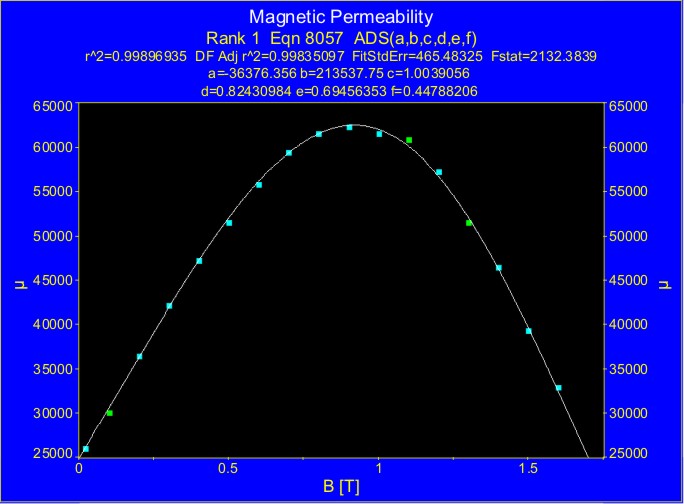

As GOSS have been improved over the years in terms of saturation and losses, its very high permeability is quite similar, so if you have the core datasheet better, but if not, an astoundingly good estimate can be made with almost any similar standard datasheet.
In the particular case of transformer of post#71 I used the data from Edcor M6 GOSS lamination, as permeability has a maximum in the region between 10 KGauss-12 KGauss, and the curve μ=f(B) is almost symetrical in that region, I took the value for B=16 KGauss because I needed μ at 6500 Gauss.
So with that value, μ=47000 @ 16000 Gauss, I obtained lG≈0.35 mm
Let suppose now a "Standard Unspecified M6" with μ=80000 @ unspecified B value, I would obtained lG≈0.36 mm, not too much difference, a so experienced winder would know it.

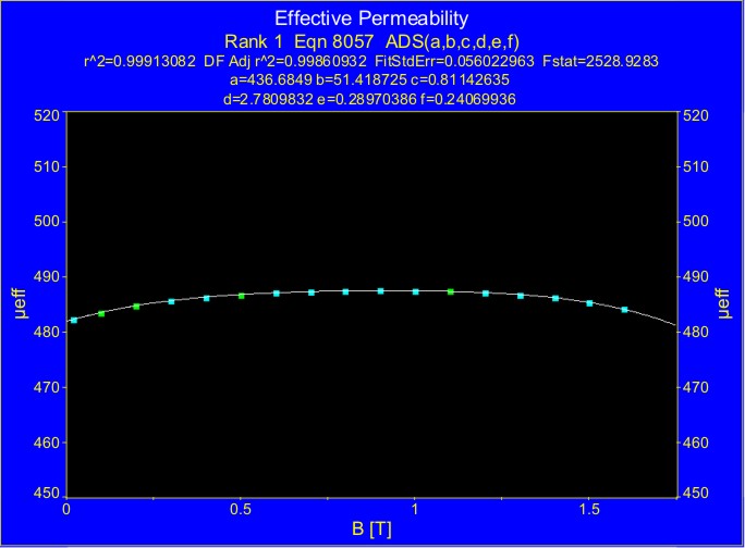

2) AC effective permeability is not constant as function of
AC flux and this is reflected into the inductance. There is quite some variation initially up to a point where a max is reached and then it will slowly start to decrease. How much will decrease is a very practical thing!!! The real nominal value to use for calculations not only depends on the material but also on the actual treatment and finish!
No, you are still confused, let me explain
As have been perfectly cleared on the first post, magnetic anisotropy makes extremely difficult to obtain the values of magnetic permeability for a given hysteresis curve, so we must work with DC values, such curves are in datasheets, like this, made with data from here
http://www.nssmc.com/product/catalog_download/pdf/D004je.pdf
attachment.php
If we add an air gap, things are completely different, we have not μ anymore, but μeff, that is between one to two orders of magnitude lower, and above certain value of B, it is quite constant almost up to saturation, like this, which is constant at about 1% from 100 Gauss up to saturation!!!
attachment.php
Linearity comes from line, if the medium were homogeneous and isotropic, the relation between B and H would be linear too
B = μ H
Unfortunately, the core nightmare is a reality, but not all is lost, if we have a superposition of two fields, DC and AC, we can apply linear superposition principle, then we have something like this
attachment.php
With a careful design, you can make hysteresis loss very small, so the area into the curve B=f(H) will be also very small, as μ(AC) is the slope of the curve, it can be almost constant, that's the goal for linearity.
Then, for properly designed Single-Ended OPTs, μ(AC) is quite constant under all its normal operation.
Can the gap can really be considered single valued? No, most of the times and depends on the quality of the laminations and their cut and how well it is implemented into the transformer!!
In order to avoid such kind of problems, you can use C cores, the cut is amazingly accurate, if you use EI, usually the air gap is outside the transformer, so put the core over a glass (mostly plain) to align all laminations, practical and easy.
BTW. For calculation purposes, always you can consider the gap as single valued, except you need another strange property for your transformer.
That's why I don't suppose that mu AC is constant up to saturation. What is the best way to limit this issue? Answer: not to use high induction.
Wrong answer, that way μ(AC) will be in the region on it is even quite more constant.

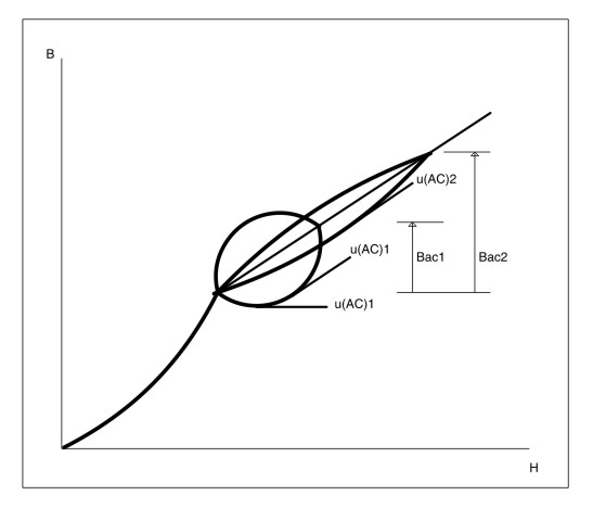

As now elementary math has abandoned us, due to magnetic anisotropy, we only can do a graphical description.
At each point on the B=f(H) curve, must be
B = μ H
Then μ(AC) is the "slope" of the curve at each point.
attachment.php
Bac1 and μ(AC)1 corresponds to transformer with EI 150 core, Bac2 and μ(AC)2 corresponds to humble transformer with EI 84 core.
A properly designed SE OPT, must have μ(AC) quite constant, so Lp must have the same behavior.
Huge variations on Lp, says us that linearity was destroyed.
However that has nothing to do with this variation
Hey, colifa! There are two µ(AC)1's in the diagram. Which is wrong?
There is one μ(AC)1 on each point of the curve1, as there are infinite points on the curve, so there are infinite μ(AC)1's on curve1, the same with curve2, the idea is to ilustrate that μ(AC)2 is quite constant over its curve, but μ(AC)1 varies a lot over its curve, even with halved Bac1, so linearity was broken. 😉
Let's clear that "colifa" means "a bit crazy guy" 🙄
That are friends! 😀

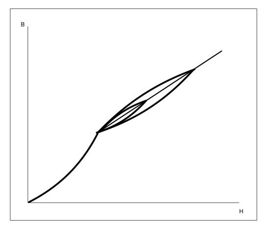

Hey,
I don't understand what this drawing is supposed to represent.
can you explain in words or label it better?
What is the line leading up to the two loops?
Are the loops minor loops with a DC bias?
dave
If I explain with words, my Tarzan-English will obscure even more. 😀
Last option, DC bias plus two minor loops.
2- We have a superposition of two fields, DC and AC, we can apply linear superposition principle, then we have something like this
attachment.php
Bdc=f(Hdc) curve is from point O to A, Bac=f(Hac) curve is magnetic hysteresis loop, its path follows A-B-C-D-A points.
It results pretty clear that μ(AC) reaches a maximum at Bac(max).
If you do not like drawings, could be worse, could be tensor calculus...
