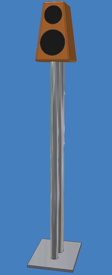

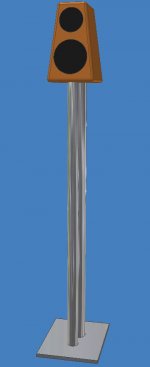

Here's my take on the inexpensive Bose beater. Three inch full range and four inch woofer. Four inch doubles the lower range only to reinforce the bass output from 200 Hz down. The integral stand uprights are used as speaker air volume and stuffed to kill standing waves. 1/2 inch MDF. Only slightly larger than BOSE. 5.5 inches wide by 6.5 deep by 8 high. 3.5 by 5 at top of cabinet. Inner cross partition to seperate four inch from modulating low x-max of three inch full range. Aperiodic loading of upper driver. Lower stands have hidden vent in rear for aperiodic loading of woofer.
Hezz

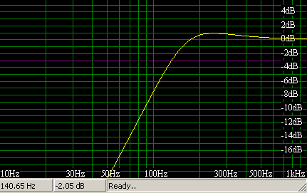

Might just work. It is just a tiny bit wider than we want, but just about everything is. Everyone please remember, the object of the exercise is to make a system with satellites that are as small as the B-se AM-15. Making a system that just sounds better for the same money (or 1/8th the money) is trivial.
Here is a simulated FR plot of the JX53 in a 57 cu in sealed box. The Qtc is about .95. It looks like you would need to cross it over at 140Hz or more, but, hey, that beats Bo$e!

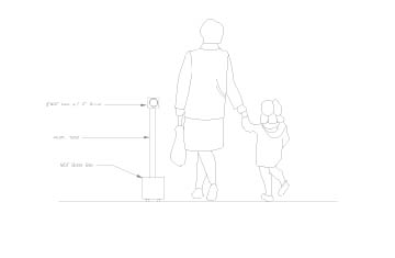

I think that the scheme that I synopsized from various peoples ideas including my own is a fair varient on the Bose theme.
the satallite units are tiny and you DO need a stand for them usually, and even thought Bose makes it black, the subwoofer DOES exist and needs to be dealt with. So, here is a fuzzy diagram of how it might look. The cube could be 1/2" MDF and still be OK due to the tube voulume, and an MDF cube is a lot easier to make! The tube could be black if it needs to be less obtrusive.
It also looks a bit like a giraffe, and what's cuter than that?
