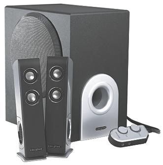

Dave,
Today I saw some computer speakers a Circuit City that were really well designed and small. When I turned them on I was amazed at how good they sounded in relation to the other computer speakers. I think they were an exellent design. About as tall as the Bose satellites but only about two inches wide and 3.5 inches deep. They had two I inch wide range speakers mounted vertically at the top of the enclosure and one side firing 2 inch driver near the bottom. Coupled to the six inch subwoofer the combination was much better than you would expect from such small speakers.
I think you could use this topology and widen the speaker a little and make it more deep. Say four inches wide and five inches deep. You might even be able to add a little height as this gives the cabinet a more artistic look. They look much better than the Bose sattelites. Then you could use 1 two inch upper driver or two 1 inch drivers and a side firing 3 or 4 inch driver to supplement the bass.
With a well made rigid cabinet you should be able to get good sound down to at least 150 Hz and maybe lower to 100 Hz.
As you said the subwoofer is the easy part in this build. I will model a solid mockup to see if you like the idea.
Hezz

Dave here is a picture of those speakers,
Not highend sounding but pretty good for computer speakers in the tiny category. A slightly enlarged version might sound pretty good.
1 inch tweeter, two inch midrange and three or four inch side firing midbass driver.
Hezz
