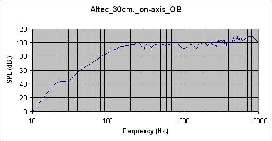

Also, I have four Altec Lansing drivers that measure quite well in a small OB. I could consider using these.
get this speaker in a .4 liter enclosure, with it's 1mm xmax and 154hz fs, and your gonna have a system as crappy as bose, no matter what you do...

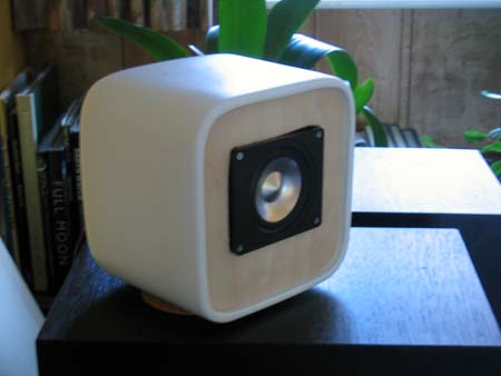

just read the whole of this thread and unless i'm going blind i can't believe no-one's mentioned the Jordan JXR6
My thoughts exactly. I have a system running which is 2 litres per enclosure and seems to operate fine to 120Hz, with declining output from there to 80Hz. It should be possible to get the size down even further. Enclosure is a ceramic pot, which has a 70s feel to it. More so when the baffle gets the black leatherette treatment.
