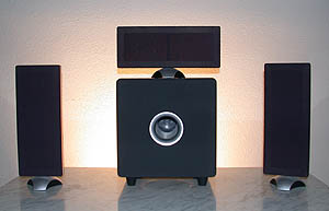

Here is my synopsis to this point:
Davey Jones wants speakers as small and cute as Boses but sound better and are DIY. This is the design requirement. He does not want alternatives such as in wall, art objects, new girlfriend.
The game is to beat Bose at THEIR game.
-The satellite size MUST be
3 1/8 X 6 3/16 X 4 1/8 or minimally larger ie 1/8"
-They must cross over at around 100 hz MAX. so the sub doesn't have to be very close to the satellites.
-They must look cute

So I think that Davey is on the right track with his latest ideas.
A 3" driver that has adequate power handling and excursion to tolerate linkwitz transform bass boost to get the crossover down to 100hz or less but at low sound pressure levels!! Can you use linkwitz transform with aperiodic loading? I think so...

the 3rd trick Bose uses is that the sub is black and doesn't really count in the "cute" factor. I would first see if you could make 2 subs, and investigate if there would be a chair or sofa or bookshelf or someplace close to ewach speaker where you could hide each sub.
Or perhaps she wouldn't mind one foot square (cute cubes!), well finished, sub boxes in the corners behind those stacks of art supplies.
The general rules are the same though- sealed cabinets with eq and high power.
Where is all this high power coming from? Well if the average sound level isn't very loud, ie less than a watt, then then the power might not be as high as it might seem, and one of the many chip amps around here could do the job. Or maybe one of the Tripath amps:
I prefer my Sonic Impact T amp, but with the equalization, its 5 watts a channel is prob too little. There is a three channel Teac Tripath box that might be just the ticket with about 20watts/ch. -and it is VERY cute in a nicely finished metal box. 41 hz makes Tripath kits of greater power, but they require some surface mount soldering.
