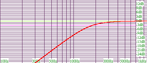

I am proposing a two way-I'll explain in a moment-with an Audax HM100CO woofer from Parts Express. Pricey, I know-$70 each. But you did say $600 for the whole system, correct?
Here are the specs:
http://www.partsexpress.com/pe/pshowdetl.cfm?&DID=7&Partnumber=296-053
In a 4.5" cube, with 3/8" walls, the 4 inch HM100CO has 53 cu inches to work with. Let's call it 45 cu inch. This is inside a 4.5 in cube.
What are the advantages?
It will be 6 dB down at 140 Hz-right where you want it to be for a 140 Hz crossover.
It will be 89 dB @1M/1W-how much more efficient is that than the others?
It will have a Qtc of 0.65-somewhare in between critically damped and the traditional Qtc of 0.7.
Here is the curve for the woofer:

Just to give you an idea of how good this is: the 4" can move 0.64 cu inch of air. At 140, where it crosses over, that's about 100 dB SPL, more or less.
But at the crossover point, it should be about 6 dB down from the midband. So the midband output should be about 105 or 106 dB SPL.
That is mighty fine output even for larger systems, let alone a 4.5 inch cube. The trick, of course, is that crossover point. If we crossed over at 100 Hz, we can deduct 6 dB from that figure.
Making a high crossover point-but not as high as Bose's-lets us get surprising performance from a tiny box. And 140 is considered a good crossover point even among hifi aficionados. 200 Hz is not.
