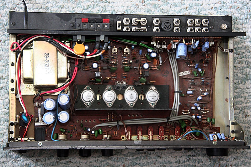

The thermal layout of the B-110 output stage resembles that of the SAC 50-60 power amp.
The SAC "Igel" also sports a single pair output stage, 130W TOP3 devices, also mounted to the bottom of the amp case that serves as a heatsink.
The anodised aluminum mounting/heatspreader plate for the A1216/C2922 pairs of the B-110, custom order job, looks like a thermally well thought out solution.
Maybe Mr Sillesen can enlighten us how the heatspreader is connected to the bottom of the B-110 amp case.
SAC amp board=>
Regarded the thermal performance of heatsinks used in amplifiers (both if envelope resp. case is heatsink itself so as if separate internal alu profile is used), that is by typical hifi amplifiers, who has same output power as SAC (IGEL outfit), Densen or Naim Audio, that is much more lower. Examples from Luxman and NAD are to see here
http://www.audiostereo.pl/zalaczniki/907242_1.jpg
Luxman l-210 image by nanideleon on Photobucket
http://www.fmueller.com/images/NAD-3020.jpg
Nevertheless - for home hifi application there are not problems to be expected in most cases regarded too high values of temperature (Idle current <50mA). If I use only the typical vaues of acoustical output power, the needed electrical output power must be only present during the peaks in music material

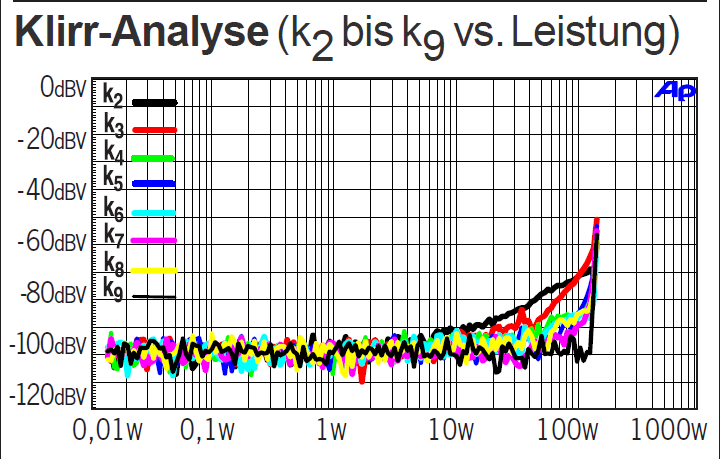

You're entitled to your own opinion, but in mine, this is junk:
@GK!
I agree, something must have gone wrong the day this amp was designed.
Any DIYér regardles of experience, would turn his back on measurements like that, and start all over.
Distortion that high can never be overheard, so even if you did not use any THD+N measurings, or other design tools during development, a simple listening test would easily reveal this, one way or another.
What puzles me most though, is why the reviewer did not point this out thorougly.
But sometimes equipment designed in a basicly idiosyncratic way, emphazises certain sonic impressions. I.e. if you did play and mostly listened to distorted guitars, then some extra distortion would maybe make you feel better, although it is not correct.
Classical music would then in contrary be almost unbearable, which sometimes ,gently but unmisunderstandably, is pointed out in reviews of gear from this manufacturer.

Btw. The distortion graphics GK published relates to an amplifier rated @:
125/250Watts @ 8/4 Ohms
@ 0,05% THD @ both 8/4 Ohms.
But already around 6 Watts it crosses the line to whole percentages of distortion @ 4 Ohms.
If that happened @ 100 Watts or higher, it would be of no serious concern, but 1% THD@ that power level is easily audible by anyone, as i.e. room acoustics and speaker behaviour will not mask distortion at that level. And one should remember, that this is into a pure resistive load. It will probably be much worse with a real life speaker connected.
A 10W the 3rd harmonic alone is already >1%
I do not even think my wife distorts that much
This value is either created by a measurement error or by an individual error on that individual amplifiers. But I think more likely the first, because I have no confidence in the measured results of our well-known magazines here in Germany.
I don´t think you have to blame it on the germans this time😀.
It is audio precission measuring equipment that was used at the german magazine, and that is american, at least so far🙂
If this measurement is done right or wrong, is hard to decide without repeating the measurements oneself. But actually I´ve listened to these amps, and these figures do not surprise me at all.
I think they are perfectly valid, otherwise the manufacturer would probably have made remarks on that matter, or at least not published the results on his own website.😀
But if they are true IEC values I do not know, only Stereophile are very thorough about explaining how they do their measurements.
This fulfill almost each used topology, "blameless" too, VAS is the only "voltage amplifying stage" in feedback loop, diferential input stage or follower output stage are not...The main problem of Densen "topology" is underbiased output in class B outside of (linearizing)feedback . Measurements at 10kHz or 19+20kHz IMD will be much worse.only one voltage gain stage in the feedback loop
From published graph is clearly visible, that output devices are switching off at about 400mW (rapid raising harmonics over third), measurements are done well..
I agree with first. This is one of the most doing work by other amps to improve the sonic quality (look at the other weblinks mentioned above)
By second I am not shure. For the class AB mode I haven't large aera for the choice of idle current. As I know, BjT output audio transistors in general mostly optimized for idle currents between 20 - 50 mA, independend of the used circuit driving topology. In this aera is the most smooth overtaken from ClassA to classB.
But a not mirror symmetric character (Ube-IC transfer) of the NPN-PNP devices could be the reason for the unwanted switching off and therefore enhanced H3 values (please note, there are some counterfeits on the marked - go to
Counterfeit Transistors. )
The second possibility it could be a idle current clearly below 20 mA. But in both cases I have an individual error, as I mentioned above.

About so as in picture (from the same magazine), or betterHow can that be?
For 40W at 8ohm class A is (in push-pull classA)about 1,6A idle current needed ..No chance to cool it with Densen aligment.im Class A Mode 40 Watt an 8 Ohm
