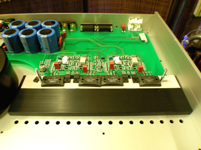

What I do know is, that the B-110 is based on 1 pair of 2SC2922/2SA1216. This seems very OK for an amplifier rated at 60 watt@8ohm and 120watt@4ohm. Only problem is, that it has no heatsinks, and therefor runs hot. During the lawsuit, the independant engineer testing the B-110, proved that the B-110 was capable of less than 12 watts pr channel @ 4 ohms, due to overheating. That is less than 1/10 of the rated power. Fitting a heat sink into the B-110 would in my opinion make it an acceptable amp in it's price range. After all you do get a NFB design, relay controlled attenuator in a nice design.
However.... The big issue if you ask me, is that when going from the B-110, that seems OK in terms of output devices, to the B-350 capable of around 300 watts, Densen still use the same 1 pair of 2SC2922/2SA1216. That seems to be a very weak solutions for 300 watts, and as far as I know, way above the reccomendations from Sanken.
When you also take into account, that B-350 is supposed to be some sort of High End Statement product, this seems even worse.
Wonder what the patent is all about 😕

A1216/C2922 are 200W devices, so a single pair does 400W.
Pd of a power device is the max dissipation level it can handle and does not directly translate to output power, imo.
The power levels Densen issued for a single pair output stage suggests a fancy protection circuitry, aka a dissipation limiter.
The 225W-8Ohm Kenwood M2A had only 4 Sanken DAT devices per side in a low/high switched power configuration.
DAT devices are two matched power transistors in parallel on 1 substrate, aka Dual-Audio-Transistor, with BE-C-EB pins.
You can find the M2a schematic at audio-circuit.dk of our diyA knight in shiny armour Jan Dupont.
I'm sure what you mean. But you will NOT be able to dissipate 200 watts pr Sanken device. This assumes that you can keep the temperature at 25 degree C, which may be hard when dissipation 200 watts 😉
At 100 degree C the deratin curve show maximum 80 watts. In real life applications, I would go for something like 50-60 watt pr device! And not a single watt more!

That means automaticly relatively low supply voltage at the output buffer stage for high realibility regarded lifetime and stability for idle current.
If all this estimates are right, I would good understand the avoid of schematic releases for service and maintenance.
As far as I remember, the B-110 was able to deliver the rated power = Supply voltage OK.
But only for a very short time (seconds). Then it runs to hot!
That's why I suggest using heatsinks, which generally is common in amplifiers rated at 120 watts 🙄

For commonly home hifi applications this kind of heatsink creation is a good solution, but it must be ensured that selected quiescent current is 20mA until max 30 mA (i.e. normal class A / B).
Older Naim Audio amp models so as Nait, NAP110 or NAP160 use basicly the same solution for the heatsink.
Can you make a high resolution foto of the driver part from power amp section?

Mmm, the idea for the B-110 likely was that the aluminum extrusion bottom/sides part of the amp case is the heatsink.
I guess you are are absolutely right!! Only problem is, that it does not work. The report made during the "Densen lawsuit", stated that a B-110 can deliver less than 12 watts pr channel driving 4 ohms.

Søren is amusing though, i love his various "IL Pape" avatars, also the one at the hifi4all forum.
The thermal layout of the B-110 output stage resembles that of the SAC 50-60 power amp.
The SAC "Igel" also sports a single pair output stage, 130W TOP3 devices, also mounted to the bottom of the amp case that serves as a heatsink.
The anodised aluminum mounting/heatspreader plate for the A1216/C2922 pairs of the B-110, custom order job, looks like a thermally well thought out solution.
Maybe Mr Sillesen can enlighten us how the heatspreader is connected to the bottom of the B-110 amp case.
SAC amp board=>
SAC amp board=>
- Densen amp
