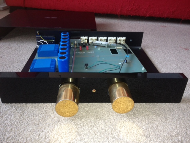

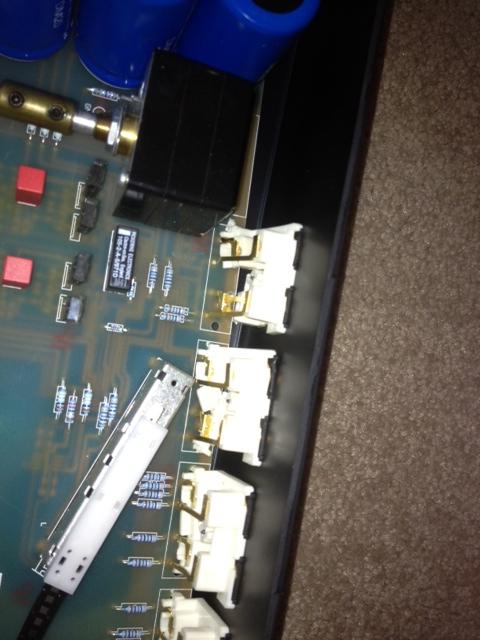

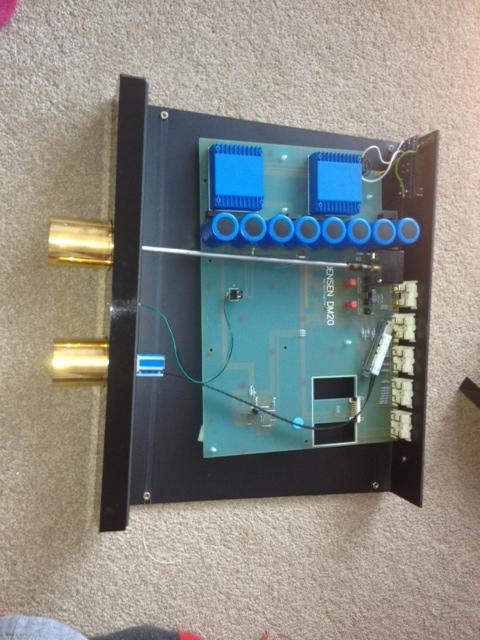

Densen DM20 Preamplifier
For this amp I am looking for a schematic.
Thank you for upload.

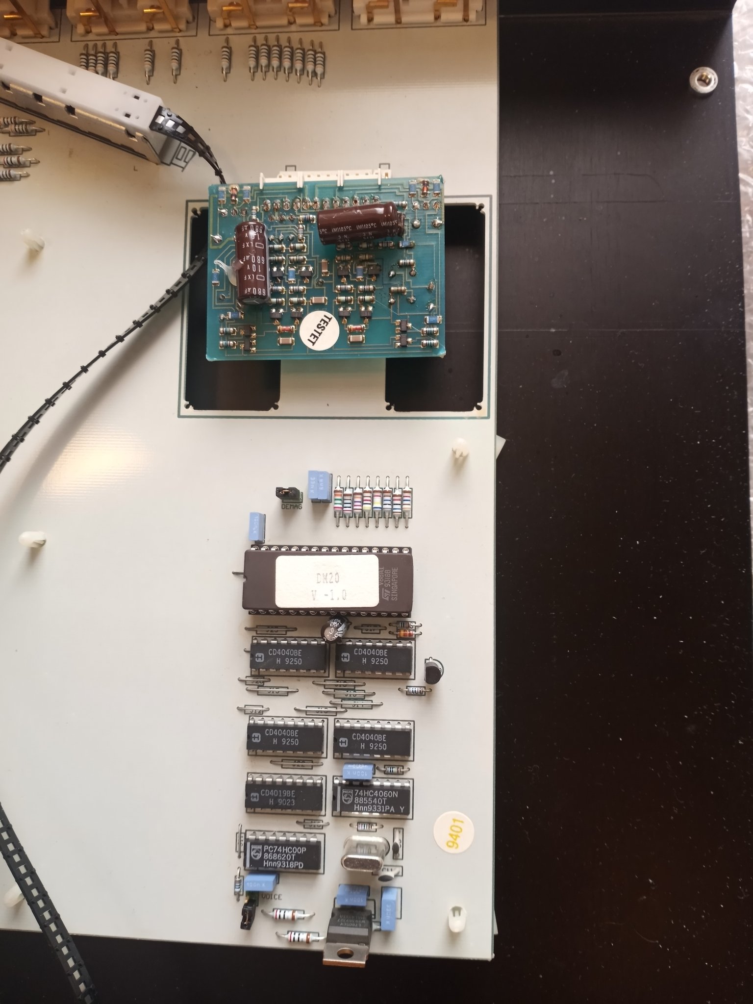

Obviously this line stage consist only of a buffer stage (push-pull or single ended emitter/source follower include current source) - go to the attached images, that I have found on the web.
At the pdf image I note an additional EPROM section, but no motor for the volume control.
Maybe for a good morning song after switch on ?
No. This section perform the same after switch-on than this compact disc:
Densen Audio Technologies - Densen CD Magic
