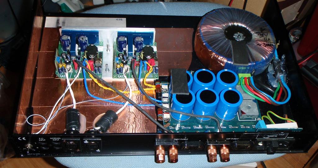

What to do with an old Densen...
Arne K
Claimed 294 watts into 4ohms from a single IC with those smallish heatsinks seams to be alot for a typical AB/B amplifier. I can not read the language the article is written in though, just see the specs they give. Maybe they have a fancy trick or it has switching rails or something. Still big claims for a single IC.
has to be class D for that much output.
The stk - 4048 II http://www.audiolabga.com/pdf/STK4048II.pdf ..can do 150w - 8R and might do 200+w @ 4R if properly heatsinked. The 4050 can do 200w/8 & 300+w/4. I have heard the 4048 in a big fisher and it can not hold a candle to a discreet OPS. The larger PS in the denson might improve on this.
Looking at the schema above , it is just a doug self based amp with 2 pair complimentary BJT outputs 🙂 .
