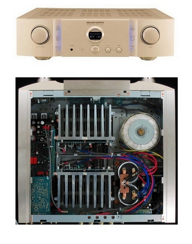

If you think the heatsinks are to small on the B350 Mono amplifier, then you should have a look at this: Densen Audio Technologies
This a stereo amplifier rated @ the same output power as the monoamp, featuring the same heatsinks 😀.
Maybe the scientific calculator ran out of batteries @ Densen.
And I don´t know if this is common knowledge, but heatsinks should be black, or they will loose their ability to disperse heatrays.
[And I don´t know if this is common knowledge, but heatsinks should be black, or they will loose their ability to disperse heatrays.
Marantz knows nothing!!![/QUOTE]
That might not be the case.
Heatsinks ought to be black to be as effective as possible.
If you choose to use bare aluminium for heatsinks, you´ll have to use larger heatsinks, than if you used black ones. Actually around 20% larger.
If you do so, there will be no problem.
So Marantz might know what they are doing anyway.

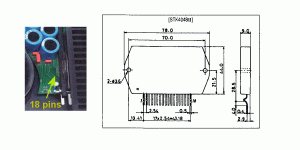

Sanyo still offers a wide range of STK hybrid devices. There are both complete power amplifier modul as well as predriver and driver devices - go to
Hybrid IC (STK Series)
for more information
But inside of this power amp I don't find such STK hybrid devices. there are only some diodes (surface mouted) in front of the 2SC2922, as you can see by one of the photos about German review

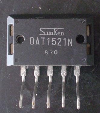

The 225W-8Ohm Kenwood M2A had only 4 Sanken DAT devices per side in a low/high switched power configuration.
DAT devices are two matched power transistors in parallel on 1 substrate, aka Dual-Audio-Transistor, with BE-C-EB pins.
