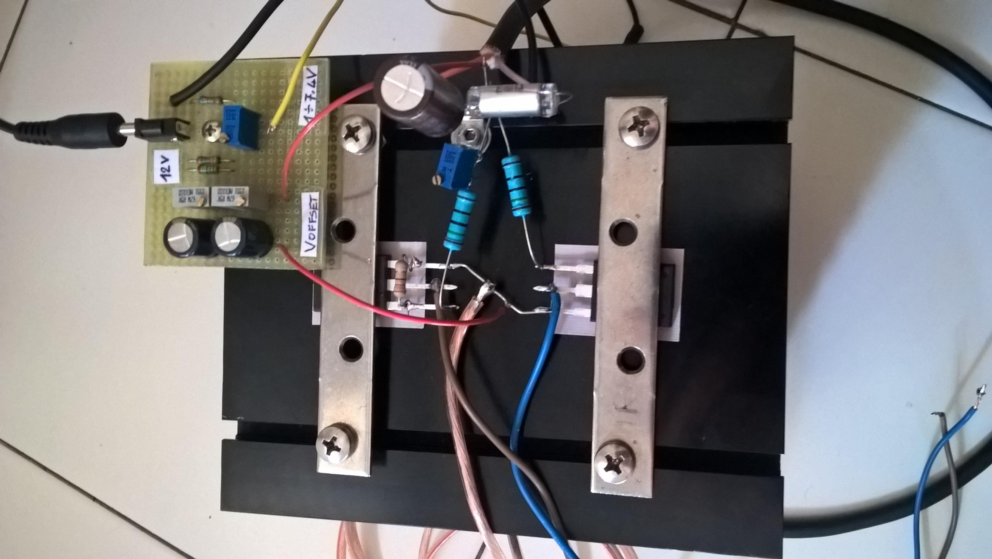

There's a SiC depletion mode N channel JFETs (UJN1208K). The P channel Mosfet is a IRFP9240. These are the measures:
Vds = +/- 23V
Vg1 = - 4.26V (UJN)
Vg2 = - 4.45V (IRFP)
Most excellent. I have played with the 1208K's also, and they are fine parts,
but a caution is in order - More typical Vgs for my samples is about 7 volts,
which will make it a difficult match for most P channel Mosfets. You may need
a decent population of parts to get the value range you want.
You have already shown in a previous post that Mosfet [pentode-like] and VFET [triode-like] cooperate nicely in a DEF amp to make a very pleasant sounding amplifier. It follows that UJN1208K [pentode-like] which has typical Vgs ~-7V can substitute for 2SK82 of ~similar Vgs. Thus, UJN1208K and 2SJ28 [Vgs ~+7V or higher] become a pseudo complementary push-pull pair in a power amp which uses or does not use overall negative feedback as in the SONY VFET diy amps.
This pair of FETs is not DEF but is an outcome of DEF's broader and unexpected utility.

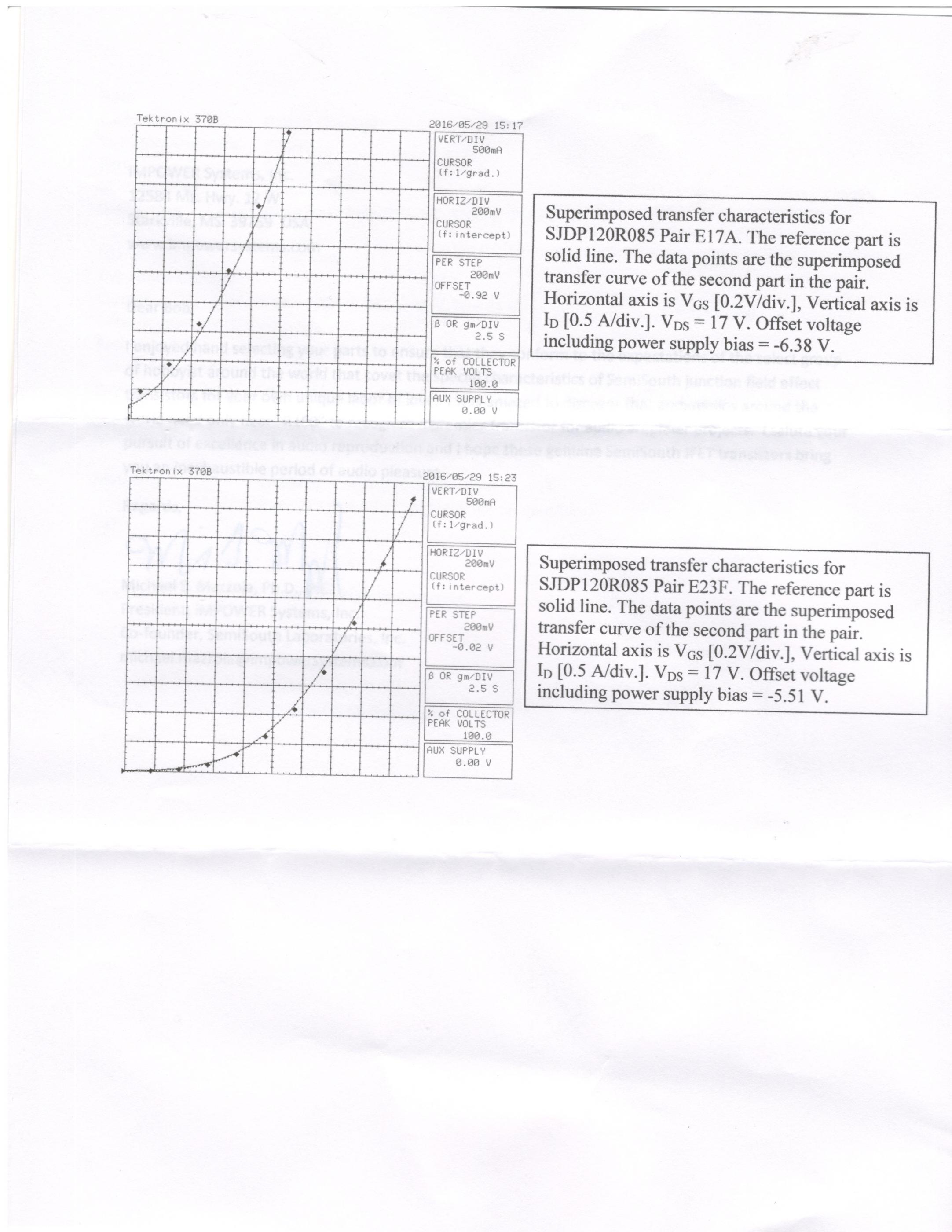

hopefully you have SJDP
Just returned from travel and checked - yes I have 4 SJDP120R085s - pairs E17A and E23F (Mike's designation) 😀
