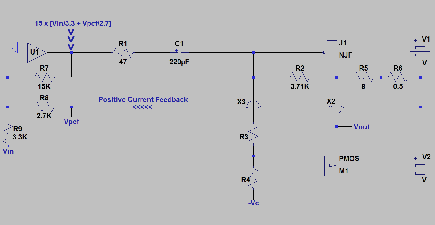

The simplified schematic is for a prototype DEF amp under subjective study. Please note its salient features:
1. The DEF FET pair operates in the common drain configuration; meaning a follower or power buffer as designed by Mr. Pass.
2. The DEF FET pair was also asked to operate in the common source configuration to give an inverted signal with very low gain across the 0.5 Ohm load tied between ground and the center joint of the 2 PSUs. Voltage gain is ~0.5 divided by Z loudspeaker.
3. The current flowing through the loudspeaker has the same magnitude as that flowing through the 0.5 Ohm resistor..
4. The resultant signal across this 0.5 Ohm sense resistor is the positive current feedback signal Vpcf. It is in phase with the music signal Vin.
5. Both signals are summed, inverted and amplified in the operational line amp [U1]. The contribution of Vpcf in the Vout signal of the OpAmp can be readily calculated.
5. The resistors around this OpAmp give ~ a 3+dB boost or add-on voltage gain to/with Vin.
I'll post the full schematic of this DEF amp. This amp and the loudspeaker gave a unique music signature which is very pleasant.

Can the DEF be driven with the BA-3 frontend? Is it enough gain? Will it work with the original schematic?
From article:
From article:
The voltage appearing at the Gate of Q3 is amplified by something less than the ratio of R10 divided by R8, and with the same happening at Q4 and considering the transconductance of the Mosfets, comes out at about 15. Both of them added make a system voltage gain of about 30X, or 30 dB.
DEF being source follower ....... drive it with anything you have
starting from M2 FE , ending with BA3 FE or whatever
From article:
Hello. BA3-FE is a current source preamp. It can drive DEF without a coupling cap. But the consequence is that the Vds of its complementary MOSFETS will be unequal. One will loose~ 4Vdc of its Vds and the other will gain ~4Vdc of Vds. This may impact the inherent sonics of BA3-FE.
The schematic in my previous post shows that R4 is the load to U1. It is ~15K in my past schematics. To be used to set the volatage gain of BA3-FE.
You have been experimenting with positive current feedback [PCF] from my read of your posts in the thread of First Watt F7. PCF is expected to be as readily implemented in this combination of BA3-FE//DEF as I showed but with a simpler circuit.
Someone else did the work for me. I just followed along. It looks easy enough to calculate.
Been thinking, will pcf be more of a regular thing now?
I am extremely late in seeing this interesting thread. I hope this isn't another design requiring unobtainium parts.
The success of F7 generated enthusiasm among DIYers and caused a revival in the understanding and implementation of positive current feedback [PCF]. For example, DIYer lhquam taught many options to use PCF in the First Watt F7 thread. PCF has and is expected to become more common in diy amps.

Thanks lhquam. DEF is interesting because it is a very simple design which is highly reliable to implement/operate. I found DEF to be highly enjoyable to experiment with. The SemiSouth SJDP120R085 N-depletion FET and an IRFP-MOSFET are the two basic FETs in DEF. Substitution for R085 is possible by using other available devices; for example UJN1208K. Mr. Pass is expected to write an article on DEF.

I fully agree about the beneficial influence of PCF on the clarity and presence of music. It is readily discernible. I continue to think about using PCF in other diy amps so as to raise their bar of performance.
