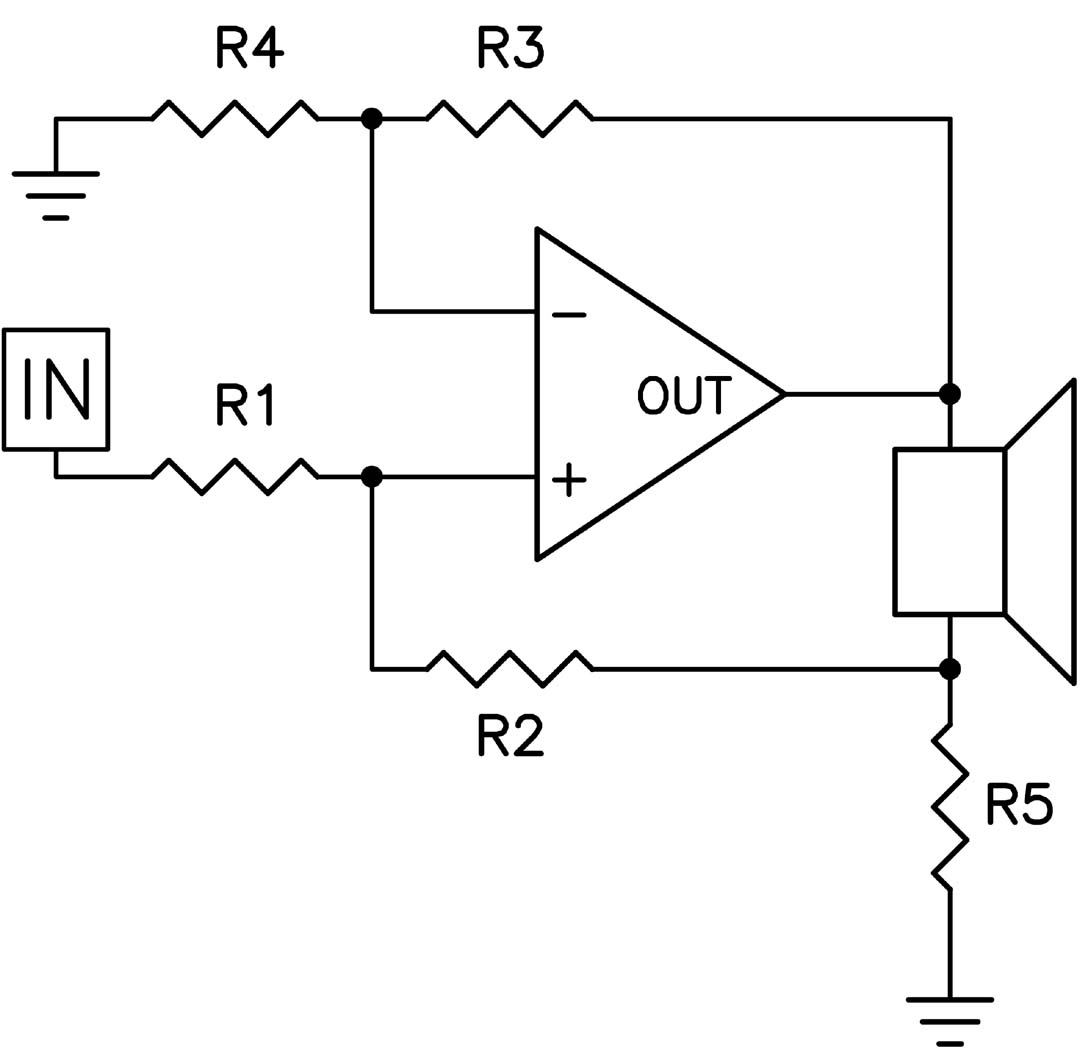

I'll tell what what. Attached is a simple schematic, showing an arbitrarily
simple gain stage.
The damping factor is determined by a confluence of values. LHQUAM
has put together a nice thread discussing this in mathematical detail -
I refer you to his posts.
R3/R4 sets the gain of the "op amp", but it could be a stage with fixed
gain without reference to R3/R4. It could be any sort of non-inverting
power amplifier with reasonable gain, bandwidth and damping factor.
Damping factor is generally influenced by the following:
An increase in the fixed gain of the amplifier will increase the DF
An increase in R1/R2 will increase the DF. Remember that R1 includes
the signal source impedance.
An increase in R5/Rload (speaker) will increase the DF.
As you increase these, the output impedance seen by the load
will down until it literally reaches 0, at which the DF becomes infinity.
More will take you into the region of negative output impedance where
you have negative damping factors, starting with -infinity and proceeding
to "lower" negative DF values.
When you get into the negative region, things get different.
As you go into the negative output impedances the amplifier starts to
exhibit motional control over the voice coil. A DF of -5 has more of this
control than -10, for example.
Low damping factors (like current source amps) encourage acceleration
control. Negative damping factors move you toward velocity control.
So go forth, plug this schematic into your simulators.
Or if you are a paid up member of FAB, wire it up and remember not to
inhale the smoke.
