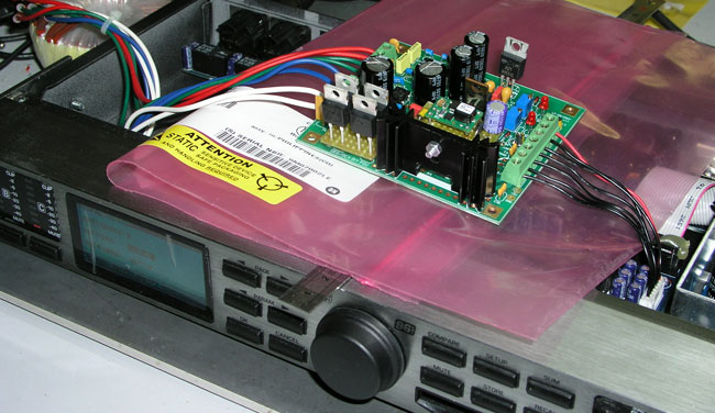

Steff,
I see that there are two LEDs D5, D6 at the outputs, that appear to be wired in error (upside down). Don't know how they are placed on the board, but may be worthwhile to check.
They are not mentioned in the parts list at the bottom (there are other D5, D6's though that are rectifier diodes).

Right. Thanks. Still difficult for me with left and right. ;-)
Fine on the board.
Has someone confirm if this board outputs the same voltage between the DCX2496 and the DEQ2496? I'm game to 2 sets of PCB they are the same.
Will said:Has someone confirm if this board outputs the same voltage between the DCX2496 and the DEQ2496? I'm game to 2 sets of PCB they are the same.
oops sorry, what I meant was, I'm game for 2 sets of PCB if the DEQ and DCX both uses the same power supply arrangement.
The board should work with the DCX but no tested yet. I plan to do this saturday with a DCX's owner.
BUT, you will have to move the DSP board and use longer cable to fit the board inside the box.

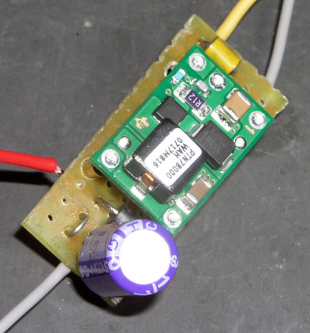

What do think to use an high end DC/DC converter to generate the digital 5v? Something with smooth PI filters at input and output.
We can reduce global heat by 75%. The 3.3v regulator will be connected to the digital 5v. The rest of the circuit will stay the same. Cost will be equivalent (no fan, only one heatsink -> spending will go to the DC/DC module). Only 3 CMS 1206 capacitors to solder (thrue hole version 10 times expensive). Same PCB size. More versatile input voltage.
Ryssen said:If that sucker 😉 doesn´t affect sound in a negative way,then go for it,I say.🙂
This is only for the digital part and for the important 3.3v, we still have the good LT1963. It's a 550Khz DC/DC with all protection features ready to use. The circuit wil be someting like this. Filter need more work to select the best inductor or ferrite. Transient response is a bit low. Regulation is ok.
Cost is 12€ w/o vat. At first time, I was looking to use a complete own design with a double DC/DC chip but cost is far more expensive if we source components ourself. And, it's a pain to solder...
Adios Fan!!!

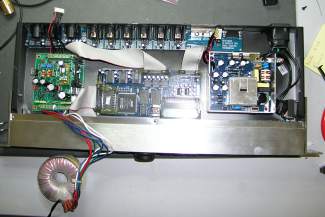

It seems to work fine with the DEQ. No problem at startup. I'm adjusting some caps (again) with this new circuit.
Good news everybody. The prototype work well inside the DCX2496 too. 🙂
With the help of kepa1, we used a part of this Saturday afternoon to test the latest version of the prototype inside its DCX2496. Good surprise too, the temperature of the PSU is lower than using it with a DEQ. The 3.3v heatsink was around 32°C (42°C with the DEQ). The rest was close to be identical.
For the placement and for the one who want something easy to do, the best seems to place the PSU at the left of the DSP board, and the transformer can replace the original PSU. Or you can try the other way. 5 holes to drill only.
I will order a first batch of 20 custom transformers next week. For the the final PCB, I plan to have them for the end of the month. If all is fine, all these will be available the first days of November.
Have a nice week-end.
Wont the AC in the leads from the trafo disturb tha DSP card,if it runs near it?to place the PSU at the left of the DSP board, and the transformer can replace the original PSU.
I know well that's not the best but you can make a try.
You can build 2 twisted cables, one with the 4 analog and another with the 4 digital. You shield them with an aluminum ribbon and add one or two ferrite bead. You do same with the DC cable. It can work, the distance is not so important.
On the front panel, inside, you have a large and thick aluminum line who will protect the cable going to the front panel from the dsp board.
You can also place an aluminum plate between the toroid and the dsp board. I've done this on my own DEQ. I used a side of the original psu.
