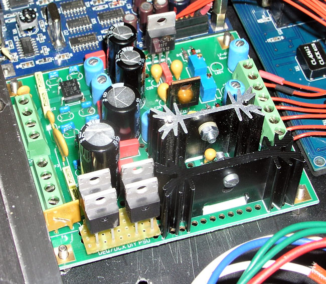

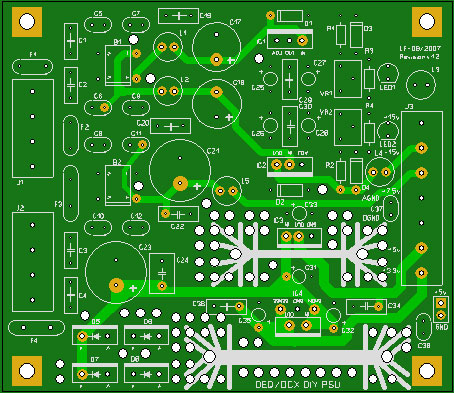

AR2 said:Any chance of moving these two regulators on the edge of the board, so than we could have an option for cooling with the heat spreader and using the case as the heat sink, or maybe just one bigger heat sink for both regs and still out of the way from the board?
Hi!
Back from my vacations. I restart the project.
For the question: I can place the regulators at the edge but space for the heat sink will be difficult to find in the box, specialy with the DCX.
I'm waiting for some new regulator samples to optimize the 3.3v circuit (some new circuits from Linear). I already modified the PCB to have a better cooling. I moved the big caps, moved the rectifier to the edge, moved the 2 heat sink as far as possible and done holes in the PCB under the heat sink.

New caps, new bridge for digital, new heatsink, better ground design and holes for vent. Option to place an 25mm PAPS at bottom of the 2 heatsinks.

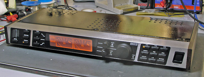

The new psu is inside. New holes at the center of the top box, and somes under the box too. I ordered 2 new prototypes. I'll will be looking for a DCX beta tester if warriors available. ;-)

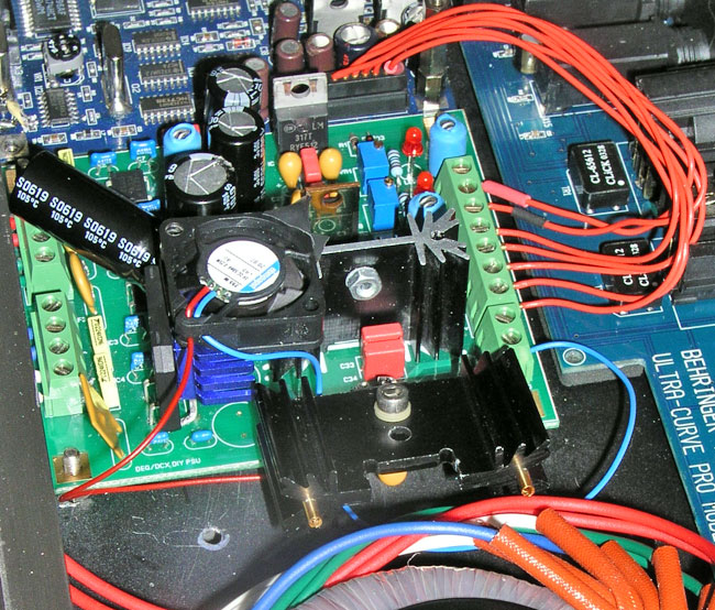

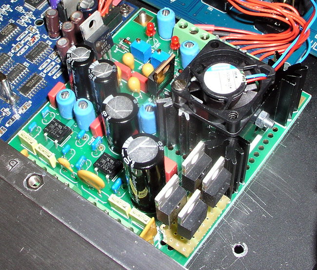

The PSU is over. The last ajustement are done. I'm now ready to order a first batch PCB and transformer. I solved the temperature problems with the last prototype PCB and new rectifier bridge for the digital parts. I also changed some capacitors values.
I've enclosed the last schematics.
The temperatures are these (with closed box and holes at the top and under the PSU):
Diodes: 35/45°C
Small heatsink: 40/45°C
Large heatsink : 55/65°C
DSP : 40/45°C
PSU capacitors: 30/35°C.
If we place a PAPS 255M 5v fan in the box at top of the heatsink, we have an internal temperature around 30/35°C maximum (room = 24°C).

Ryssen said:No decoupling for the MBR10100?
Deleted. ;-) Some person say, no need of decoupling caps with Schotty diodes, and as I dont have more space left...
The holes under the box is may be not a good idea. Hot air coming from others equipments under the DEQ will go inside. On the side will be better.
If someone want to test it with an DCX2496. I'll have 1 more PCB available in 10 days. Unfortunaly, I don't have a spare transformer but I tried today with a 2 x 15v and 2 x 6v regular transformer and this work (thanks to the new Schotty diode). This will permit a try without the custom made transformer.
