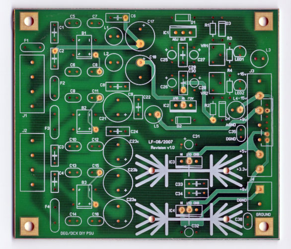

The 7805 is not a so bad regulator. You can replace the low end stock 7805 with another fixed 7805 regulator with better spec as the Fairchild, Linear or ON SEMI version (Ripple: 50dB -> 75dB, close to the LM317). If you replace the caps before and after the regulator, I will win again. But the main problem is not only the regulators but the stuff in front of...

A prototype of the PCB will be ordered end of week.
Before annoncing a group buy, I should test all the solution.
Nice,I dont know how you are going to do with the pcb and trafo in the DXC but,to remind that the On/off switch take som space,where I gave you the messaurments.A prototype of the PCB will be ordered end of week.
In the DCX, we don't have a ready to go solution as the DSP board in sticked to the PSU. The best is to move the DSP board to the other side (seems you need to change one cable). Or, put the transformer in place of the original PSU and the new psu board at other side (I don't like this one as the power cables will cross all the box). Or an heretic solution is to move all the PSU in a second box...

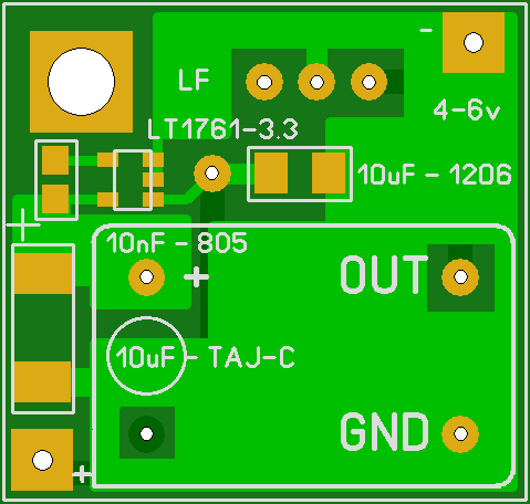

I've also designed a small clock board (to be used with a TCXO). I've used the space left on the pcb panel to print some samples. I don't know yet if this will work fine. ;-)

30EURO + vat + shipping cost for the custom made transformer. I ordered a prototype to check validity. 3/4 weeks to have it.
Dimension: 80 x 32 mm
Primary: 230v
Secondary: 2x15v 8VA, 2x7v 25VA
The PCB cost will be around 10/15€ but will really depends of the ordered quantity.

It should. The original PSU is 85x95mm. The transformer only 80mm.
The transformer will take the place of the original PSU. One hole to drill to fix it. The new PSU will go between the new transformer and the DSP board. 4 holes to drill. You cut the PSU cable and connect all these stuffs. That's all.
