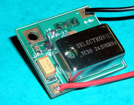

The small board is a try of a small TCXO clock board. The board will contains a 16Mhz TCXO and it's 3.3v power supply (10uVrms/-75db). Should be connected to the integrated 5v digital.

Hmm,my XO3 contains a 24,570Mhz christalThe board will contains a 16Mhz TCXO
Ryssen said:Hmm,my XO3 contains a 24,570Mhz christal.Whats the 16Mhz for?
Writing error.

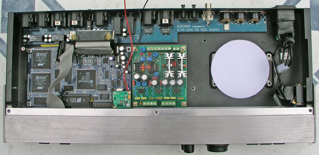

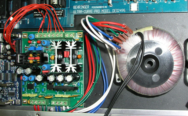

I finally received the custom made transformer just before leaving for my summer vacations this week-end.

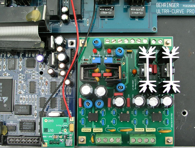

The system works but a little too hot at first. I've to modify the circuit to have something cooler. The digital rectifier bridge was too small. I replaced it with an in line 4A bridge. The 3.3v regulator is now connected after the 5v regulator. The 3.3v regulator was too hot. Heat sinks are a little too small but I have no space to use larger one's. The box will need to have vent holes.
Currents are equal to the original PSU. I'll try to optimize more when I will be back. I've started to move some components on the PSU to have a better cooling.

Doesn´t the 5v reg get even hotter then?Even if fitting bigger sink the heat have to go somewhere..(went holes..)The 3.3v regulator is now connected after the 5v regulator.
Nice trafo.

Nice trafo.
In fact, I went back to the original right now. The 3.3v still produce heat unless placed after the 5v. I also replaced the bridge with 4 Schottky. I removed the LM3xx heat sink. No need. Later, my plan is to try with an LM3940 for 3.3v, remove the 3.3v heat sink and move the caps too close from the sink (big error from me on this).

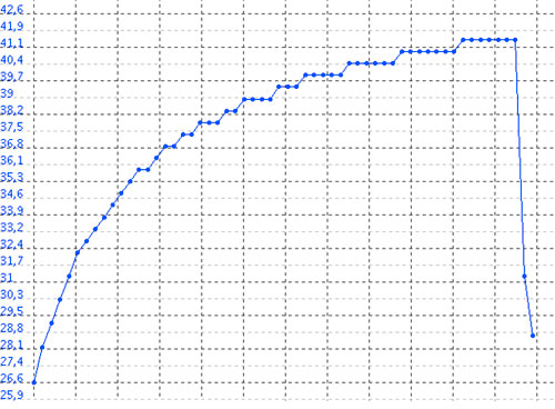

After 1 hour, box closed: 65°C for dissipators. 41°C inside the box. Not too bad. My DEQ have some small holes at the top rear. The transformer seems ok. This is a good. Very good quality.
Any chance of moving these two regulators on the edge of the board, so than we could have an option for cooling with the heat spreader and using the case as the heat sink, or maybe just one bigger heat sink for both regs and still out of the way from the board?
