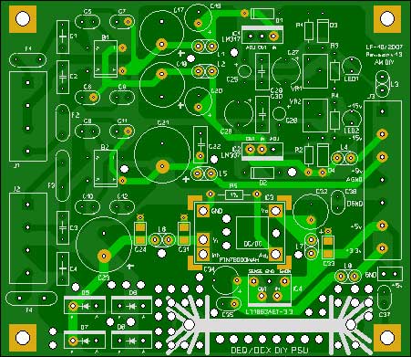

I've sent the board files to the factory today. I cross my finger to do not discover a late error...
I changed some placement to fit bigger caps (C27, C28 and C34) and added a PI filter in the 15v circuit. Added a ferrite at the 3.3v output (HF was coming from the DSP board).
I changed C27 and C28 for Black Gate PK 47uF on the proto. Don't smile but it seems that I've a little more bass (or less medium). But no change on the scope. ;-)

It should but nothing is definitive in real life. 😉
Dedicated transformer (230v only) = 40€
PCB (double side, gold plated, thick) = 12€
+ shipment cost (may be a small box or an thick envelop, I don't know yet).
Count around 50/60€ of components if you have to buy all the stuff (the DC/DC module is the most expensive part, around 15€). I do not offer a complete kit. I'm not organised for that. But may be a GB can be organised by someone for the most difficult parts to source (DC/DC module, heatsink, SMD caps, connectors, etc.).

LT1963AET-3.3

Re: LT1963AET-3.3
Yes, I discovered that the TO-220 is no longer available at Farnell. They only carry the soic version.
Can be ordered at Linear site (or you can try sample too).
http://www.linear.com/purchase/

The last PCB prototype is OK. The size is 8 x 9 cm.
I'll order tomorrow morning the first batch of PCB. The toroid are already in order. I also ordered a small batch of miniCLOCK.
Ryssen said:The small PCB for IC3,is it included?
This not a PCB. This is the DC/DC convertor, the PTN78000.
