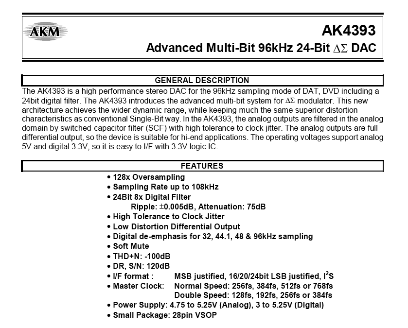

I will post pictures later today when I get to my work space to make one. I had dead AK4393 DAC and I was able to get few AK4396 samples. I have exchanged that one and left others for now, but also so I could do some AB test listening. I didn't have a chance to do much listening but what was coming as immediate and clear improvement was in the highs. They are cleaner and more defined but not edgy, just clean and relaxed. I am planning to exchange them all in the main DCX and to do some more listening.
AR2
stef1777 said:
And they was not aware that AK4395 works only with digital 5v... and the DCX play 3.3v...
Hello Stephane, I am not aware of that information. Could you please elaborate more on that. Here is the insert from the spec sheet for 4393:
