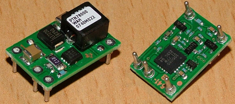

Hey Guys!
I've a technical question. yes ;-)
Do you know if the soldermask resin used on PCB is a problem with cooling?
I'm ordering a new batch of miniVreg PCB and the price is more expensive if I remove the soldermask on the botton side (for cooling, to have a good contact with the heatsink, I removed it). They use more gold.
Stef...
The bottom side is on the right.
Soldermask or not?
My solder are very bad. Beurk!!!
Stef...
Soldermask or not?
GeWa said:I applied for a free sample of the PTN78000WAH DC/DC converter and the people from TI where so kind to send me one 🙂

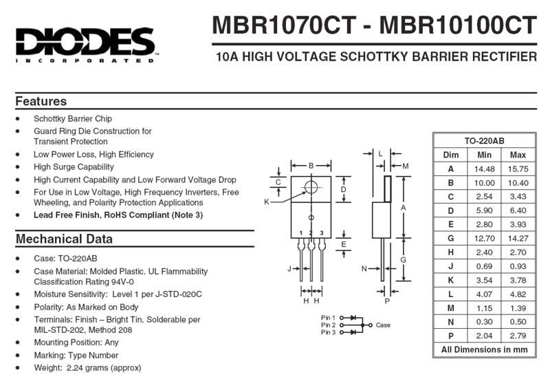

Hi there,
My local shop provided me with 3 leg MBR10100 diodes whereas the DIY PSU board can only accept 2 legs. You expect the silly question, so can I cut the central one?
kepa1 said:Hi there,
Salut Alain,
According to the Vishay or ON datasheets, the MBR10100 only exist with 2 legs !!!
3 legs diodes generaly contains 2 diodes connected backward.
Stef...
I'm afraid I can't source MBR10100G, can I use MBR745 instead? They are rated 7,5A/45V.
