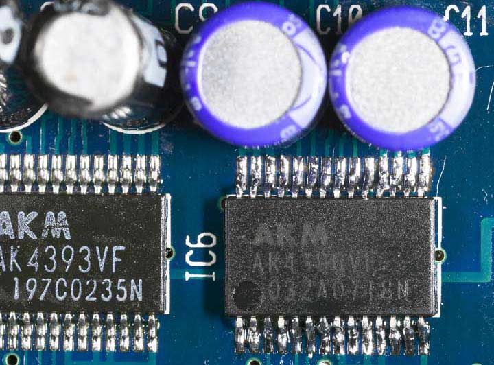

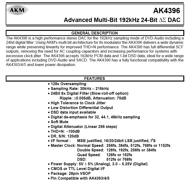

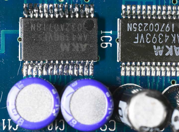

They are both in power supply 5V for Analog and 3.0-5.25 V for digital. It only seems that 4396 is more sensitive to analog voltage - 5V +- 5% where AK 4393 is more relaxed with 4.75 - 5.25 V
Other than that 4396 is pin compatible with AK4393/4/5 so it was meant as straight replacement in my mind. Let me know what you think.

AR2 said:
Hello Stephane, I am not aware of that information. Could you please elaborate more on that. Here is the insert from the spec sheet for 4393:
In fact, the nice table to look is this one. Look at DVDD specs. If you want to install an AK4395 inside a DEQ/DCX, you will need to power it with 5v instead of 3.3v. AK4396 is more "plug-and-play" in this case.
And play with pins 9, 26, 27 and 28 can be very interesting.
Great Wlad. ;-)
I forgot. I tested tonight the regulator in place of the LM7805. It lowered ground floor noise on the speaker.
Thank you Stephane,
Good, I just realized that you were talking about AK 4395 and I had on my mind AK4396. Cool. Great info!
AR2
AR2
