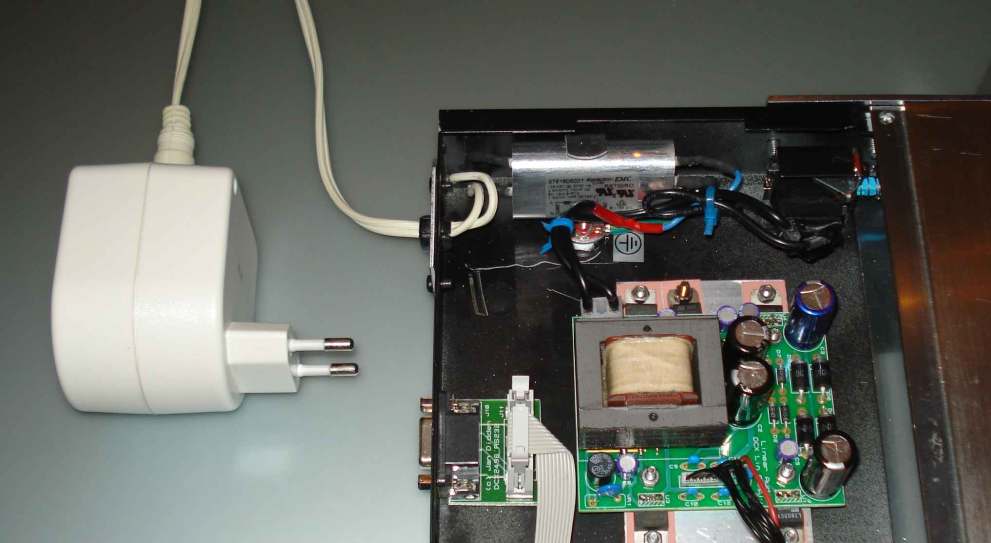

Can´t remember where I found it.The 5v and the 3.3v are switched on the powersupply connector.I found out when starting with the new PSU,no dispaly.A little detective work and it started again. :xeye:
will listen to it someday and se how much heat the new PSU produces.
Well,it´s working now..
The LM317/337 is producing the most heat,I messaured the current draw to 70mA,thats 0,245w and still so hot,hmmm..
I read the latest AudioXpress about shunt regulators..but thats later when all modds are done...
I tried to put the top on,and it do get hot after a while,so I will have to do a went hole,how did you yours so sqare?Jigsaw?
After soldering the cables to the 7 pole dc plugg,I thought it would have been better to buy it with the leads already there,It´s SMAAL..
Lets hope it keeps together.
And it was a another improvement to the sound,a little airier soundstage,but not as DEQ...😉
The sound is still a little "hard",the next modd will be the regulators and the elyts around it.🙂

[The LM317/337 is producing the most heat,I messaured the current draw to 70mA,thats 0,245w and still so hot,hmmm..
Hi Ryssen!
Nice setup. For 70mA (+ the leds) and around 20v at input, temp should be around 35°C, but LM3xx are definitely not efficient. What are the uF for the output caps ? Excessive heat is may be due to high ripple or "accumulated heat" around the heatsink. Sometime, it's better without heatsink.
Add a large ferrite around the power wires (the red cables after the PSU). This will minor ground noise of few db.
They are 330uF standard,have used them in some other construktions with LM317/337.
I did try without heatsinks om LM317/337 fisrt,I put my finger on them and I had no problem holding it there,so I will remove the sinks and try..

the quantity of heat given out by the regulators will not change whether there is a sink fitted or not. The internal temperature of the case will not change if there are sinks fitted or not.
The temperature of the regulators will change with/without a sink fitted. The cooler the regulator the further away from the protection cutting in.
I suggest you keep the extra sinks to enable the regs to run cooler.
The efficiency of the 3xx regs is irrelevant until the mains voltage drops Vin to near drop out.
The 245mW quoted by Ryssen indicates that about 3.5V are being dropped across the regulator. Using any type of LDO regulator cannot change this. It will still be 245mW due the difference between Vin and Vout.
A second line of attack could be to convert the 3xx to CCS mode passing say 80mA. Then design the shunt reg to draw the excess 10mA. This would allow the active stages to draw upto 79mA. Would that cover worst case current draw in the circuits?
In fact, Ryssen said in a post later that the regs are hot but it can put its fingers on it. This means that their temp is around 30/40°C (or Ryssen is a strong man 😉 ). This temp is normal in this design and not a problem. I understood it first report as very hot (something as 65°C).
Heat sink is important but air cooling is also very important. If the heat sink are too close to components and that air can't move around. This "not moving" air will generate more heat.

Ryssen: it will be better to move the large 4700uF green cap to the other side (on the left). Put it just on top of the DC/DC convertor is no the best.
Yes,I am strong..but..😉 I removed the heatsinks and without the top it´s okay,but with it on,after a while it gets to hot,so I will do some went holes.
I messaured the input voltage to the reggs and its 19,2-3v so the power is actualy 0,294w..The 70mA current draw is with the selectronic
outputboard,it might be more with the original outboard (meny opamps..)Well I´m not a good constructor (yet)but i like the idea with shunt reg.(reading what people think of the sound,nothing in between
the PSU and the load.)
I will re angle the 4700uf.
I did compare DEQ and DCX yesterday,the DCX has more forward voices and middletones,a little harder sound,DEQ is softer,Whats best?
