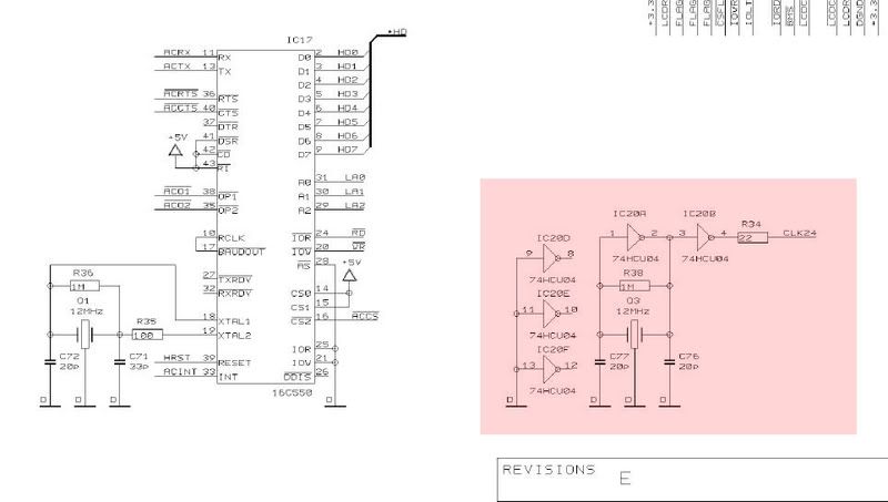

Since there is no detailed info about DCX2496 on his site I have a question for people who already did this upgrade (or to Stef if he knows)...
What oscillator I have to change? This one?

Moby said:What oscillator I have to change? This one?
Also, from where I have to "steal" +5V for miniclock board?
Have a look on this page: http://www.dcx2496.fr/selectro3.php
The cristal to change is Q3 (marked 24576 Mhz). But personnaly, I'll not use the way explained on the dcx2496.fr web page. Use the same way I explained on my web page. Remove the Q3 cristal, remove the two 20pF capacitors, connect the clock ouput to the cristal pcb hole going to pin 1 of IC20, and take 5v on the power pin of IC20 (74HCU04).

Thanks Stef. I was confused because Q3 on shematics I own is marked 12mhz I highlighted the part of and I'm really curious is that some mistake or what. BTW, I like your way, without cable...No problem with soldering . Also, what is Q1 also marked as 12mhz used for ?
