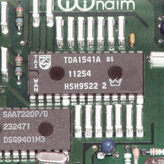

Eric - here is a typical Naim implementation:
- It's not clear in my pic, but the caps return to a ground plane tied to the dac's own 0v plane.
Also note how Naim has cut slot's into the groundplane to ensure the elctrons behave themselves and only go where they are supposed to.

Decoupling TDA1541A S1 by NAIM AUDIO
Thanks Martin, thanks ThorstenL for those details.
I push contrast on the picture to see details.

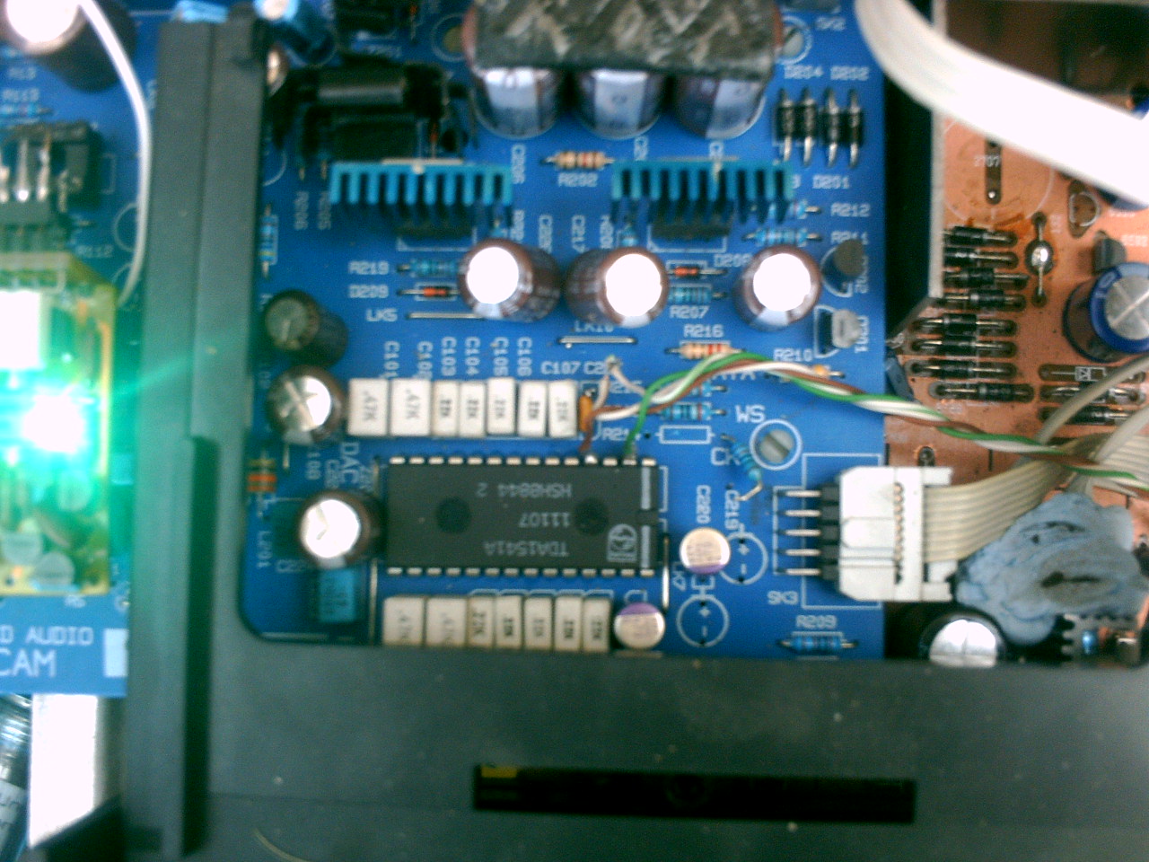

On DEM topic, I lifted the BCK resistor on the dac board to feed in 11.2 and 5.6 to pins 2 and 4 straight from the new clock.
Clock will also let me have 2.8 that I can send to 16 for DEM - useful.

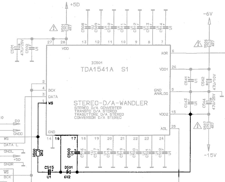

You can see it in the pic attached - ( this was before the caps changes I made ) but you can see pins 2 and 4 with clock feeds and the CK resistor lifted.
Pic 2 - is this another DEM option using WS.
Can I feed 2.8 mhz to pin 16 this way then remove the 470pf styrene cap that connects 16 to 17 and then gnd 17 ?
It's so confusing - well for me anyway - maybe all the experts out there find this sort of stuff easy but tbh I'm scared to wreck all the reasonable work I've done so far.
