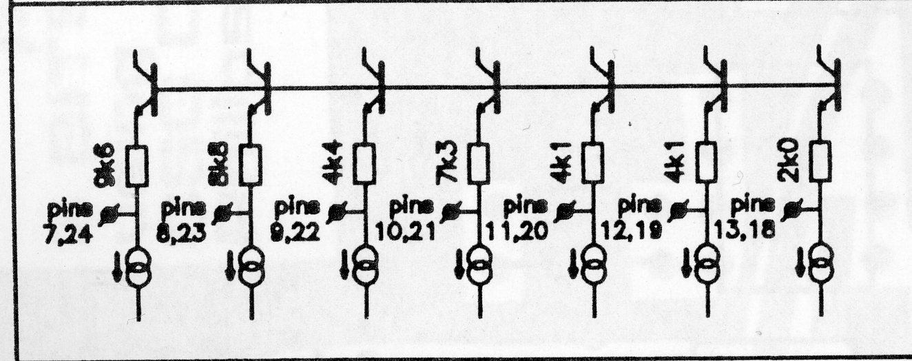

Pic 2 - is this another DEM option using WS.
Can I feed 2.8 mhz to pin 16 this way then remove the 470pf styrene cap that connects 16 to 17 and then gnd 17 ?
I guess you can. Where does this come from, out of interest?
I would say WS is probably too slow for DEM reclock. HpT recommends 4 * Fs at 4 * Oversampling IIRC, so 705.6KHz. In this case make sure that the decoupling capacitors have a minimum impedance at at least four times that frequency.
Doing this means that all DEM Elements will be used for a single sample.
This removes the error randomisation from running the two clocks without link, but at the same time removes the inevitable random errors that produces. It then minimises the systematic errors caused by variations in the DAC's "build in" errors, which is after all the main point of DEM.
Ciao T

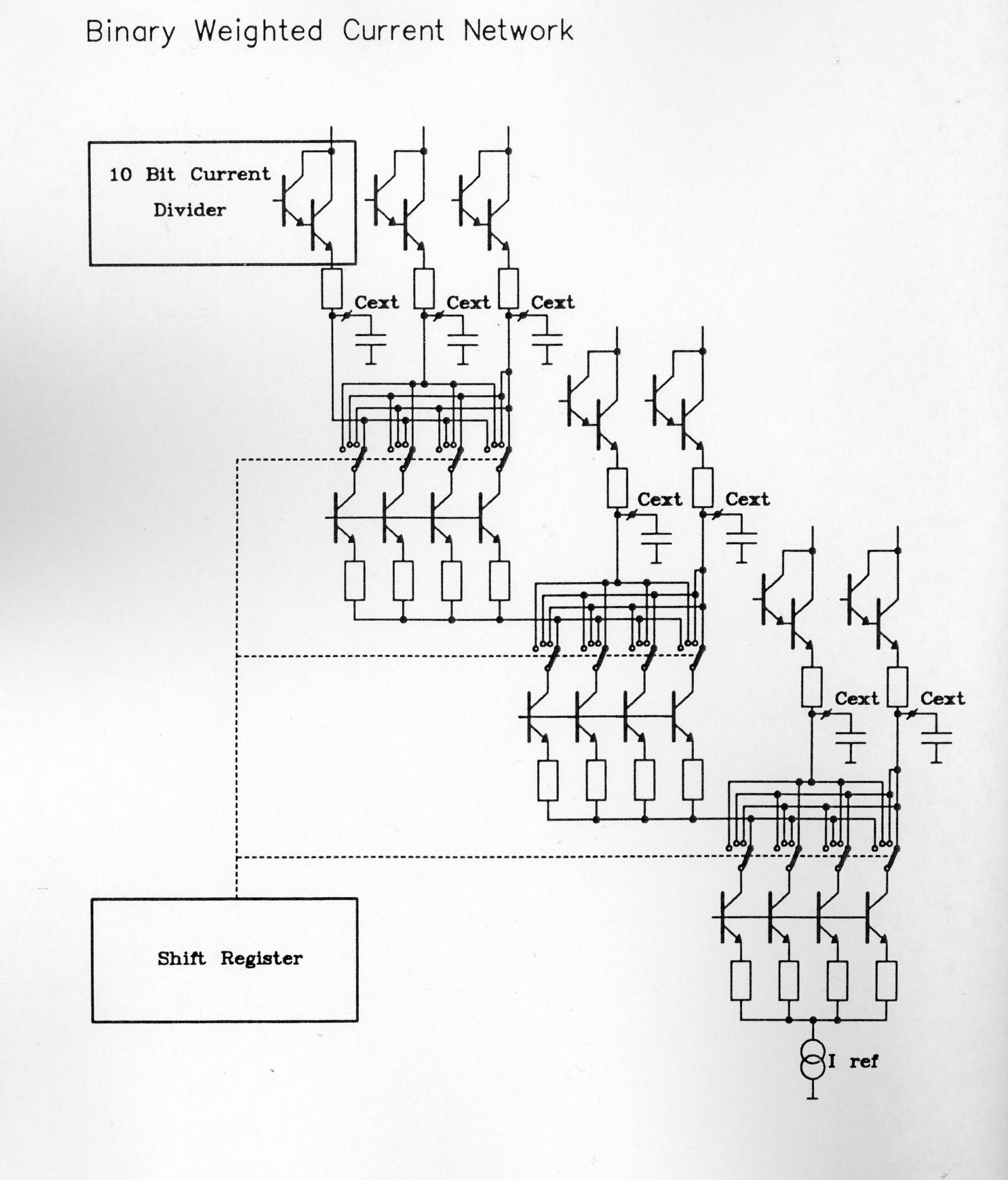

Looking at the internal structure of the TDA1541A, the MSB's Filter caps can tolerate all sorts of levels of leakage (as long at it applies to both pins per channel) as it is the "master" for the whole divider chain...
Ciao T
Really?
